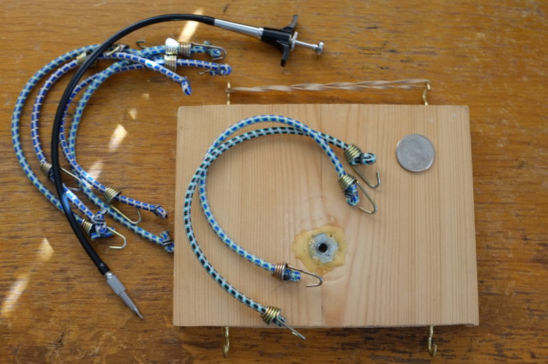

I'll be back in a minute. I want to take a picture of something that is very useful for putting all kinds of homemade cameras on a tripod ( it is not my idea... I learned it from Joe VanCleave. )

This is a piece of scrap pine wood with a tripod socket and 4 cupholder hooks screwed in. The small bungee cords can be used to put almost any camera on this "platform". A small camera might only need 2 bungee cords to hold the camera in place, and my bigger cameras use 6 bungee cords end-to-end.
attachment.php
If the camera is big and light enough, wind is still a problem, but this works great and it is small and easy to carry.

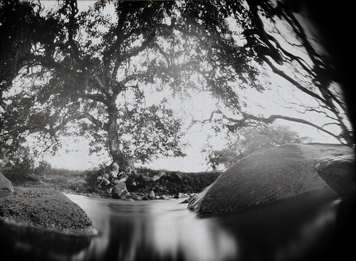

Here it is being used with a flimsy mat board pinhole camera:

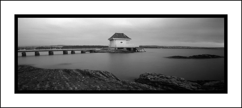

I have the Vermeer, and quite like it. Build is more than good, and nice enough. And the results are very good. You can specify other size pinholes if you prefer, the standard on the 6x17 is 0.300mm. Focal length is 90mm. Curved plane pinholes do not vignette as much as flat plane pinhole cameras, as the whole frame is equidistant to the pinhole.
An example:
Bath house #14 by Eirik0304, on Flickr
