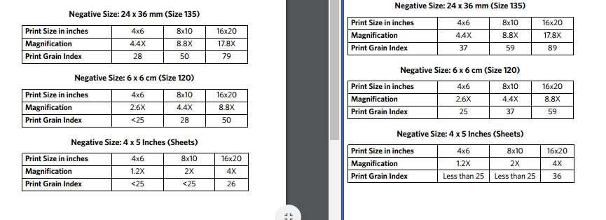

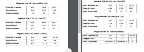

First difference is enlarging capability while conserving "acceptable" graininess... no doubt that the 160 allows quite larger prints

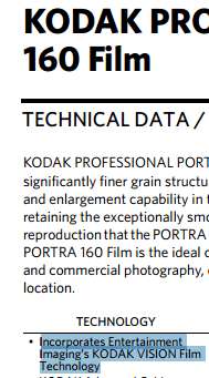

Technology wise, probably all Portra and Vision films shared advances in the color film technology. IMO mentioning Vision 3 in the datasheet is basicly a commercial resource. Vision 3 has an impressive prestige from the Hollywood results, results come from impressive budgets and from impressive technicians an cinematographers that make the medium shine, every proficient photographer gets amazed by Hollywood's photography.
In the 160 datasheet they also mention Vision 3, not only in the 400 one:

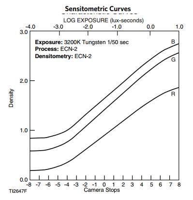

This is the 500t curve. Note that Speeed point (D = F+B+0.1) is at near -5 stops, while in pictorial film you have rated speed point at -3,3
The same effective speed is rated EI lower in cinematography, for this reason Cinestill's people do sell the Vision 500T as Cinestill 800T with no change in the sensitometry (They only remove the Remjet layer to make regular development, isn't it? )
For this reason V500T has quite more grain than P400 as it is a well faster film, V500T is even faster than P800, or at least as fast than it.

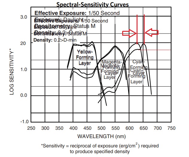

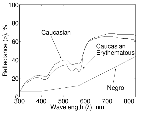

Robert, of course I agree they are very close, but let me tell the nuances I find. IMO there is some difference in the red channel spectral response, while P400 peaks at 650nm the P160 version peaks at 625nm. My interpretation is that P160 provides an slightly different color separation for caucasian skin, around 600nm it happens two important things for the depicted the skin texture,
we have an step in the reflectiveness:
And hemoglobin (capillary blood) decreases its absortion:
Datasheets show that P400 is more sensitive to deeper reds and P160 to less deep reds, sensitivity in this graph is Log scale, so impact may not be totally evident in the graph:
Of course we can correct many things in post, but I find the particular color separation P160 makes is benefical to depict some subjects that show pinky hues in the flesh. Well, for sure also this is a matter of taste, but personally I never found 400 as great than 160 for certain subjects, specially when illumination is the good one, while I can easily match the average skin color P160 vs P400 I find quite more easy to get a nice skin texture with P160, specially when the shot was made close enough to make the skin texture important, let me repeat that this is about personal taste, and talking about nuances.
