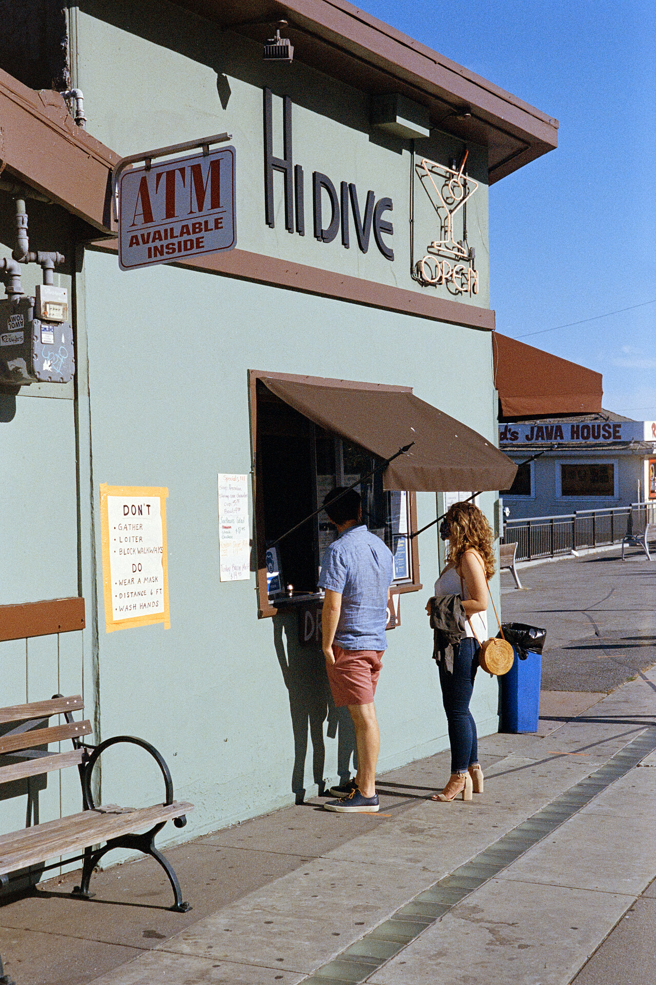

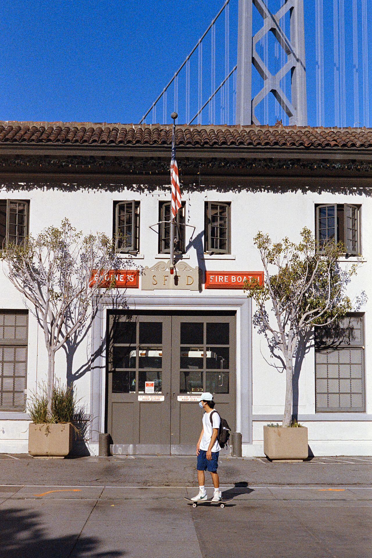

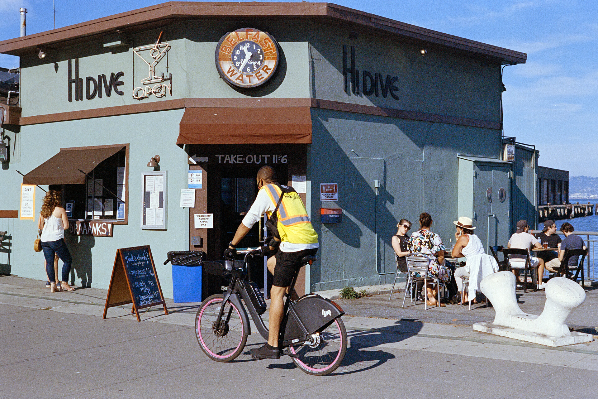

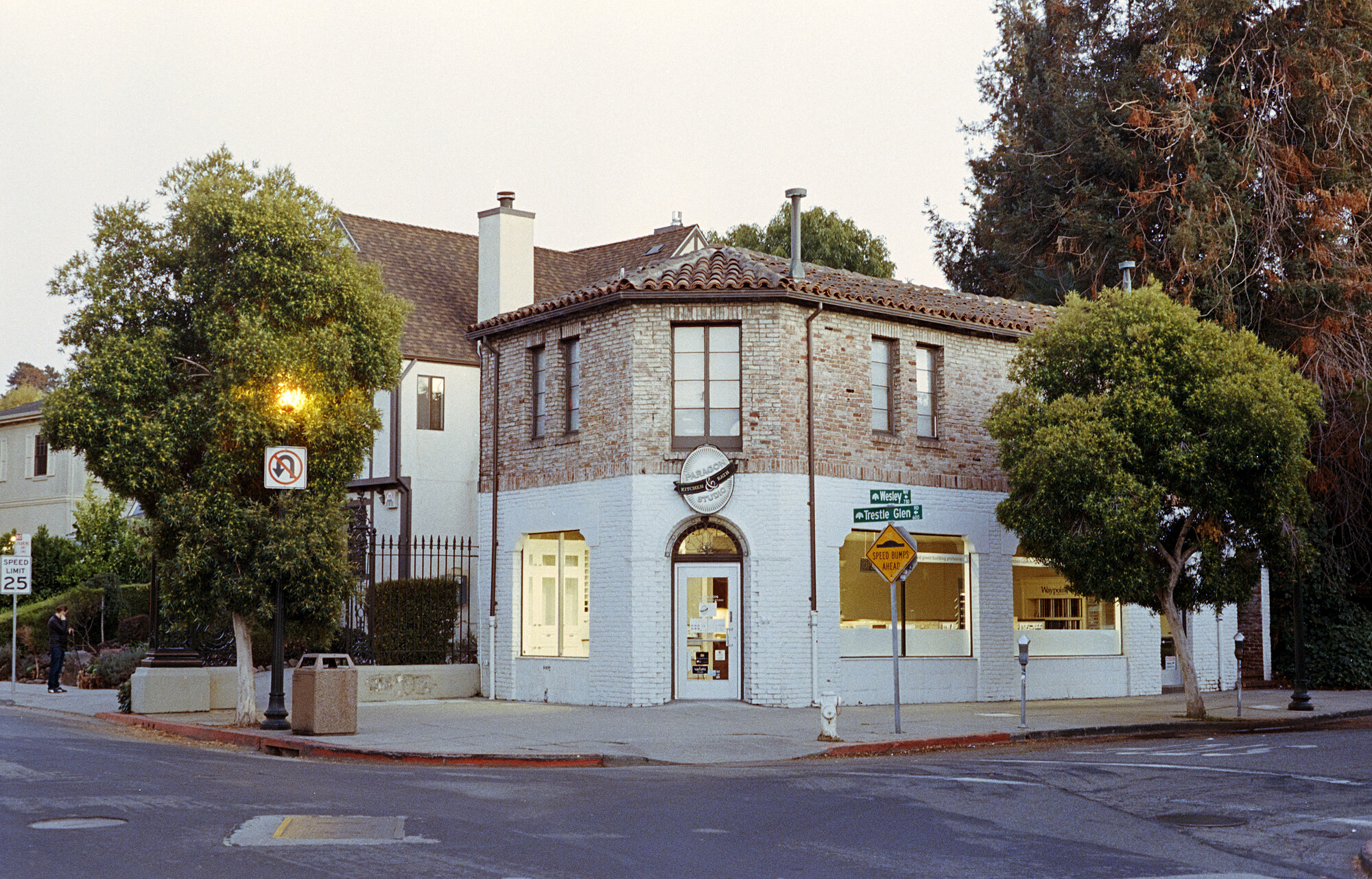

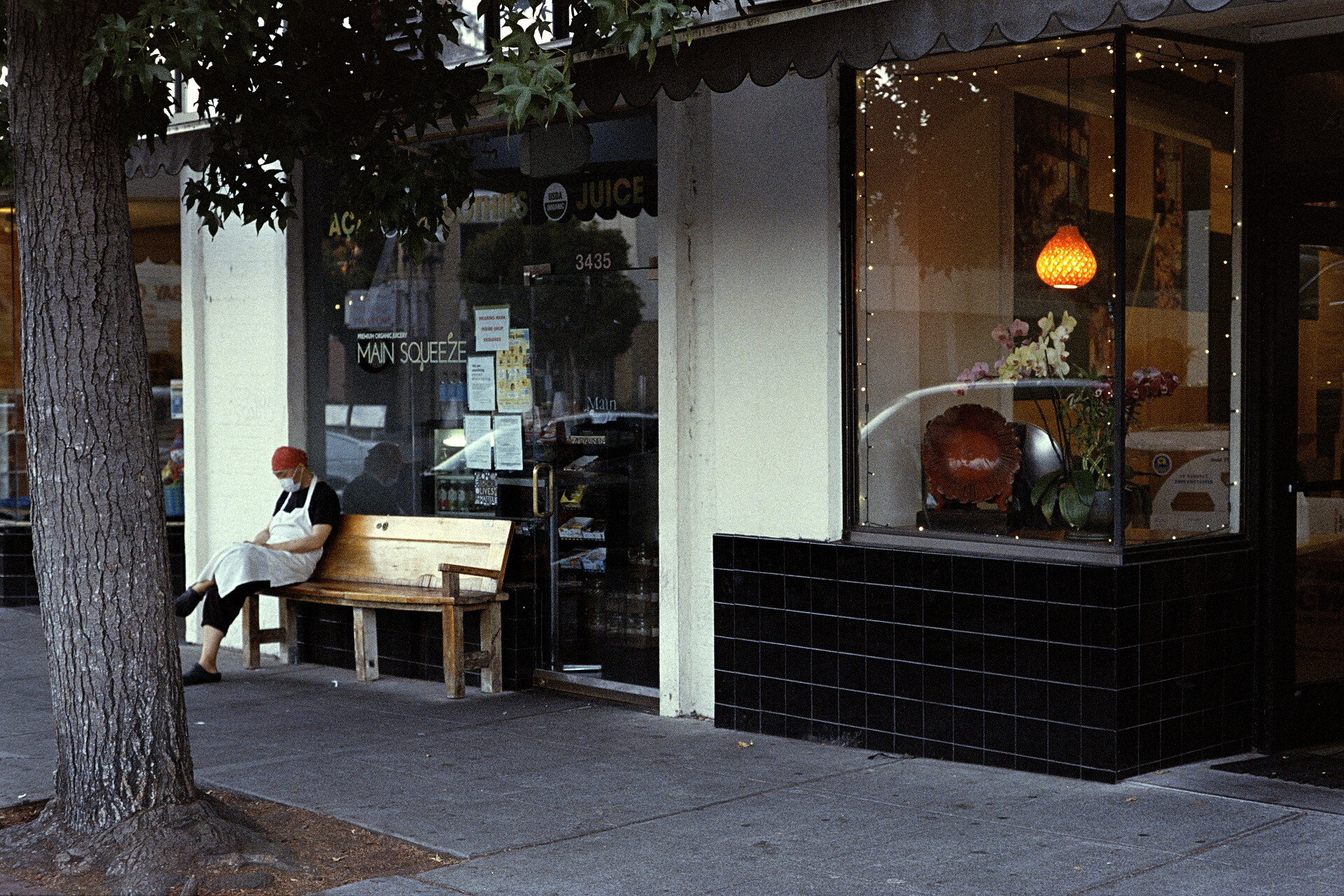

I couldn't wait for the new scanner to arrive, so I have re-assembled my camera-scanning rig today and ran the first 5-shot strip. Here're some samples (Portra 800)
These two were during sunset:
Inside, cloudy outside:
Sunny:
Do these look like Portra 800 to you? I have never developed this film at a lab before, it was my first time using it.

Thank you and yes, I am pleasantly surprised. This is, however, just one of the three rolls. I can't wait to scan my MF Portra 160 rolls.
crap-photo-jpg.252673
With respect to the above image, a couple of quick adjustments in FastStone yields this for me.
To my mind that looks much more like "near sunset" lighting - at least on my monitor.
Do you have any photos using the film where we can evaluate skin tones?
