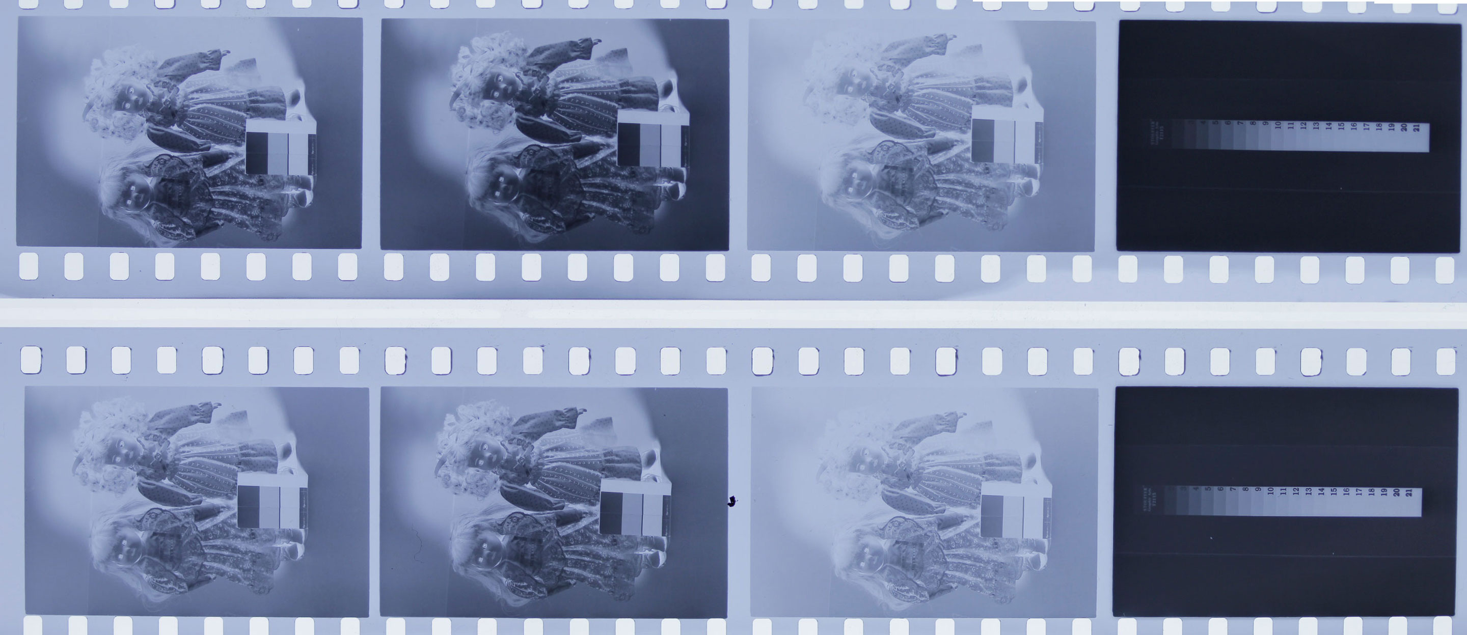

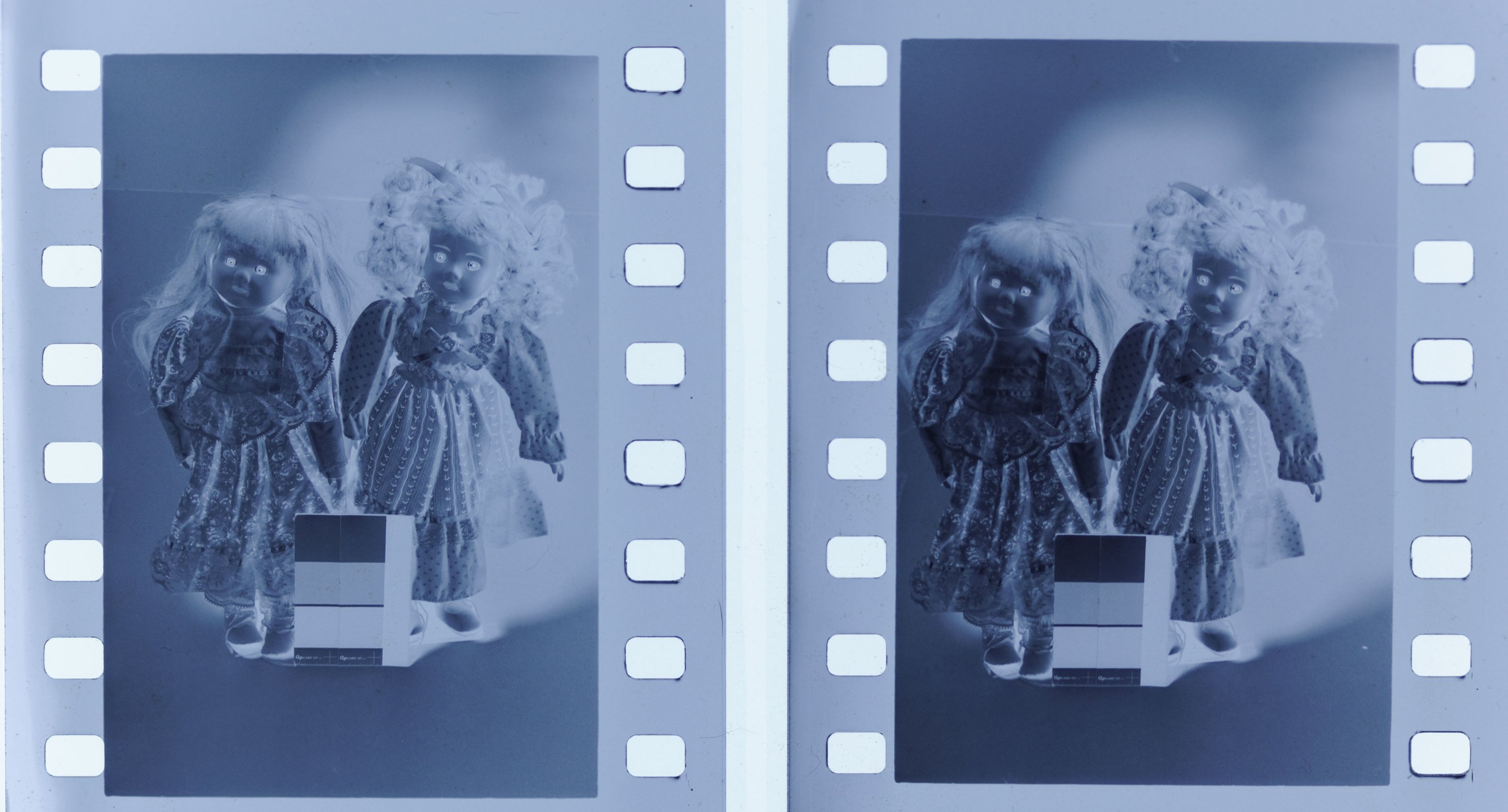

I am glad that my questions generated such an informative thread, so here is something in lieu of an accurate comparison, plus and minus glycin.
Half a liter of the developer mentioned in the original post was prepared omitting glycin. It was left overnight in a 500-ml beer bottle with a latched cap, and next day split into two portions of 250 ml. One was supplemented with glycin, introduced as a 5% solution in 5% sodium sulfite. A clip featuring the same subject with bracketed exposure was produced, including also a Stouffer wedge shot on a lightbox with two stops overexposure. Both clips were developed for 6.5 minutes at 20 C, agitation 5 seconds every minute, followed by citro stop and Ilford Rapid fixer, eco wash and Photo Flo rinse. The results are on attached images and I think the effect of glycin addition is fairly obvious. As you can see, despite as accurate as possible reproduction of conditions, the images, although not materially different, are slightly weaker with glycin addition. As much as can be seen in my imperfect reproduction, glycin does not produce substantially smaller grain, but makes it sharper. The change in density cannot be explained, IMO, by the fact that glycin is an acid, and its addition shifts the developer pH from 10.4 to 10.3 in this batch. And finally, no trace of dichroic fog, although I think that fogged leader in the case of glycin addition displays what may pass for sheen, but I do not know how to reproduce it.
One thing which is striking is shadow detail: it looks like it's the same, despite the vastly different contrast.
