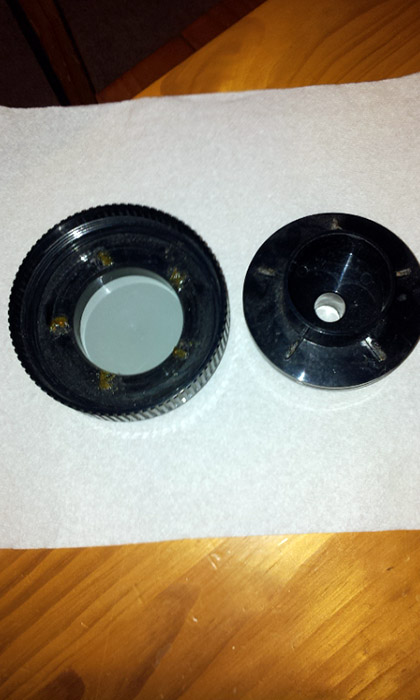

I think the situation that the OP is dealing with is where the tank lid has come apart as in the attached photo. In my case the earlier owner has attempted to glue the parts together but hasn't used epoxy. I don't know what adhesive was used except that it is brown and quite flakey. Not like epoxy at all. If I attempt to fix this I will clean off most of the glue from the earlier repair and use Araldite, (common local epoxy adhesive).
It's not a huge issue for me as I have 4 good tanks and 3 good lids which I can swap around.
Upon looking closely at the separated lid parts I think you could use them even while separated as the outer part provides the liquid seal against the grey flexible plastic sealing ring. The inner part of the lid provides the light proof seal when it is inserted into the centre column that the film reels slide onto.

tokan, that's what 2 pack epoxy looks like when used with a Paterson tank, it separates with time. It all needs removing.

Thanks Ian. Do you think that the brown glue is the original ex Patterson? This is the first separated lid I have encountered. I would have thought that the original glue would be of the solvent variety ala Airfix glue for styrene models.
One issue with superglue is that it is not the best for gap filling unless I source some of the thicker superglues used by aeroplane modellers.
As the glue joints are all underneath the light proof baffle when it is fixed to the lid it will not be practical to apply glue and then reposition before application of more glue. It's a one-shot process. Get it right first time. There are five points that the baffle is glued to the lid. Will have to try and establish the best orientation of the baffle to the lid as it was originally assembled. At this point I would then used epoxy or thick superglue to do the joining blind according to the 'best' fit of baffle to lid.
