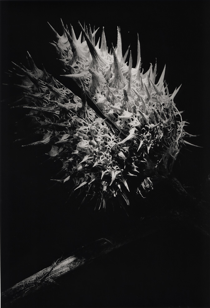

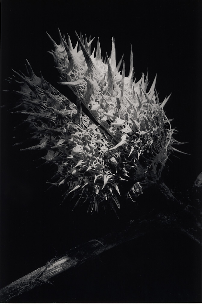

I think the general issues and suggestions of the reasons of the differences are quite clear by now, but I have decided to put some reference material here. I have now managed to dig up two prints and scanned them. See below.
PLEASE NOTE: It is always difficult to properly scan these images. The images do not do fully justice to the original prints and the differences are more difficult to see than on the original prints. Also, the RC print may seem to be a bit over-contrasty in the scan, but it isn't in reality
The top one is the FB print. Notice how the image somehow seems to be divided into three distinct regions: a black shadow region, a midtone region and a highlight region. Within each of these regions though, the contrast is somehow slightly compressed, and the transition from one region to the other looks unnatural and abrupt.
Now compare that to the RC print. Notice how the different shadow, midtone and highlight region are less pronounced and not separated as abruptly. Also notice that for example the shadow region on the left of the prickly structure has a much more pronounced and beautiful tonal range, not looking as flat as in the FB print. The same holds for the midtone and highlight regions.
Overall, the RC seems to have less tonal compression in each region. The RC print just looks more "voluminous" too. The prickly fruit structure just looks more 3 dimensional.
Please note that I have done my utter best to get as best an FB print as I could. None of the options I tried was sufficient (see original post). Ironically, the RC prints printed with great ease, after selecting the proper (soft) grade.
FB print:
RC print:

The easy answer is the contrast of the two papers is different. Even a slight difference is going to be far more apparent on an image like this.
As to why there should be a difference could be down to a number of factors. Manufacturing tolerances, ageing, storage. The top image shows far better tonality, and subtle detail, if you don't want that you'd just need to print half a grade harder to match the RC print.

Ian, the scans do not do proper justice to the prints... :sad:
This is also the reason why I was hesitant to post them here, because it was likely to obscure the discussion, as I am pretty sure they are doing now. Really, I know how the FB print COULD look if it had been based on a standard grade 2 negative, and the FB print quality is just not there.
Yes, the FB prints shows a softer image with less contrast in these scans, that may look more appealing on screen, but if looking at the real prints, you would notice that the shadow regions look flat, and the highlights also look flat and somewhat blown out compared to the RC print.
It's not just a matter of printing the FB print a half grade harder or darker to get to the RC look. That's my point: If I do that, either the shadow regions go almost completely black or I loose significant detail in the highlights or midtone region. I just couldn't get the overall contrast to match the RC print whatever I did.

Another point: I am pretty sure I would have no issue matching the RC print to the FB print by lowering contrast a bit and printing it slightly less dark, but the other way around, NOPE.
By the way, of all the FB prints I made that day, this was after much struggle the one I liked best. And yes, it's not really bad print or so, but if looking at the real prints side-by-side, I still think the RC print wins out, especially in midtone / highlight detail and contrast, and overall 3 dimensionality.
