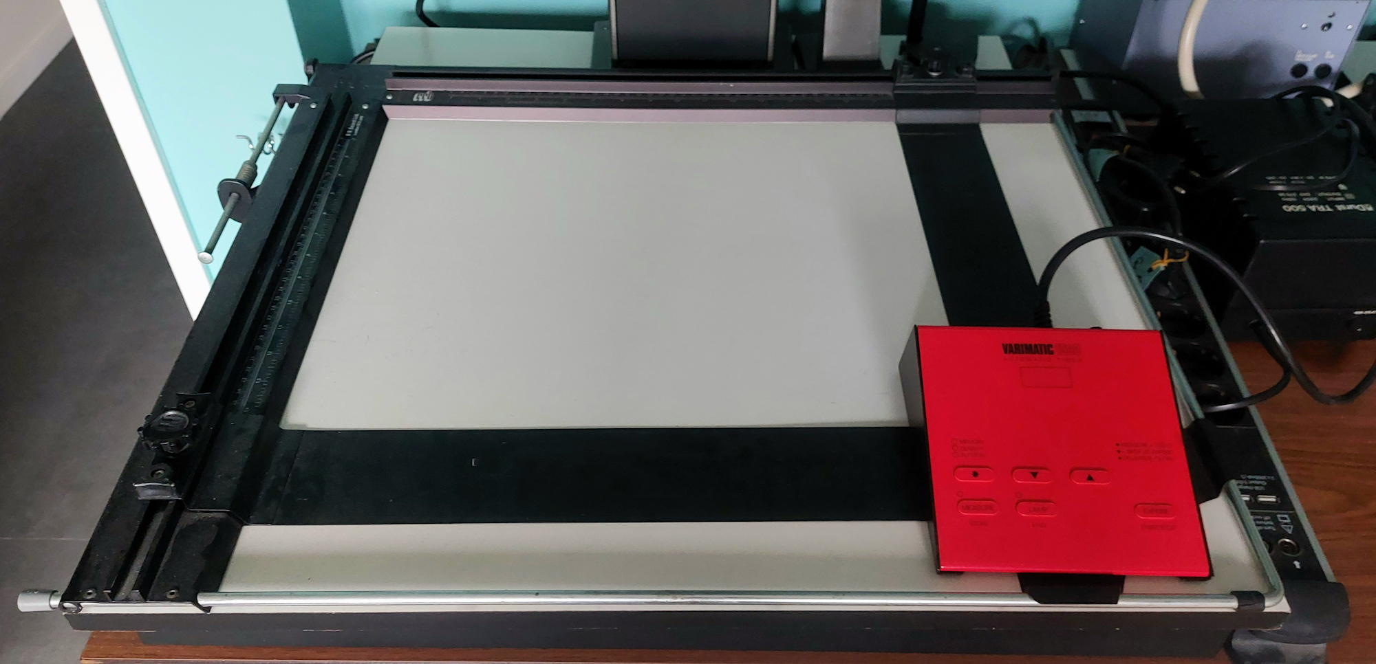

My PELLING + CROSS of London, which is absolutely identical to my RRB easels, has external dimensions of approx. 70x80cm.
A pic.

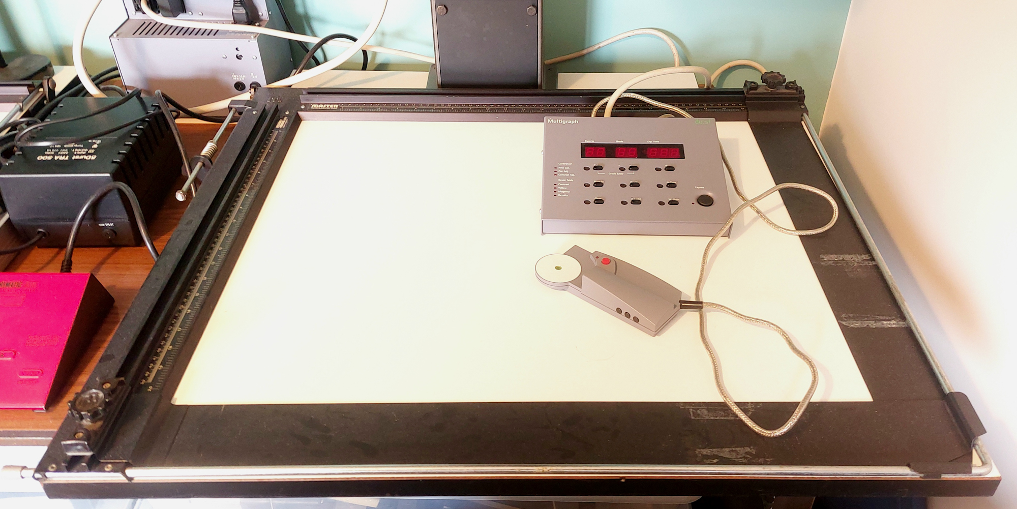

My RRB has external dimensions of approximately 60x70cm.
