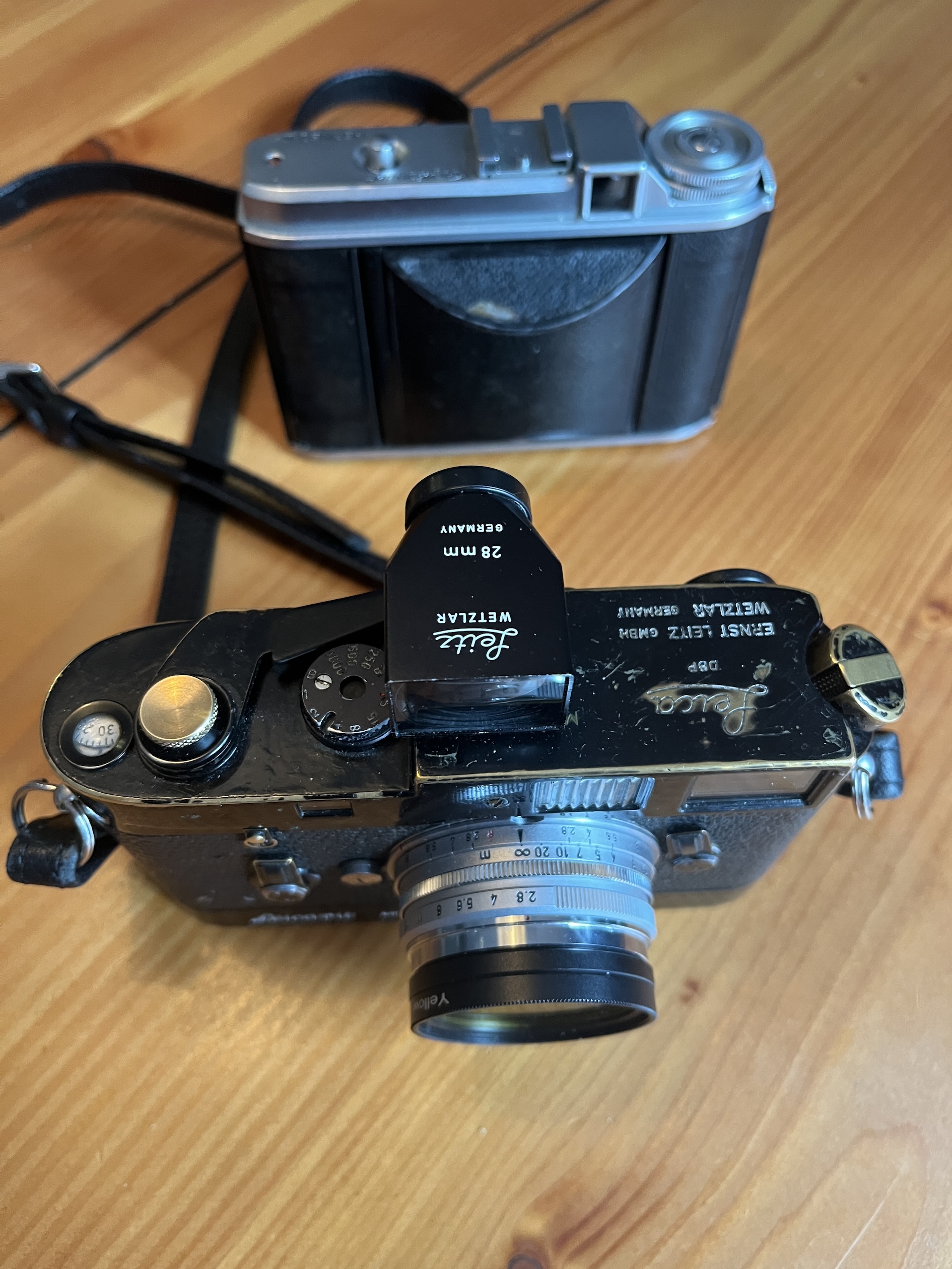

My travel light 6x6 Perkeo ll w Color Skopar
For me, when I want to travel light, I use my Bronica ETRS.
If I want to travel light I'll take one of my folders -- Daiichi Zenobia, Super Ikonta B, Mamiya Six, Voigtlander Rollfilmkamera, or Moskva 5. All lighter than any quality TLR or SLR for 120 film...
Oh yeah, the Moskva 5 is light and a good performer. Use the ETR when I want a wide/tele option though, but for general landscape on 6x9, Moskva is hard to beat.
Actually, my Rollfilmkamera is at least as good as the Moskva 5 for landscapes -- scale focus is no disadvantage and the 1927 Skopar is every bit as good as the 1959 Industar (Tessar copy), except uncoated (not always a disadvantage). And the Rollfilmkamera is somewhat thinner when folded and not much more than half the weight of the Moskva 5.
