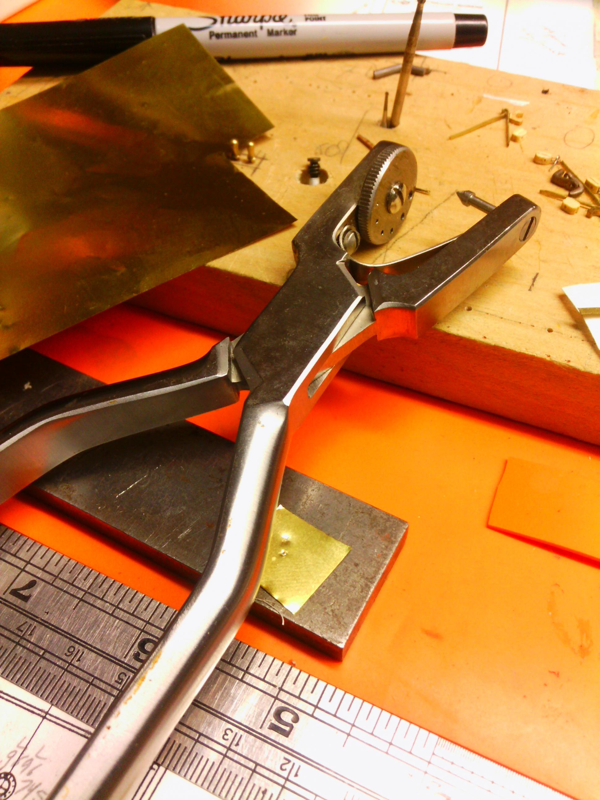

dentistry... rubber dam punch
look what ive got? i use this to make simulated rivits on my model ships. the point is removable so i can sharpen it. the anvil rotates so I'll have a blank to press my tip into which should leave a clean conical hole.
giving it a go right now....

ned i got ya. im having a blast n so friggin addicted at this point.
i see how easy it is to go on the quest for the perfect hole. i think ive got one right now. i used the punch in the photo above. sharpened the tip, punched on a blank spot on the anvil. ITS A PERFECT ROUND HOLE!!!
i mounted it to my cap. from what i can see, its a sharp image. ill see better outside in the morning. im going to shoot a roll n see exactly what ive got.

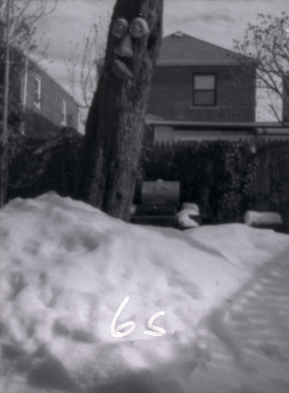

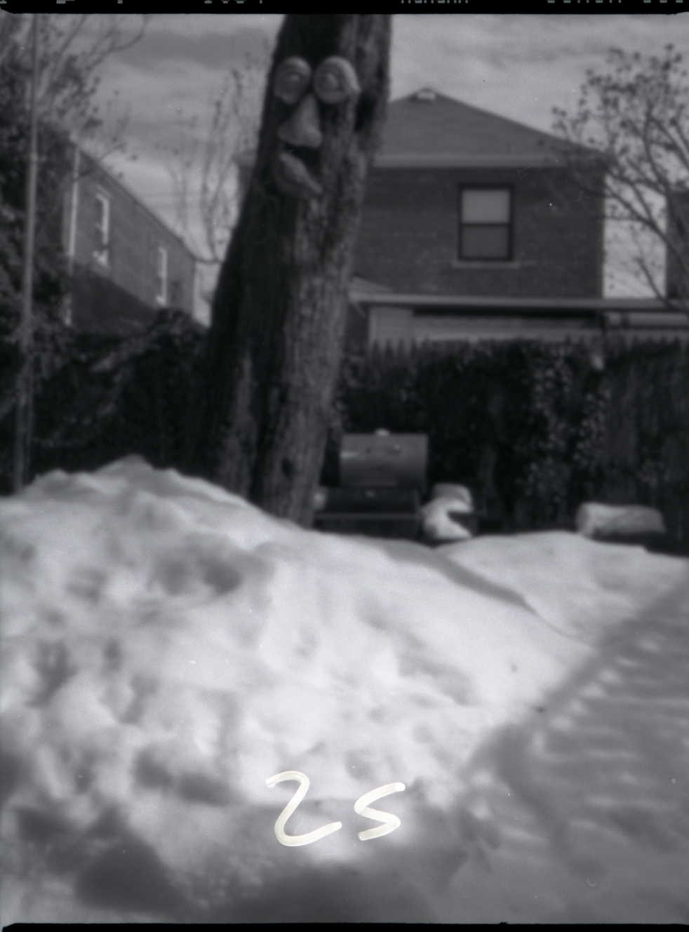

OK verdict is in. My lens isnt focusing in the etrs but I have images.
Maybe using my RB67 will allow me to focus?
I metered for shadows zone 3 and my exposure was suposed to be F8 @ 1/60 using neopan 100.
it was cloudy but sun peeking in n out.
I did my test frames from 1/2s 1s 2s 3s 6s 12s 24s...etc.
My visually best frames are 2s 3s 6s seem to have very little difference between them.
12s is still useable.
Here is a scan of 2s, 3s, 6s
next test will be using an RB67, hopefully one day next week.
markbarendt
May 18, 2008
9,422
Beaverton, OR
Not true.
Pinhole lenses "can't be focussed" except at infinity. (More correctly pinhole cameras are always focused at infinity.)
Adjusting the distance from the film changes focal length, which changes angle of view also.
The only focus control you have is aperture.

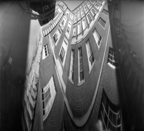

Pinhole photography favors wide angle pinholes. The mirror in SLR cameras sometimes gets in the way of this. Old folding roll film cameras that aren't good for anything else can be adapted to short focal length pinholes. Press cameras like the Speed Graphic need only a pinhole to replace the lens for a quick and versatile pinhole camera. In homemade pinhole cameras, the film need not be flat. Curving the film leads to interesting distortion as in this example.

paul ron
paul ron
Jan 22, 2004
2,709
NYC
thats pretty cool.
i also see your image is fairly sharp too.
