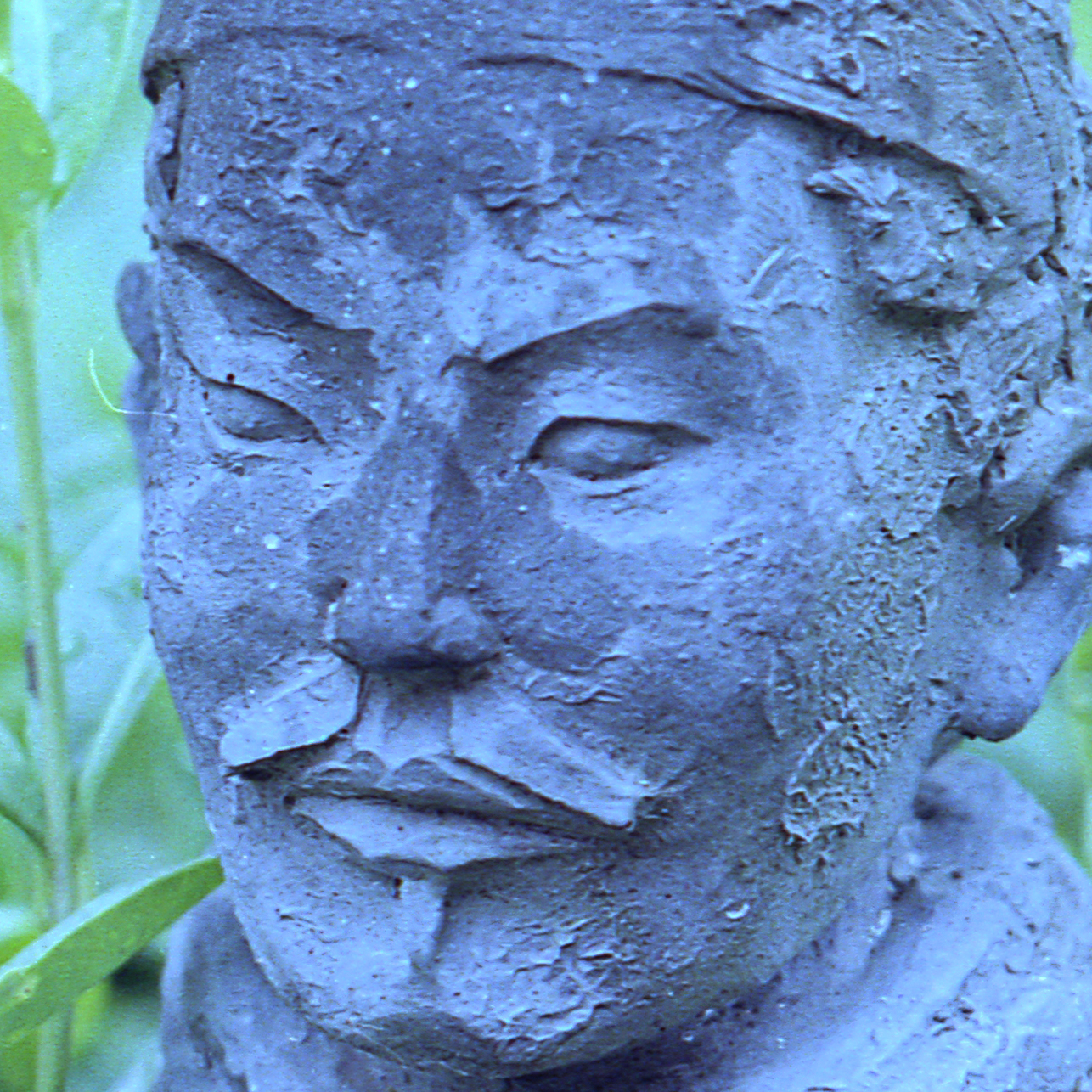

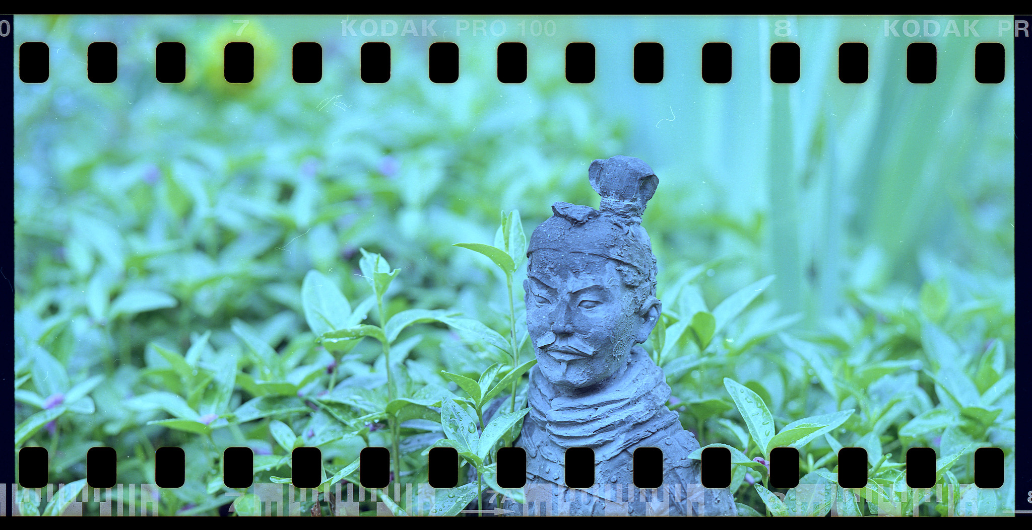

OK, so given the crappy day that it was here on Sunday and the fact that I needed to force myself to do something photo-related, I shot 2 rolls of Kodak Pro Image 100 35mm film in my RB67 ProSD. 1 roll in the 220 back with adapters, and 1 roll in the 120 back with adapters. I had the double-exposure switch flipped on both so there was no issue of not getting all of the shots in on the 120 back.
I shot the same shot each time with each back without changing or moving anything. The nice thing about the overcast and drizzly day was that the lighting wasn't changing. I varied things up with close focus, far focus, and wide open. Different subjects. All shot with the 180mm Sekor C f/4.5 lens. Both rolls were developed at the same time in a Paterson tank with UniColor C41 chems. Scanned on an Epson V600 between two pieces of ANR glass, at 48bit color, masks/ICE off, 3200dpi. Note no dust-removal or post-processing has been done on these.
I've scanned the first few images, but haven't ran thru all of them yet. I'll report back with a more in-depth analysis, but my initial take-away is that the two are fairly close in terms of sharpness. I *might* give the nod to the 220 back slightly, at least in the case of this first image shot at f/8. But its so close.
More to come.
First image is the 120. Second is the 220. First crop is the 120. Second is the 220.
To my eye, not so much a difference in sharpness, but a very slight difference in focal distance. The lower image is focused a little closer to the lens, which would equate to the film being about a gnat's whisker further from the lens. I don't think it's enough to matter unless you're shooting macro or doing wide open portraits that will be printed HUGE.
