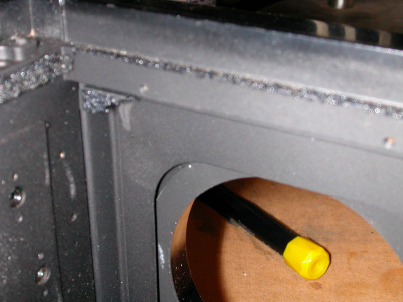

Using a JIS Japanese Screw driver set, that we just received in the mail, we opened the RB67, and first inspected the mirror springs. They looked fine, and unbroken. The mirror was evenly spaced from right to left, at the hinge also.
Investigating further, by physically moving the mirror from the open left side of the camera body, we found out that the mirror was hanging up as it came closed, near the top of its arc. Gazing inside the camera body, towards the front left of the camera body, we saw a tell tell mark. The mirror was being caught by the camera body.
Reached in with a finger and gently pushed it out.
Problem solved, and ... SIGH, ... we really didn't have to disassemble the camera to see this, but the question remained, what caused it?
