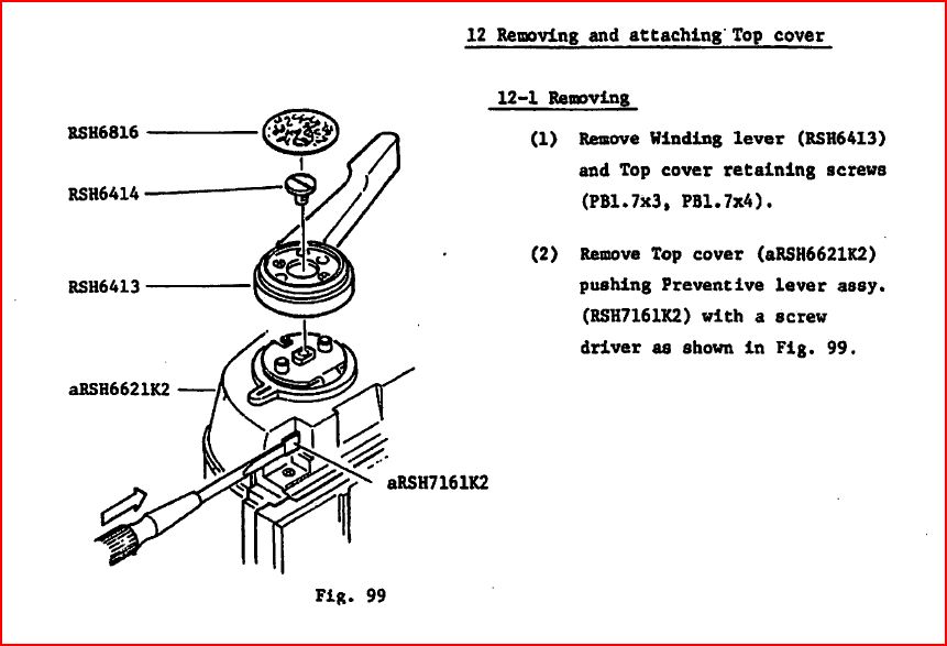

The advance lever on the 120 back of my RB67 Pro S is worryingly loose. So far it is functioning just fine, I've never had problems winding and frame spacing isn't an issue but it seems like it could be a minor disaster waiting to happen. I've only had the camera a couple weeks so I can't really say if it's been getting worse over time. I'm sure there's a way to tighten it though nothing seems obvious so rather than poking around blindly I'd be happy to defer to the wisdom of anyone who might know exactly what to do here.
[video=youtube_share;hV_h32t6GSg]http://youtu.be/hV_h32t6GSg[/video]
The should give you an idea of how loose it is.
Your suggestions are appreciated, especially if you have successfully dealt with this before.

If you're lucky there is a loose screw under that leather disk.
Tom1956
May 6, 2013
1,989
US
It will soon come off, probably ending with chewed up screws or screw sockets. You need to get under the leather, which is undoubtedly easy, and tighten things up.
mwdake
Aug 25, 2007
779
CO, USA
I had the same problem, it was the screw holding the lever to the shaft under the leather disc.
It is a simple fix after you carefully remove the disc.
paul ron
Jan 22, 2004
2,706
NYC
The disk is on there with double sided tape n will go right back on.
