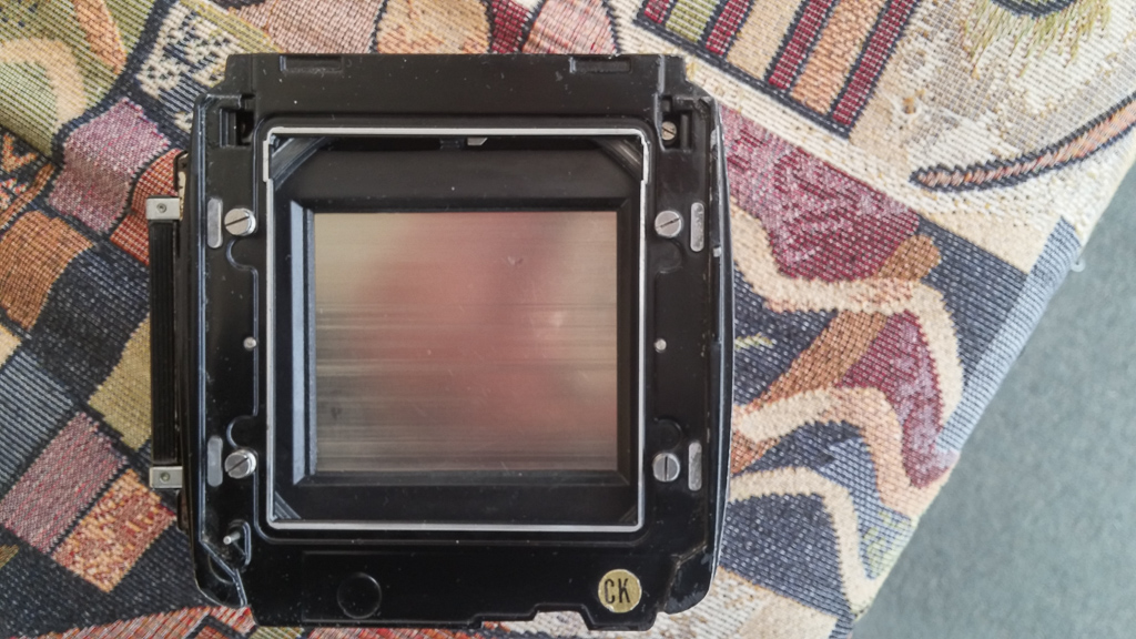

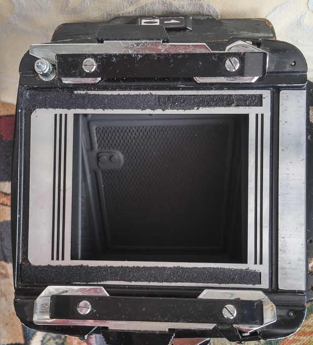

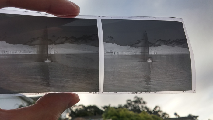

I have a trip coming up soon, I am in NZ so expensive and few. I plan to seek service in Hong Kong (and a general checkup given the age of it), got some leads. My parents are from there so they can speak etc. I am going to post some images can you guys have a quick look and see what you think.
Had it for a few months. Shot one roll. Plan to shoot a few evenings in HK with the sunset cityscapes. The B/W roll posted is fresh and processed by hand in a Paterson tank.
1. After the rotation back is off, is there suppose to be a seal around the square? Mine looks fresh with no residue.
2. Top right of the rotation back after the film back is off. Light seal worn?
Cheers.

Those light seal in Pic 2 definitely need to be replaced. If your other seals (on the film back and elsewhere) resemble those pictured, they should be replaced as well.
Look closely at the metal frame around the image gate. Notice the outer edge is 90° to the camera body, then a recess, then a raised portion. The rotating adapter has the opposite pattern and fits onto the camera which forms a positive light seal. For light to get in it will have to bend 90° five times to reach the image path. If either the body side or the adapter side is bent or otherwise deformed then it might leak.
The foam seals at the film holder to rotating adapter should be changed as they are going bad and will cause a leak in the relatively near future.

I may be too confident, but I'm 99% certain its not the light seals outside of the back. It actually happens when you re-insert or take out the darkslide. I know because it happened to me. There is some foam where you insert the darkslide that needs to be replaced. It's actually really easy, just take a few screws off and the frame comes off... Very very easy, trust me.
As for the foam, you might also try felt, I used one that sold for 1.99 for (8.5x11 inches) at an arts and crafts store here. Still working after 3 years of heavy use.
