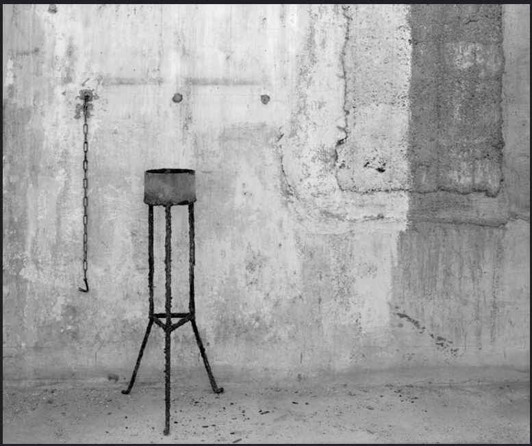

And with the floating element, it can be set before or after focusing, according to Mamiya...
It is most accurate if you first focus, then read the distance from the side of the camera, then set the ring, and then, if necessary, adjust the focus to its final position.
You would be most likely to notice the benefit of this if it was one of those photos where the primary point of interest was near the edge of the frame.
Something like the chain in this one :smile:
(and yes, I'm posting images I have from Andrew's portfolio)

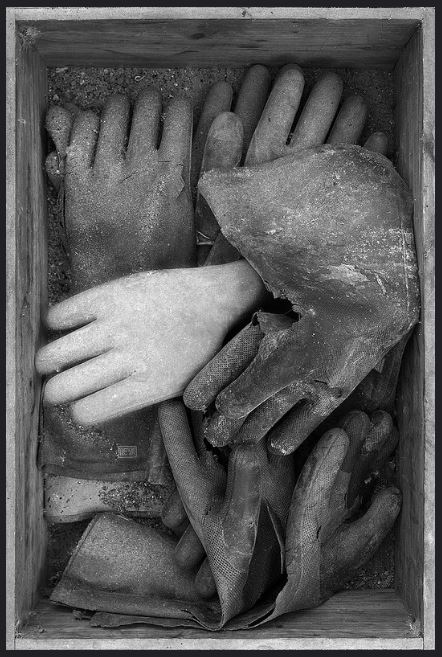

Outside of the world of walls, here is another example of where you might have seen a difference 😉
