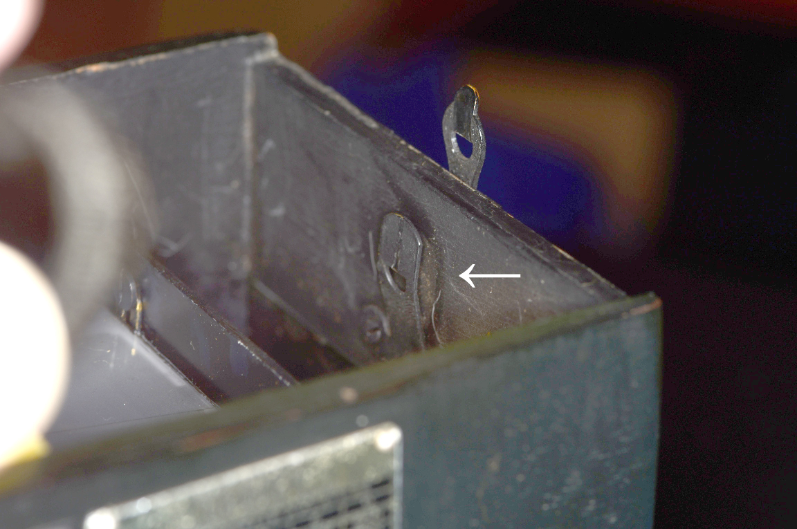

You left out one important feature for the average user. There is a clip at the front edge of the view hood at the ground glass that releases the view hood from the ground glass allowing for cleaning the top surface of the ground glass. There is a grove just above the rear of the groundglass that the rear edge of the view hood frame slips into for reattaching the view hood.
