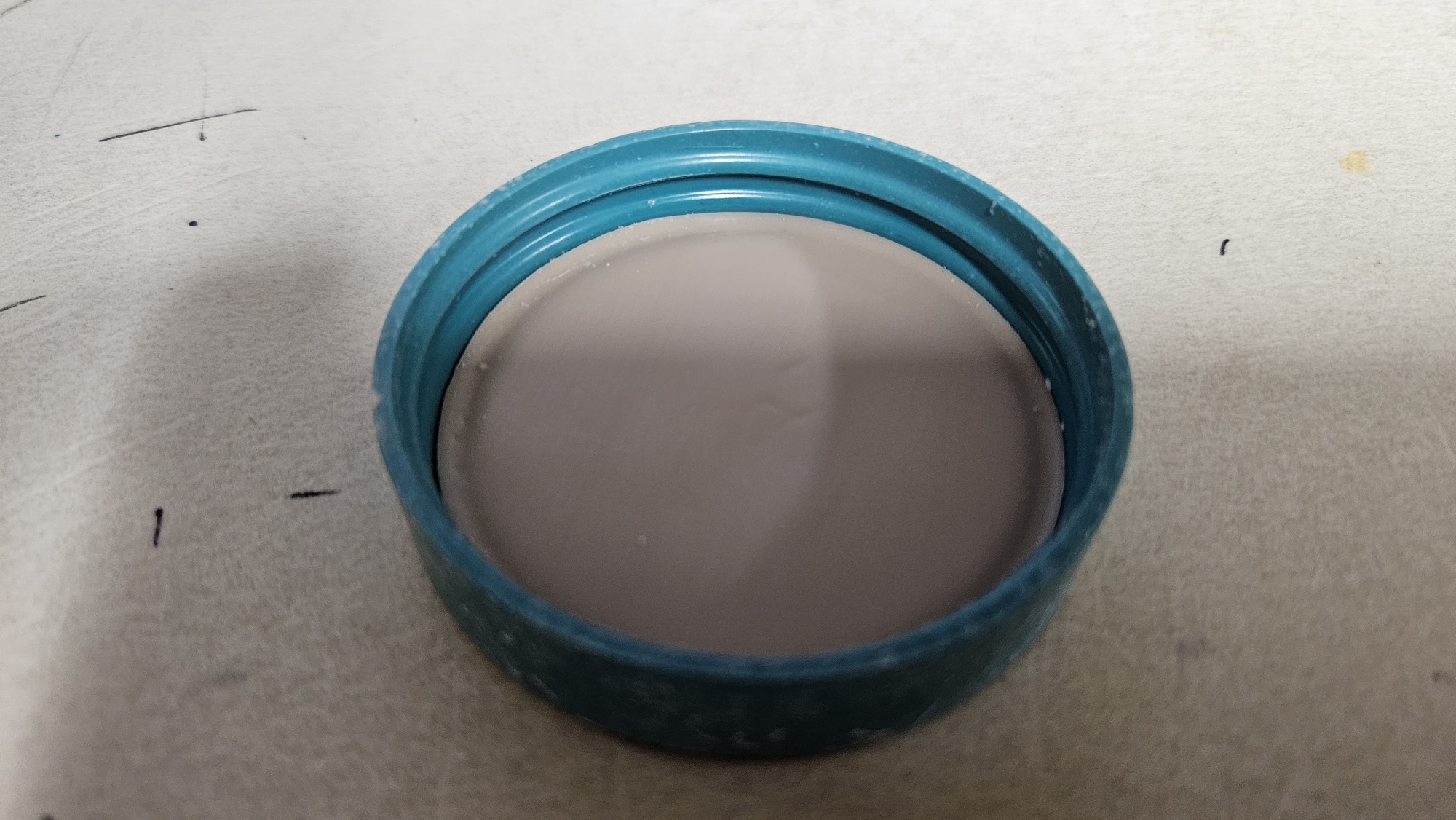

Here's a cap. The material is hard and slippery. It is not like foam at all. I could get all new bottles but I wonder if some kind of material comes in sheet form which I could cut and insert.
That looks like it might work OK for stuff like sodium carbonate, potassium bromide and other fairly innocuous powders and crystals. Anything that is prone to oxidization or offgassing/evaporating should not be stored under those lids.
I'd preferably not use them either for anything strongly hygroscopic.
I would not waste time, money and ultimately chemistry on trying to get these to work with stuff like acetic acid, ammonia etc.
