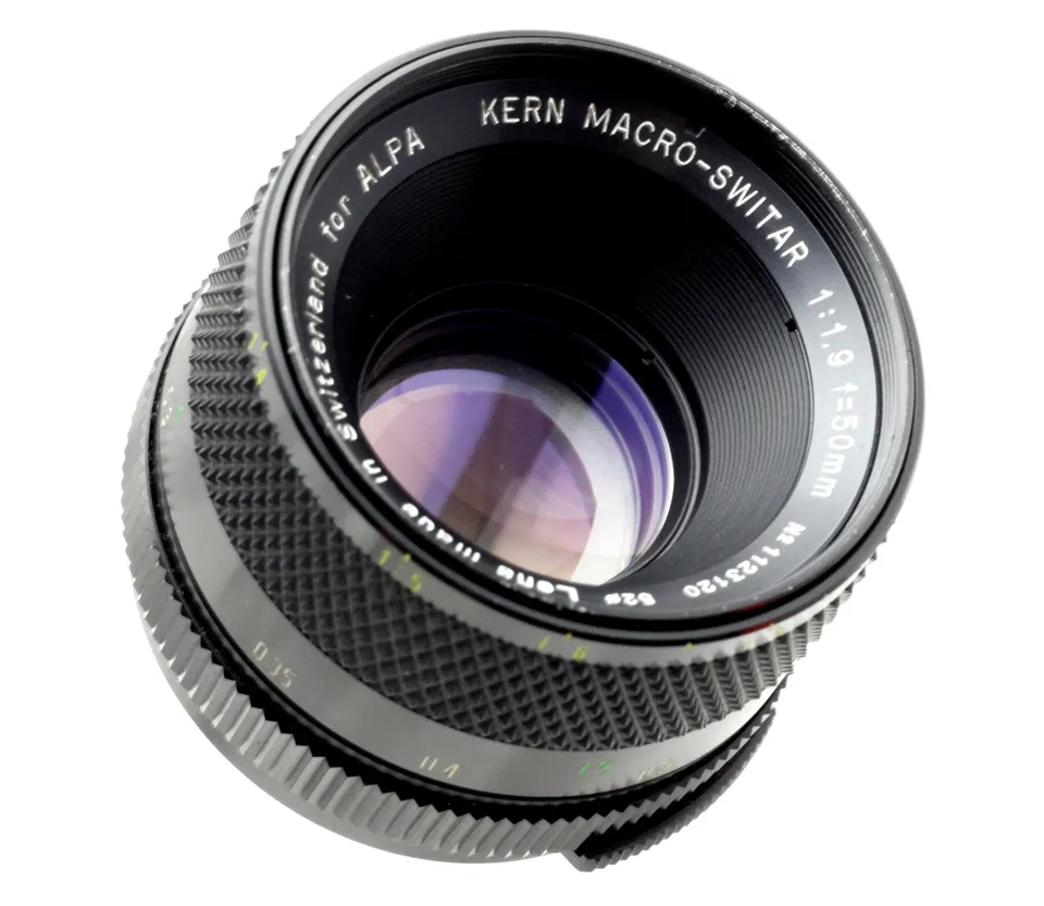

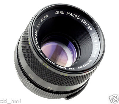

Another contender is the Chinon 50mm 1.7 Macro, a copy of the Kern Swiss 50mm made by Chinon for the M42 rebanded Alpa. While looking for a Chinion copy I found a Kern Swiss 50mm in M43 mount, never seen one before but so expensive. Seller wants over 6 grand for it.
That does seem rather excessive! And the lens isn't a true macro I think, it only goes to 1:3 magnification.
Now, the Macro-Quinon is a different story, as goes beyond 1:1 from what I've read.
