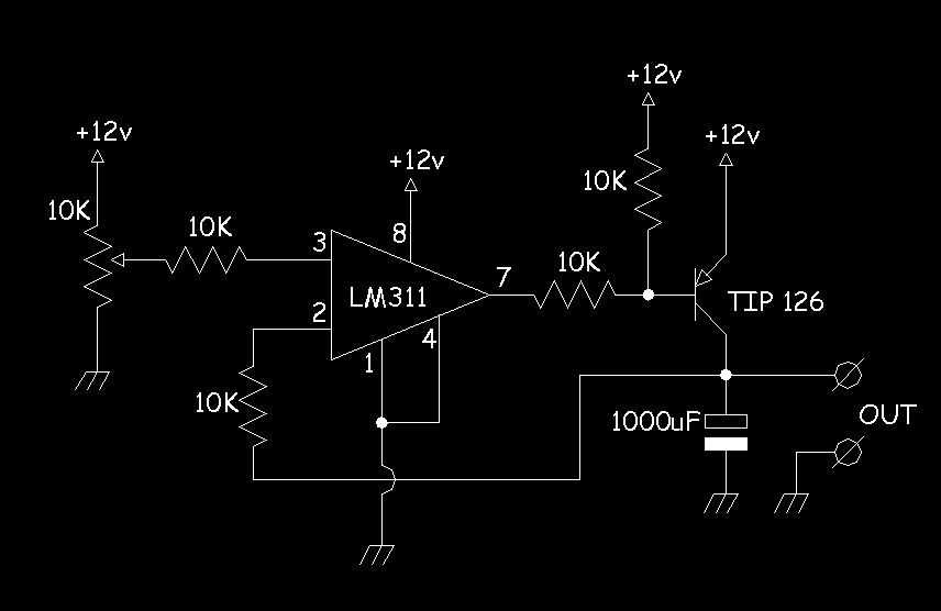

Here is the circuit I use for controlling small DC motors. It will work for LEDs but will need a series current limit resistor fitted.
Steve.

domaz
Nov 2, 2007
572
Tacoma, WA
Switching current regulators are the most efficient and best thing to use for dimming. Buckpucks are good and not too expensive- some will even take AC power right out of the box and support using a Pot for dimming. Can't get much easier than that.
