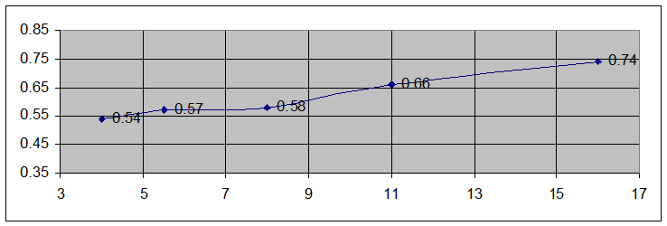

I've made a simple Time / Gradient graph in Excel using the data from Chuck's spreadsheet. While the rate of development isn't very steep, except for the 8 minute test, there doesn't appear to be a problem with the overall progression.
That's good to know, but I can't look at the "development compensation vs. development time" graph and think that it is right, at least at the moment.

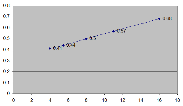

That's interesting. Thanks for taking the time to do that. I decided to plug your numbers into my program. I got values very close to those Bill got with his hand drawn curves and CI overlay.
Results from my program:
4 min 0.41
5.5 min 0.44
8 min 0.50
11 min 0.57
16 min 0.68
My program uses a variation of contrast index where it uses 0.10 as a base and draws an arc 2.0 log-H units to the right. As described in Photographic Materials and Processes. Just to help illustrate the how the various methods of measurement can effect the results, my program also does Ilford's G bar with a log-H range of 1.50 and an average gradient with a log-H of 1.80. I got 0.72 for the 1.80 average gradient method.
And here's a Time/CI Graph. As you can see, it's smoother than the one derived from the values from Ralph's spreadsheet, which is a positive indication as to the validity of the results.

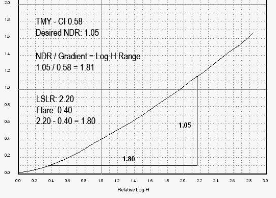

May I suggest testing both 0.10 and 0.19 as the base for the log-H range. Don't expect it to be a perfect fit. Curve shape will have an effect, but this should give you an idea if there is a problem with the gradient values or not.
Here's an example with one of my own tests. I use a NDR of 1.05 and for normal a luminance range of 2.20 with 0.40 flare for an aim log-H range of 1.80. With a film developed to a CI of 0.58 the NDR of 1.05 should be achieved at a log-H range of 1.81.

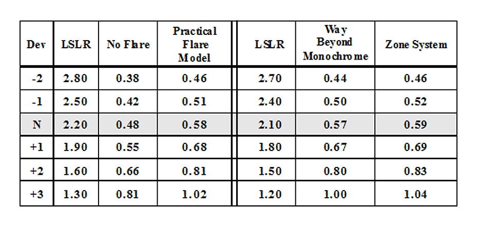

Just for the sake of clarity, there is no definitive set of gradient values for the different stages of development. Not only is there the choice of diffusion or condenser enlarger, but the choice of paper (including alternative methods), personal taste for the NDR, what is considered the average luminance range, and flare also play there part. The following example illustrates the results from four different models for diffusion enlargers. While three of the four results are very similar, they are determined using different variables. The Practical Flare Model is mine and is determined using a combination of a fix flare and variable flare approach.
