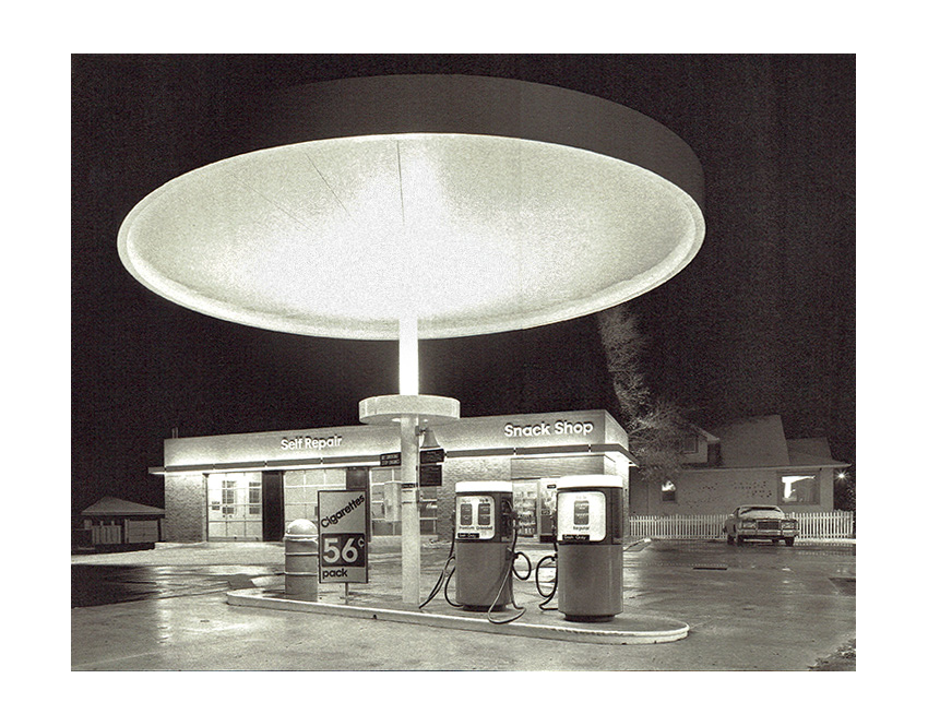

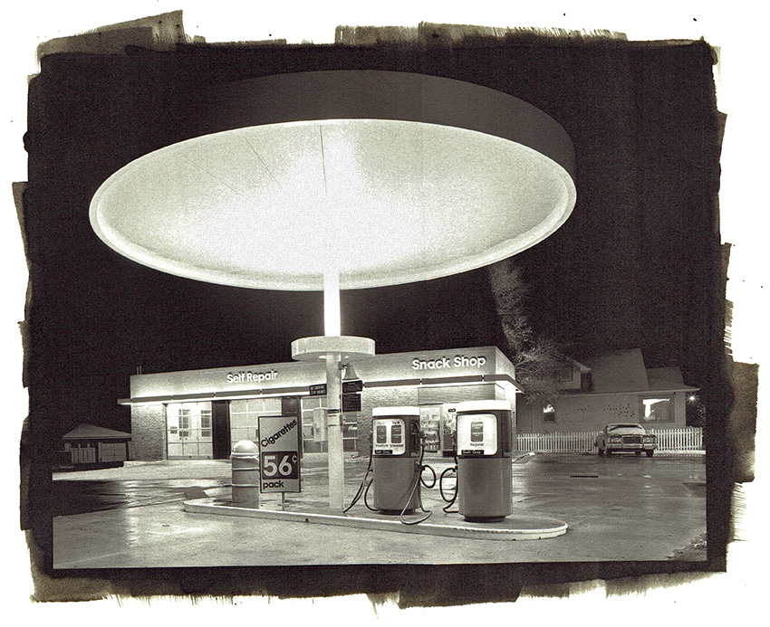

What do folks think about masking out the brush-marked edges vs letting them show?
I like them both - what really matters is what you like, and what you want the final image to look like.
To mask or to show brushed edges is a decision for the person who made the photograph. But as a viewer I really dislike them. I think they are an affectation. They always catch my eye and deflect my brain from looking at the photograph, unnecessarily drawing my attention to the process rather than the essence of the image itself.

IMO a hand-coated print as an art object is not only about the photograph. The artistic expression is obtained by printing a particular image on a particular paper in a particular way and all this are means of expression. In this regard the the brush-marked edges contribute to the final outcome in an expressive way, too. It could be an benefic contribution, in harmony with the other visual elements involved, or not, by contradicting them.
For instance In your example, IMO, they contradict the peaceful character of the image and therefor they should be avoided (at least in the way they are in your example).
I mat my prints so the the brush marks don't show, but they are there when you lift the mat and reveal that the print is hand made.
This.
I think there's an aesthetic part and a practical part. Some people like to make normal silver gelatin prints with crisp black borders or with "dirty" black borders too.. and it's just a matter of taste and what you like. Some images look good with a black border, and IMHO some don't. Some of my prints are pretty high key and I think a dark border clashes with the delicacy of the print... I even think crisply defined borders do.. eventually I want to make some prints with a vignette mask so that the edges fade smoothly into white paper without a defined border at all. I tend not to like brush marks around the edges, but I get it that many people consider it to be part of the expression and art.
From a practical standpoint, leaving the borders to darken can hide problems that you might want to know about.... so at least during testing it's a good idea to mask off part of the border...
Here's another consideration: I've been printing 9x10 inches (23x30 cm) on 11x15 inch (28x38 cm) Platine. Even being careful, I don't think I can keep my sloppy coating to less than an inch. So I might need to keep my images a little smaller if I want the coated border to show. (Right now, I mask to 9.5 x 12.5 with tape and coat within that rectangle.)

i don't mind ragged borders if they are not too in your face ..
the square look is nice it really makes
the geometry of everthing in the image pop..
Someimes it can add to the composition, like on "Struggle" by Robert Demachy. Sometimes it just looks distracting and ameteurish. If in doubt, go with a clean border. Using ragged edges just to give it a "hand made" look is nothing more than an attempt to lower the viewer's expectations.
Yes this is what I do in 90% of the cases ..If the border is a polaroid neg pull then I like to show this fact.
I agree with this approach. No point in being needlessly careful during the printing process with masking, etc. The end product is where neatness counts and that neatness is created with the matting.
Aesthetically, I can enjoy looking at sloppy artsy brush marks, because I enjoy getting a glimpse of the process, but I agree that often detracts from the subject. I'd never show or sell a piece without a mat. Let the process geeks enjoy the brush marks by lifting the mat if they choose.
