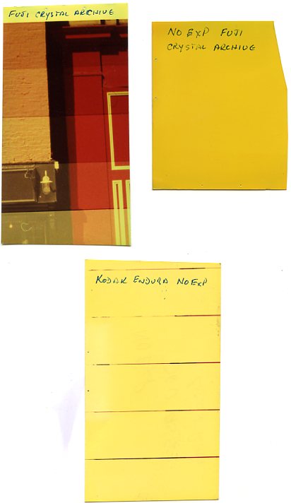

img543.jpg Right here we go.
1. The top left image is one I did tonight with a completely new mix of Tetenal developer but half the quantity of starter as I said in my last post. It is still predominantly yellow. The 3 coloured segments on the left side should in fact be pale pink! (Painted side of a building) Each of the test segments was 3 seconds. As can be seen, the rebate is yellow despite having not had any exposure.
2. The top right colour patch is a piece of Fuji Crystal archive which has had no exposure what so ever. This was in a solution with the Tetenal recommended quantity of Starter.
3. The bottom colour patch is a piece of Kodak Endura RA4 paper placed in a Patterson test strip printer and covered up with the 'fingers' and flashed with light to give the lines. Other than that there was no other exposure at all.
All three were developed for 45 seconds @ 35c Stop bath for 15 seconds and bleached for 45 second before rinsing.
The only difference between the three was the top left print had less starter than the other two and the developer and stop bath were in another NOVA processor to the ones done yesterday. This was done to eliminate any contamination of the chemical residue in the older and more heavily used 4 bath device.
What I can only deduce is, the Kodak starter which I was told by the Tetenal help desk was fully compatible with Tetenal products, when in fact it isn't. Or there is a problem with the concentrate I am using. When I quoted the batch number to Tetenal the date of manufacture was less than 6 months so what it actually is I am stumped to suggest a definitive reason.
The yellow filter in the enlarger is moving correctly and is constantly variable if I move the adjusting knob
