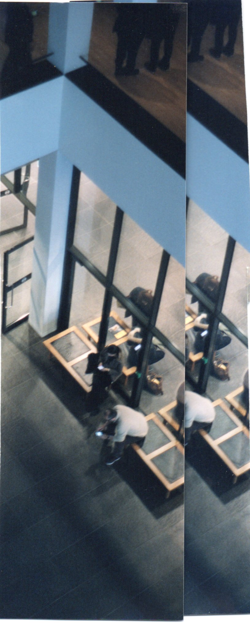

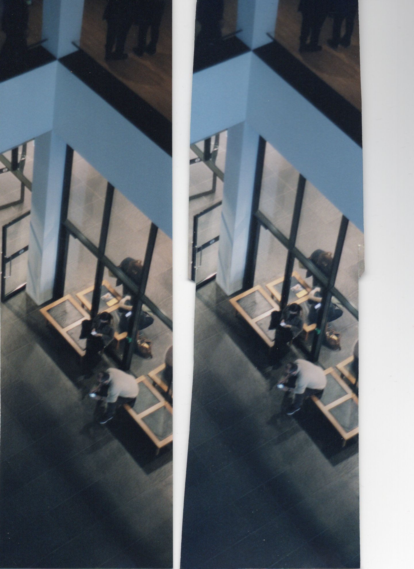

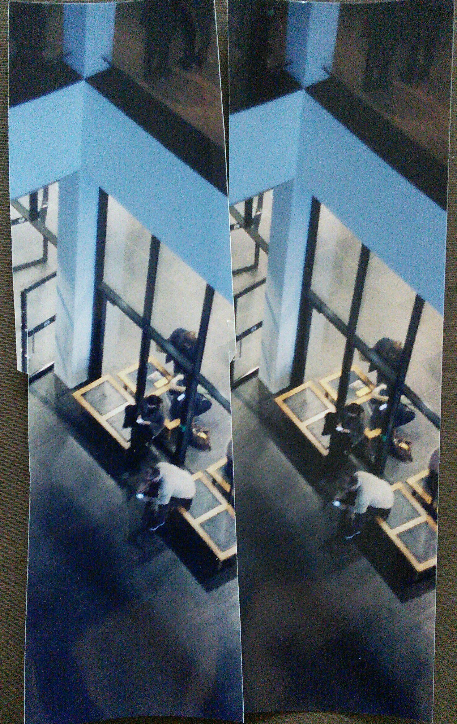

I'll try scan the test strips before the end of the day and post them as it's a bit difficult to see the difference. Most the time the difference isn't as extreme as this.
These are the scanned test strips if they help.

Well I certainly can't see any red cast here. Can you explain again what the difference is in the two scans in terms of what you did?

Hi Pentaxuser,
Both of these were exposed and processed exactly the same but there is a fair difference in them and I can't understand why. I thought it was a red cast at first but now I'm thinking the difference is in the density between the two.
Also I had another thread with a similar problem with the same begatine that I think you responded too but I solved that problem and another one reared its ugly head.
Hi Pentaxuser,
Both of these were exposed and processed exactly the same but there is a fair difference in them and I can't understand why. now I'm thinking the difference is in the density between the two.
Thanks for the reply. Yes it does look like a density change but if it's the same neg, exposed and processed in exactly the same way and presumably processed one after the other, I wonder how this density change can occur?
I wonder if the light intensity has altered so that in effect the exposure isn't the same. This can happen with bulbs that are almost at the end of their life. Usually unless the exposure is very short you tend to see the intensity change as it rises then falls.
Long shot now: Is there any chance that the scanning could have changed between scans?
