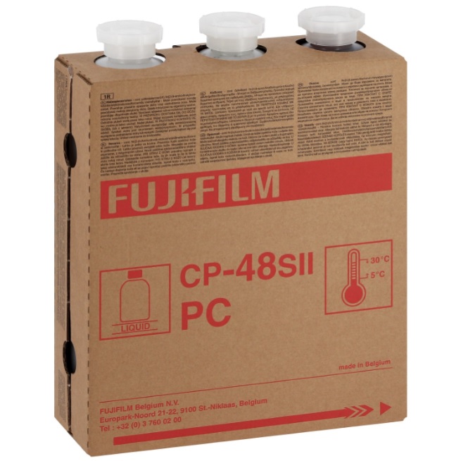

Has anyone ever tried the RA4 Fuji CP48 chemical cartridge used in minilabs?
They contained 3 chemical concentrates, dev, bleach-fix part A, bleach-fix part B. They were designed for wet lab Frontiers and each cartridge (they were sold in boxes of 2) would make a total of (IIRC) 5L dev, 5L bleach-fix.
