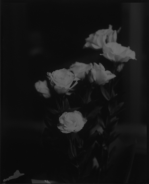

I'm trying out paper negatives with ra-4 paper processed in B&W chemistry.
I've tried:
Rodinal 1+50 - Low contrast negative
Xtol 1+1 + Rodinal 1+50 - low contrast negative
Rodinal 1+12.5 - Low contrast negative - ugly yellow/orange "rash" on the paper
Here is an example of Rodinal+Xtol:
Any suggestions on a developer/technique for improving contrast?

You will probably find that normal black-and-white paper (which can be handled under a safelight, unlike RA4) processed in any standard paper-developer produces better paper-negs than RA4 processed in film-developer. Having said that of course, I think that I recall Rodinal was originally (more than a century ago) also recommended for silver-chloride papers at a dilution something like 1+3.
Presumably you are completely unable to use any materials other than RA4 paper and Rodinal? If that is the case then a stronger mix of Rodinal, and a higher temperature, should increase the contrast - but it will most likely still look poor in comparison to normal materials. Out of curiosity, what are you planning to contact-print the negatives on?
Often the contrast 'problem' with paper negs, using b+w materials, is that it is too high. If you can find a fixed-grade, black-and-white, resin-coated paper for the negative then the contrast will likely be better (ie. lower) than using a multi-contrast paper, but they will work too. Pre-flashing the paper is also an option.
Color emulsions usually give low contrast when developed in B&W developers. This is true for both papers and films. There is very little that can be done to remedy the problem. This problem has been discussed on threads with respect to color negative film processed in B&W developers.

RA4 paper has very little silver in it. Consequently it is only capable of producing very, very weak dmax. Instead of black, it achieves a dull middle grey at best. Since this is an inherent property of the product, I don't see how this could be used for decent b&w work.
