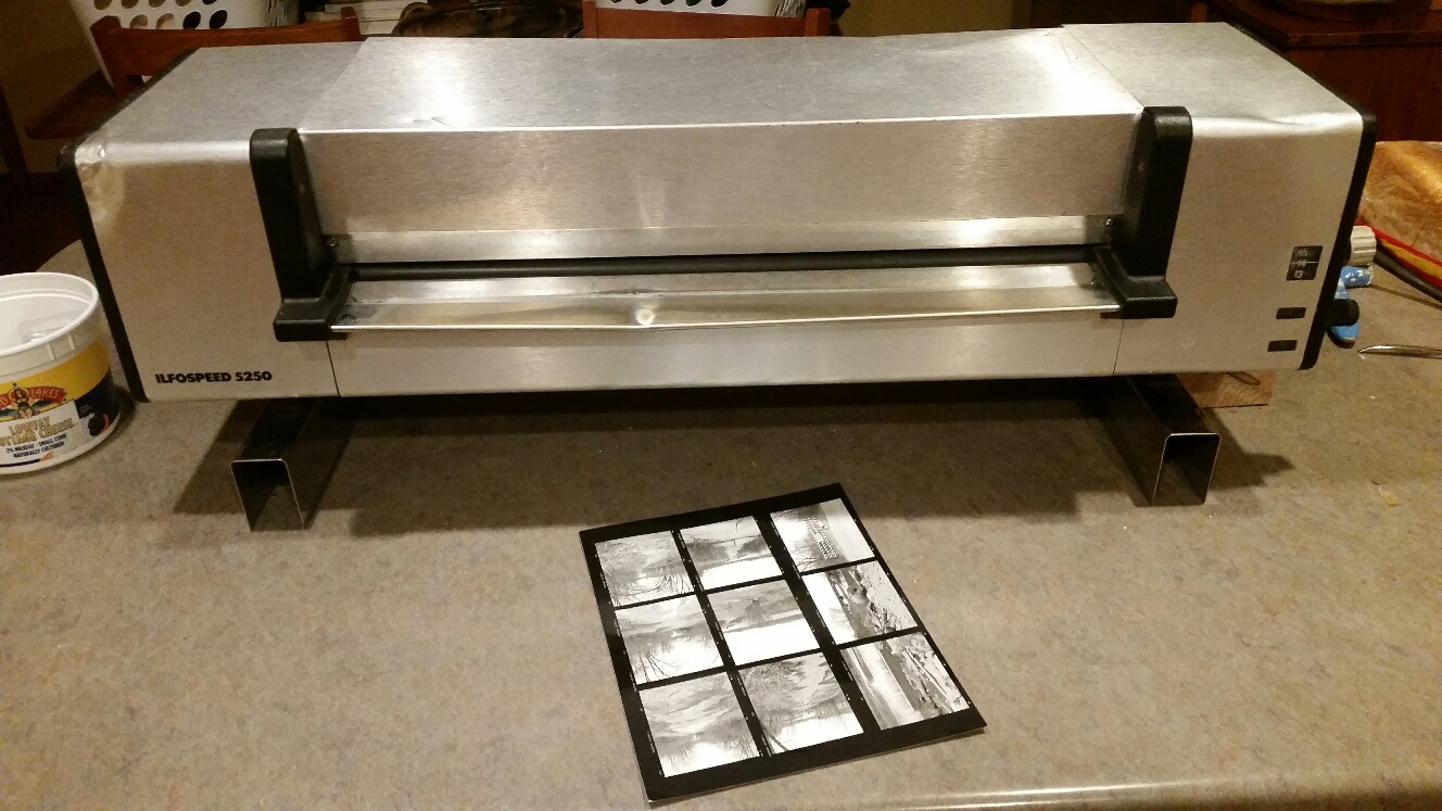

What's an "Ilford Dryer"? Do you mean an IWD-42?

20180522_234022_resized-jpg.201026
btaylor
Dec 28, 2010
2,252
Los Angeles
I got one of these in a darkroom lot. Replaced the foam in the rollers and it works great. Dries an RC print perfectly in seconds.

That is too funny! I just picked it out from Google images-- it's famous!

They have a really clean 110V Ilford 1250 used on secondhand darkroom UK £1300, delivery not included. I think I gave 150 bucks for my 1250, delivered, and less than 60 bucks for the rescued one.
It's really better for fresh tortillas than pizza.
