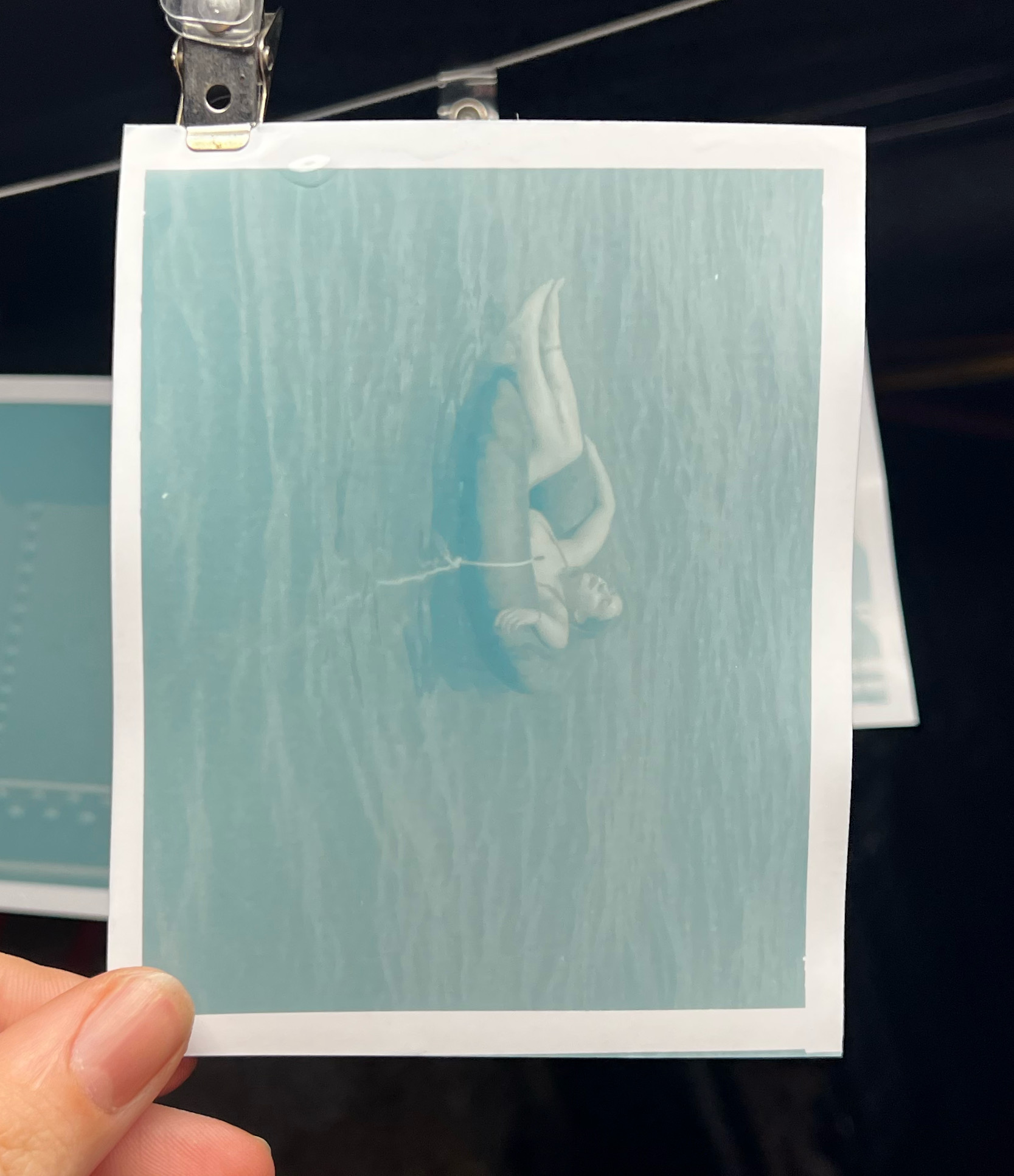

Got a fresh box of the Adox Color Mission paper, along with a fresh kit of Arista RA-4 Chemistry.
I’m a decent black and white printer, but I can’t get my head around RA-4. I’m using the tri-color additive method (wratten 25, 58, and 47B) with my 45MX, and developing in my jobo drums.
I consistently get prints with a heavy cyan cast that only affects the image area. At first I blamed the red LEDs of my timer, but I’ve eliminated this as a factor and my problems persist.
I figured a good way to diagnose would be to expose my test image only through the green and blue filters, exposing the Magenta- and Yellow-forming layers of the emulsion hopefully giving me an incredibly red print.
This failed miserably, giving me a strange Cyan-Green print, photo attached.
I’m so confused, and feel like I’m going crazy.

OK, first, have you eliminated any possibility of a mixing error? Also, is there any possibility whatsoever of the developer being contaminated with blix (although I'd expect cyan marks on the white borders in that case)?

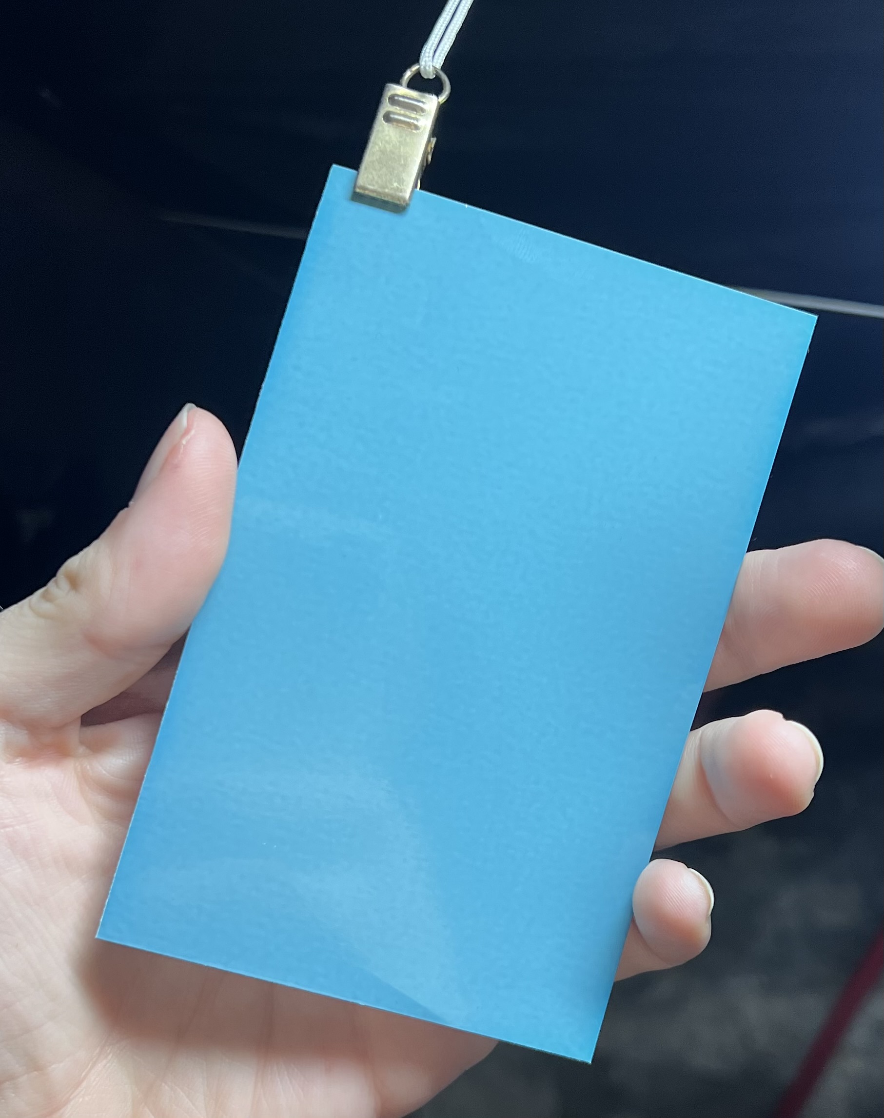

One thing you should test is to take a strip of fully exposed paper (exposed to normal room light) and process it normally. Wash and dry (!) This should of course come out pitch black. Please verify if this indeed happens.

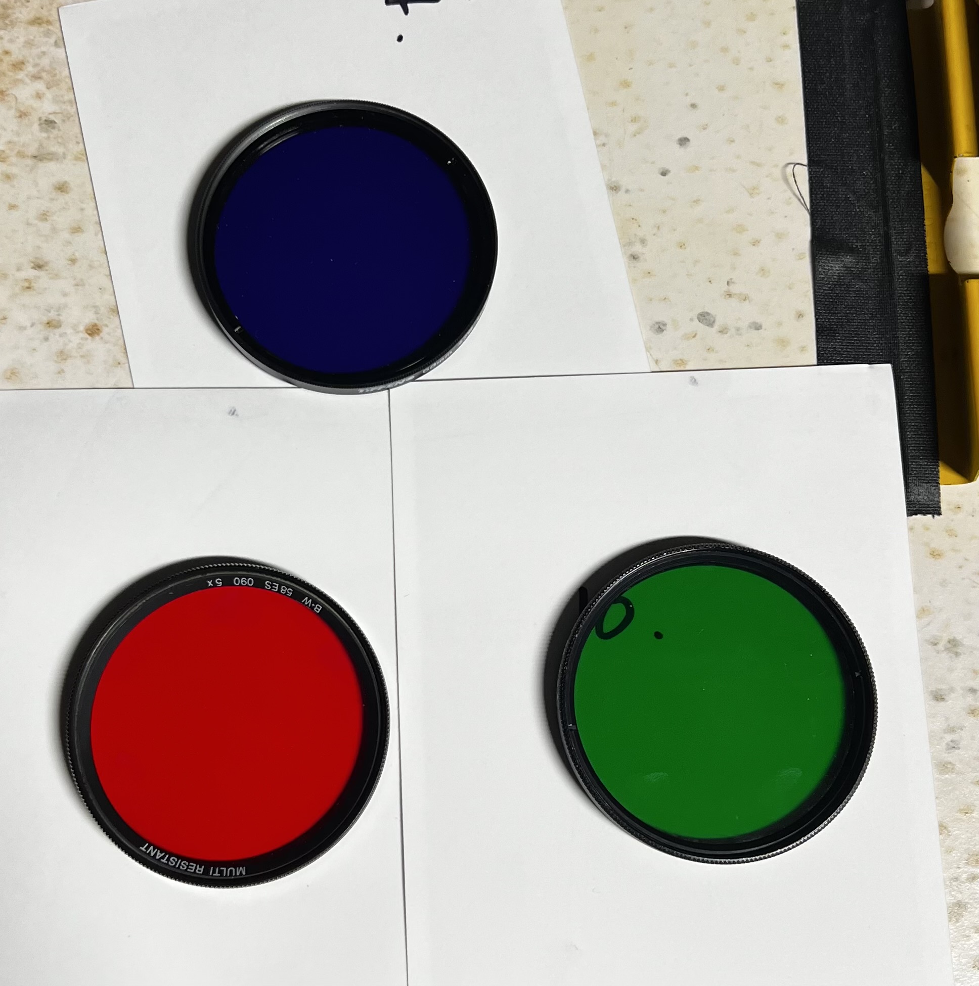

Getting a low-contrast, cyan print when using blue & green filters is pretty darn odd indeed. Are these filters in good condition (can you post a photo of them)?
Out of curiosity - are you doing three consecutive exposures with different times?
I got them from the classifieds here last week, they’re beautiful! Photograph attached.
Yes, in the example I posted I didn’t do a red exposure; 10 seconds of green, 36 of blue.
I did introduce a stop as well when I started seeing this issue, 30 seconds between the dev and blix.

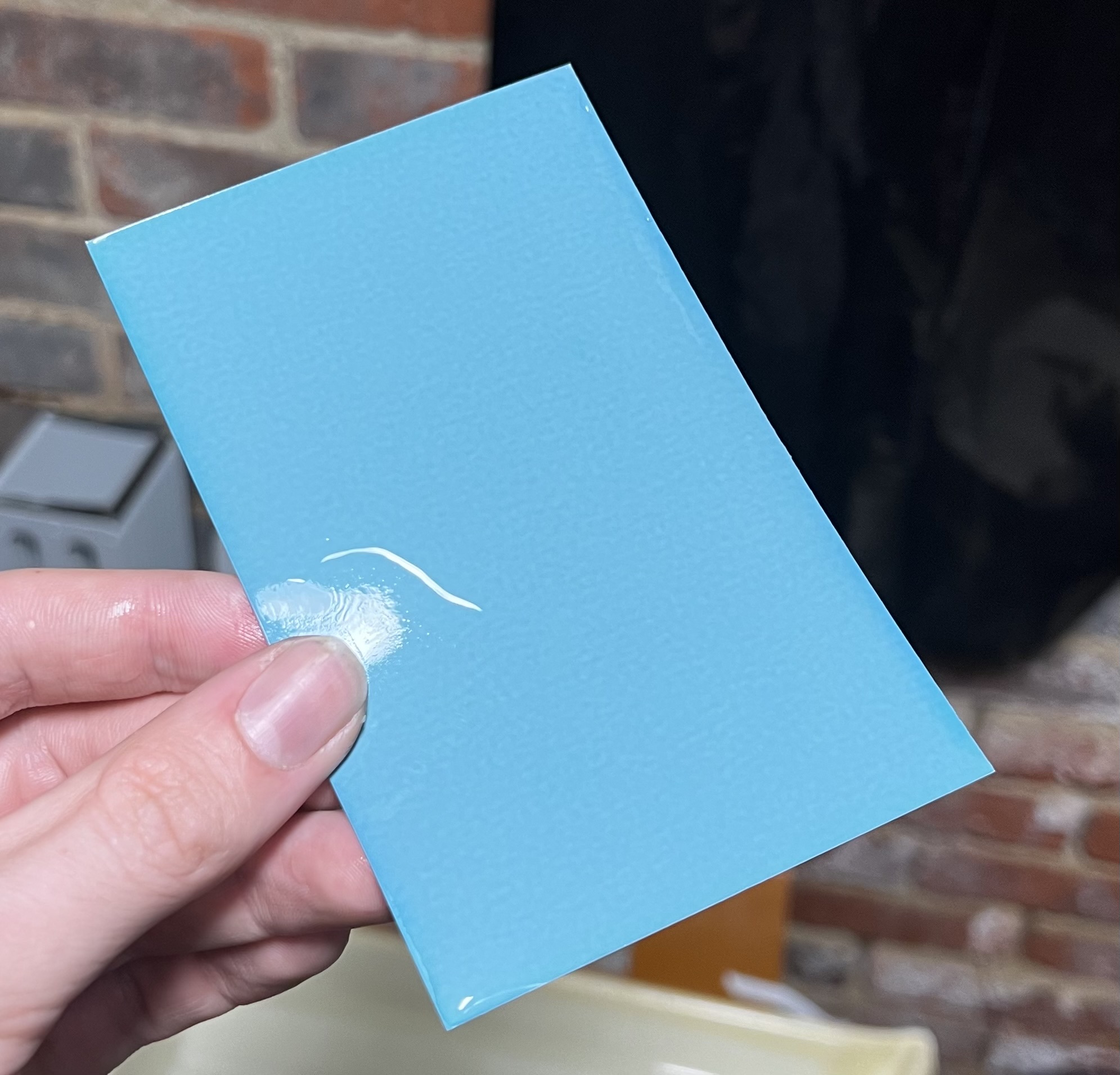

This is the paper which I exposed to room light and subsequently developed. I’m waiting for it to dry now. Is this how it normally looks wet? Or perhaps the cyan-producing layer is the only layer getting any development?

fujifilm crystal archive paper has a blue color before development, most of the color rinses off in prewet. I use yellow and magenta filtration dichro, before the dichro I used acetate yellow and magenta CC filters.
What you are doing should work when you hit the right combination. Tricky.

A few more data points before I must leave the darkroom for the evening;
The Color Mission, exposed to full room light and developed, dried down to a bright cyan without any other color;

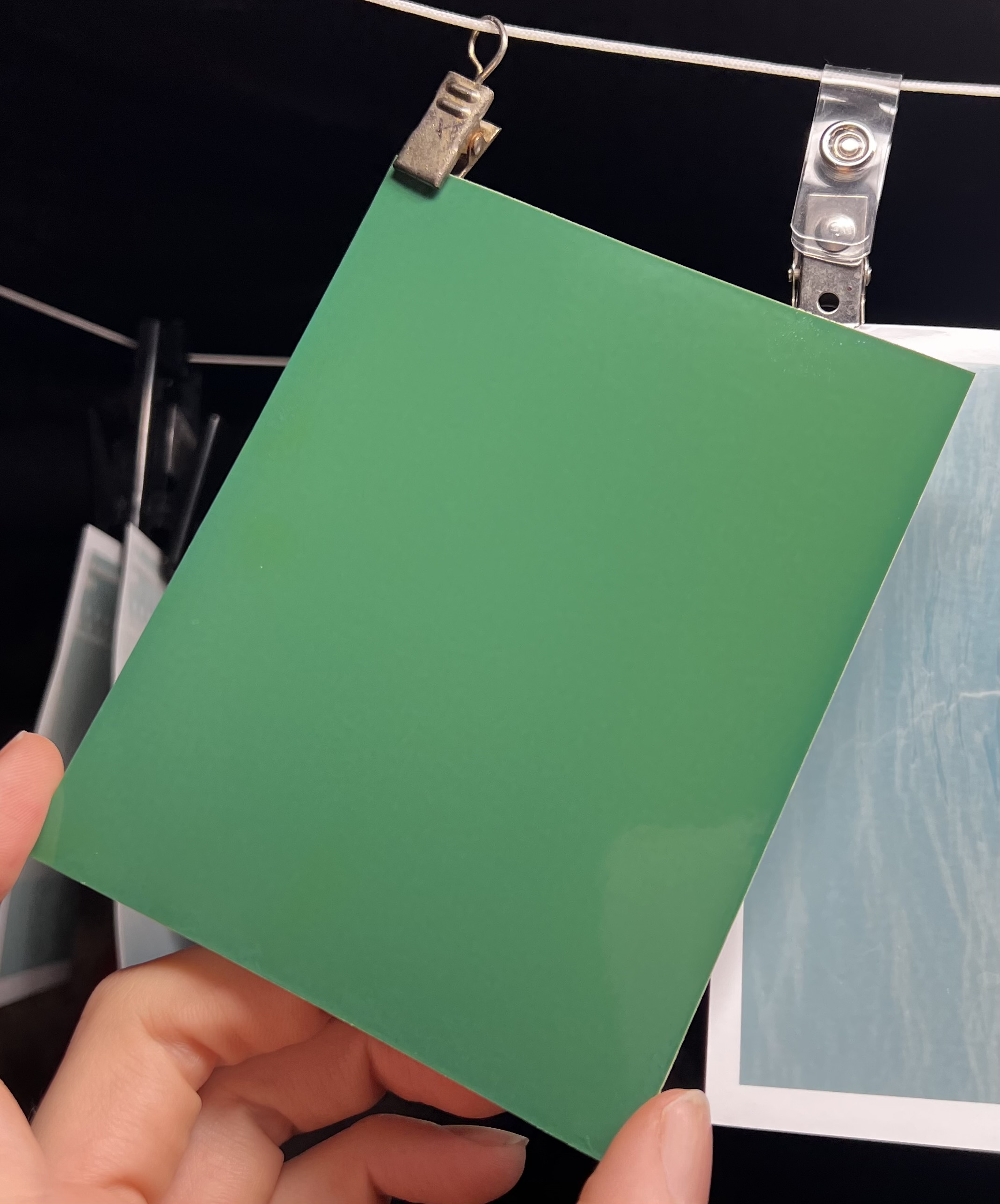

Additionally, I had a few sheets of endura on hand, now four years expired. I cut one down and exposed it too to room light, and got this back;
Since both sheets came out weird, this leads me to think it’s likely something is wrong with my chemistry. Perhaps I’ll invest in some of the Kodak Minilab chemistry instead of continuing to try and get this arista kit to work

This looks like gross underdevelopment to me. What temperature and time do you use for development? Is the developer fresh (i.e. not expired/old stock)? I'm not familiar with the Arista product; do you have some documentation for it?

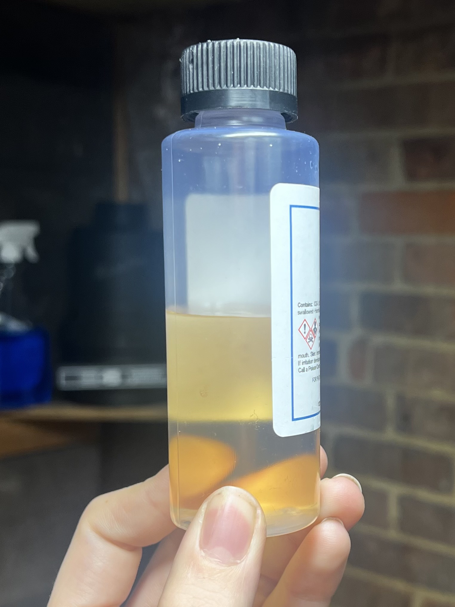

I don't see any fault in what you're describing. What is/was the color of the developer concentrates, in particular the smallest bottle (I think that's B in this kit)?
Bottle B is this “straw” color; it’s a little more pinkish to my eye than my iPhone camera renders it.

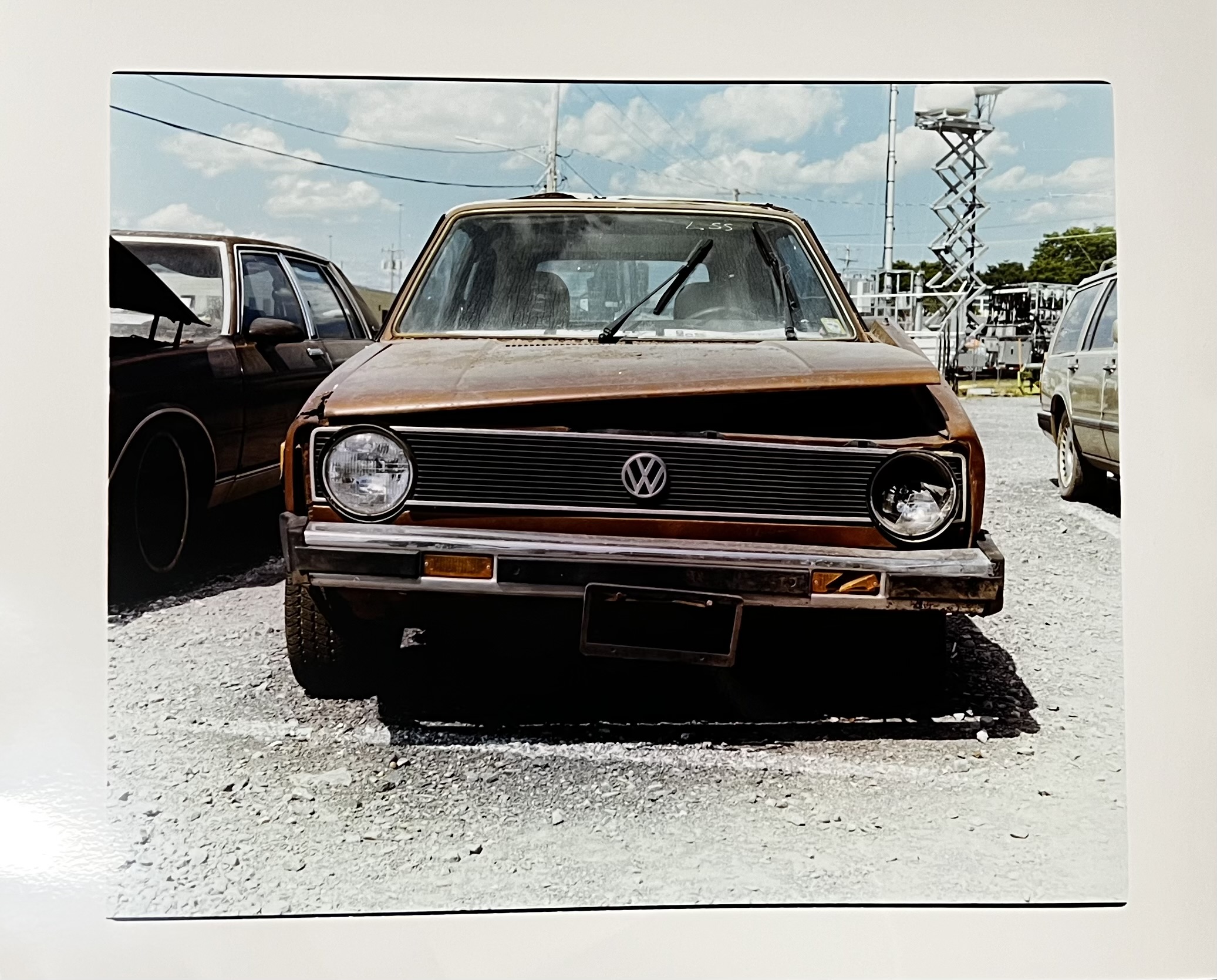

Here are some results as promised; Ektar on Endura Lustre;

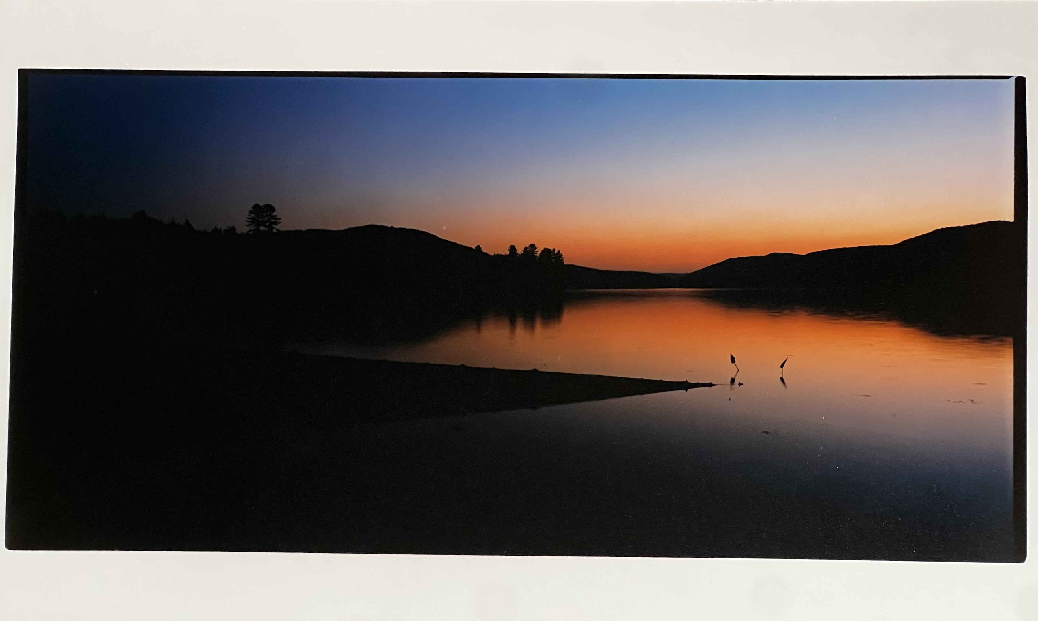

Gold on Maxima Glossy;
As with slides, the prints look far better to the eye than they reproduce on the phone :smile:
