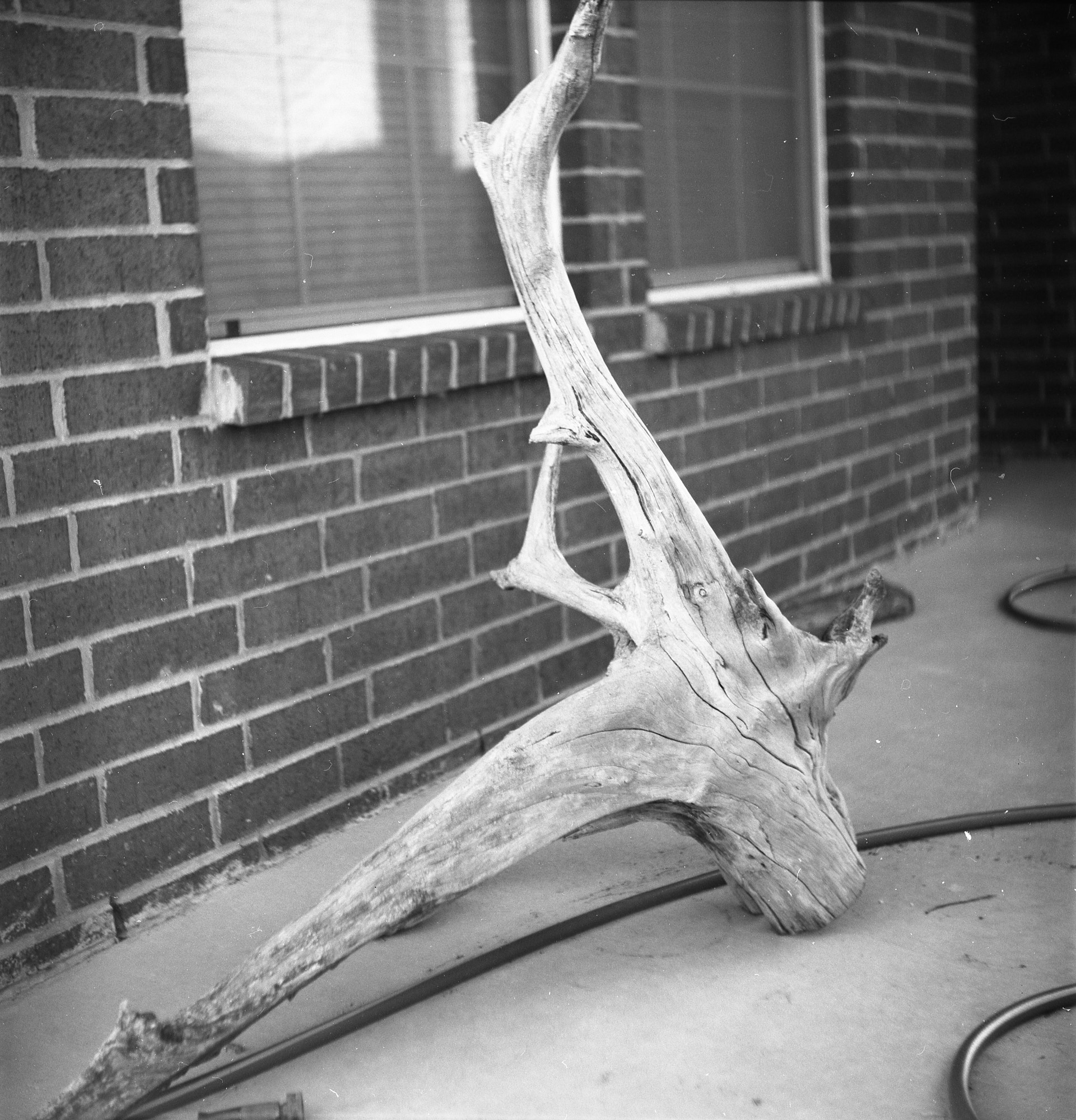

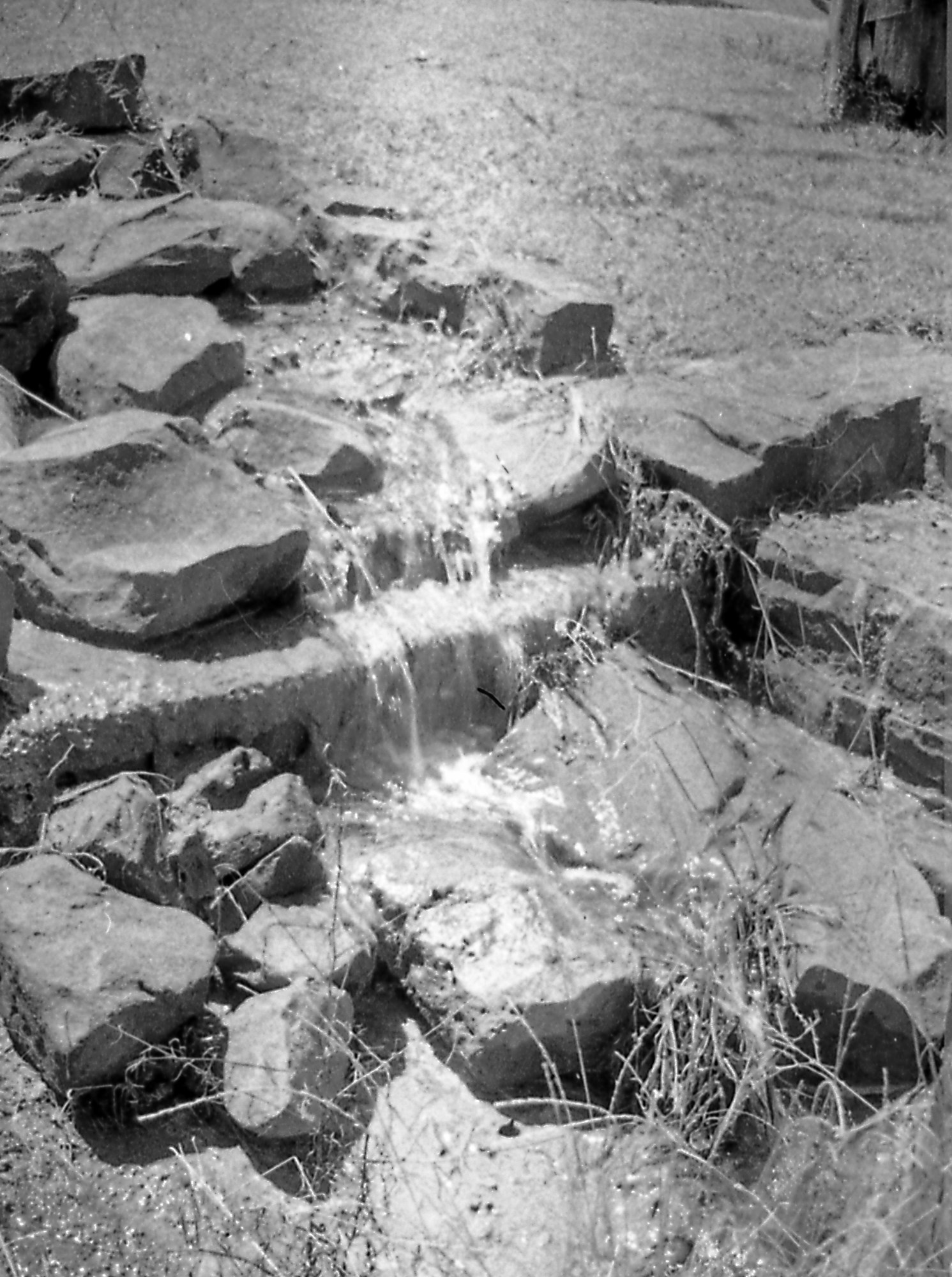

I had a big enough increase in contrast and some kind of uneven development in some frames but not all, center 1/3 denser than the rest. I did not get those issues with another roll developed in Diafine or with the first roll in R3 Monobath that gave decent results other than the bromide drag banding. Film was Lomography's Orca 110 shot at box speed with a Minolta 110 Zoom. I wonder if the full minute is needed, or if less could cure it as well. I only needed 5 seconds to cure a bromide drag issue with Diafine. The roll that came out good today was Fomapan 100 I had in a Ciroflex TLR. Examples show the worst of the agitation negatives(sunny water fall/water well outlet) and how most of the Fomapan quickly dunked turned out(sunbleached stump on a shaded porch this morning, quessed at the exposure). I am sure there is a bit of apples to oranges here using different films, but it was what was already in the cameras and on hand.
