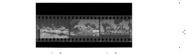

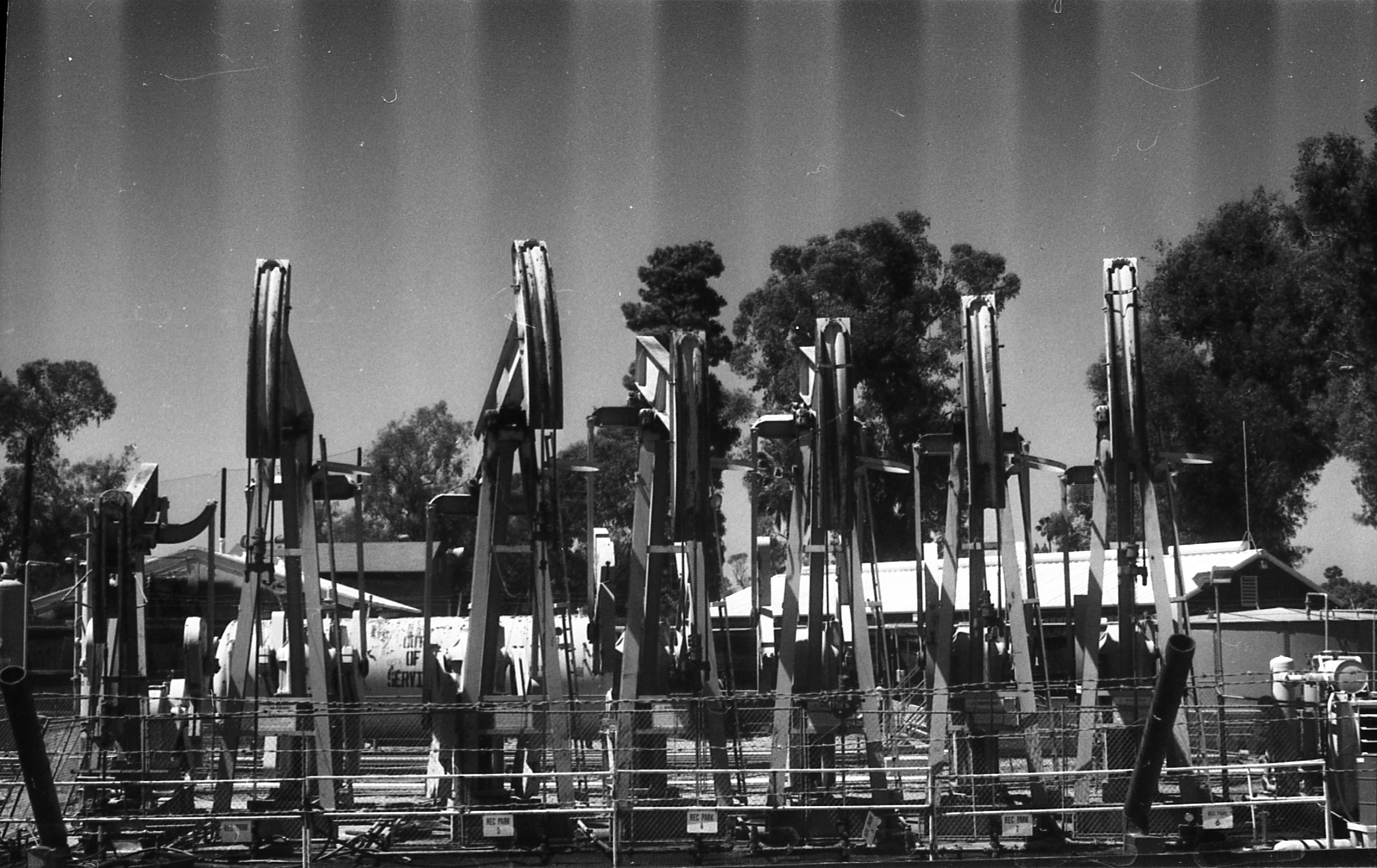

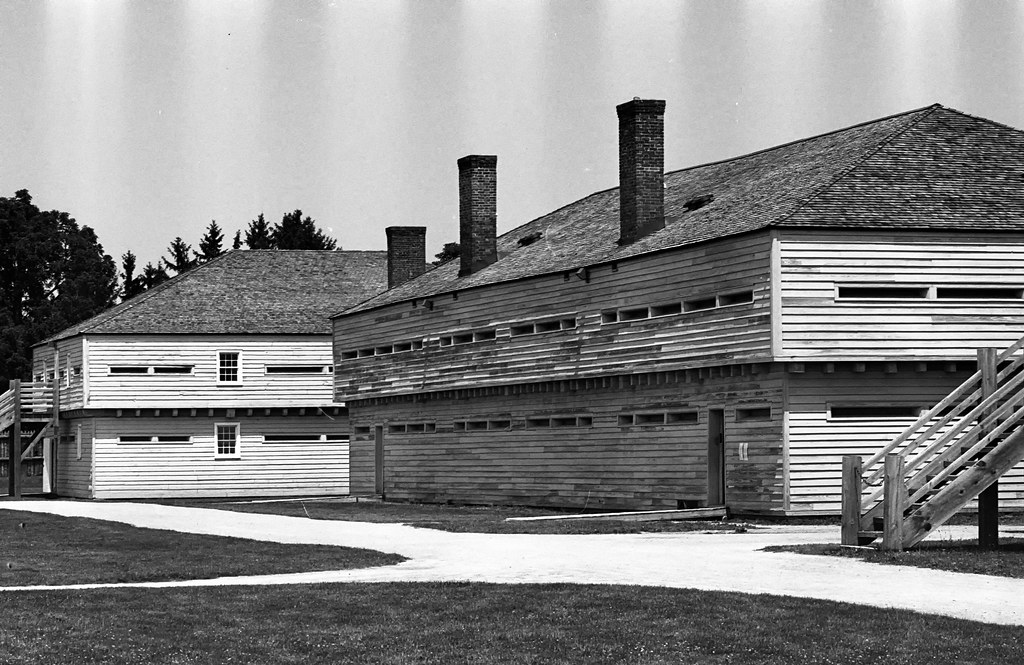

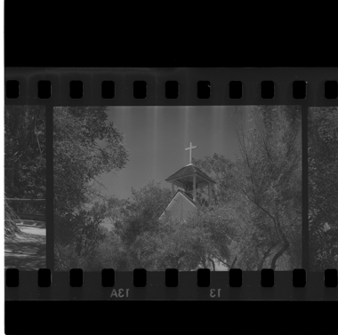

I love the idea of a single chemical developer that is reusable and keeps well. I'm afraid I will have to reserve this developer for 120 sized film with no sprocket holes only. I am guessing that due to the non-agitation of this developer, it has a tendency to drip down from the sprocket holes creating lines on the negative. Anyone see this before?

hi optiken
i beleive that is what is called bromide drag.
some say if you agitate every 5? 7 ? minutes you won't get this
problem, but i also think it depends on the developer.

Reserving the monobath for only 120 film is not going to get rid of the problem. Without the sprocket holes it will just look different. You will see it when there are heavily exposed areas adjacent to lighter areas.

It is bromide drag and is created by bad agitation. Therefore, what you have done is not enough.
You may have too much solution in the tank. Too much and agitation cannot take place effectively. You have to have a tiny air space at the top of the tank just so the reel is covered by developer. The air improves movement of solution when you rotate. But, inversion is important as well. Try a few inversions.

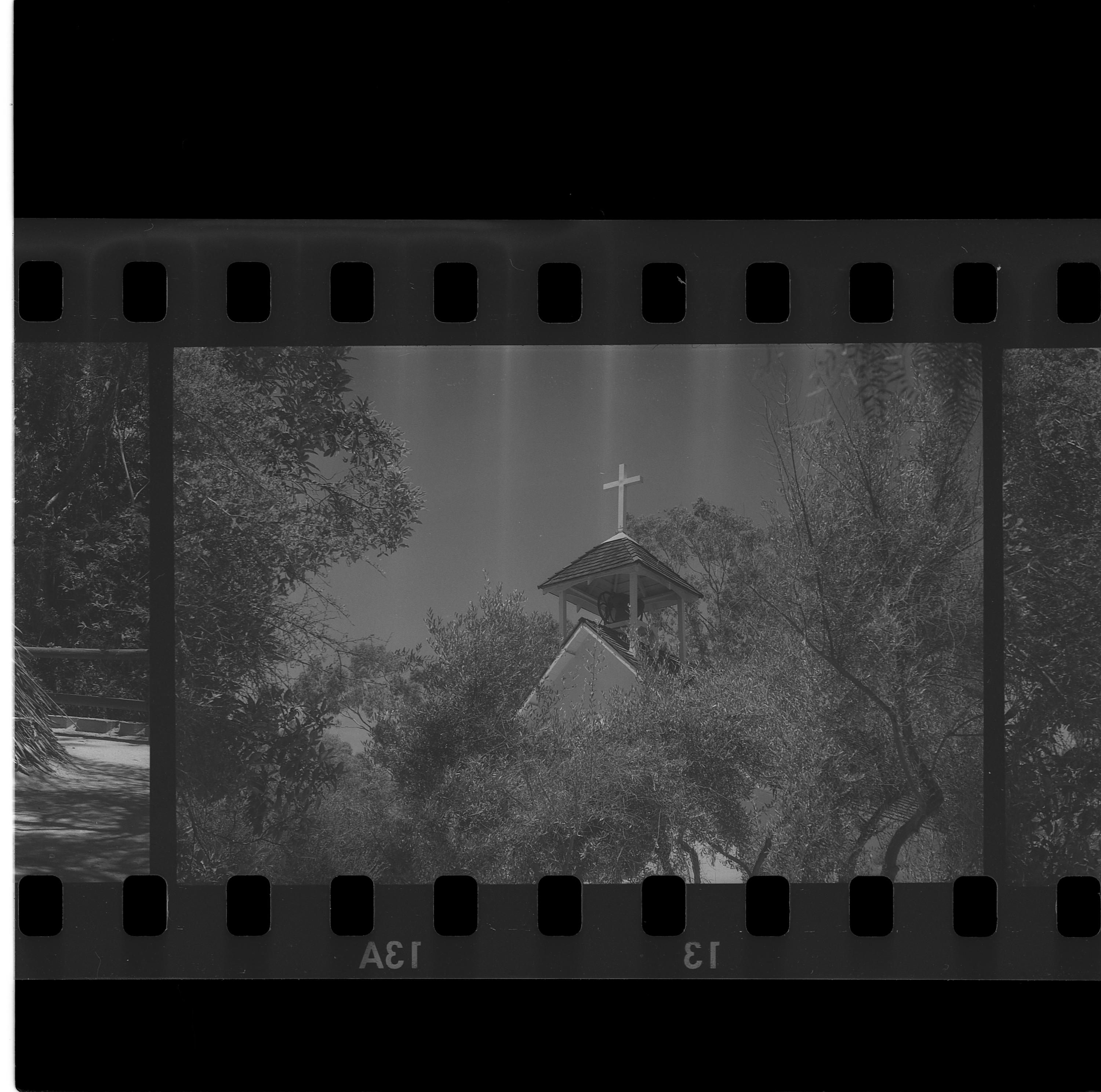

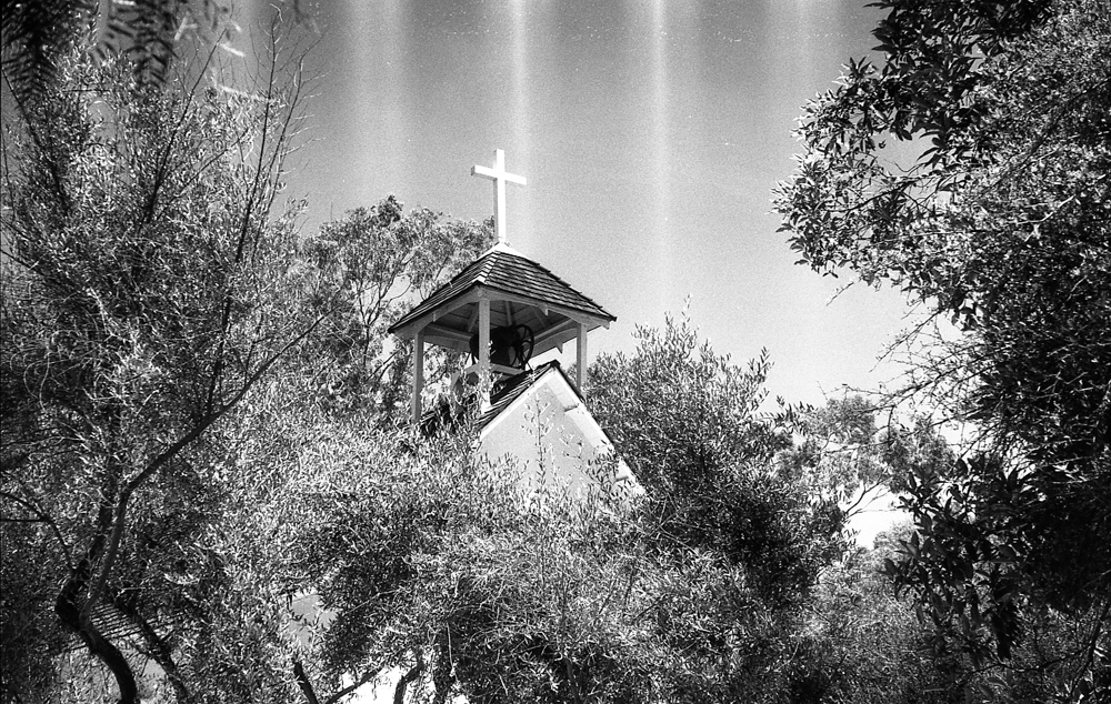

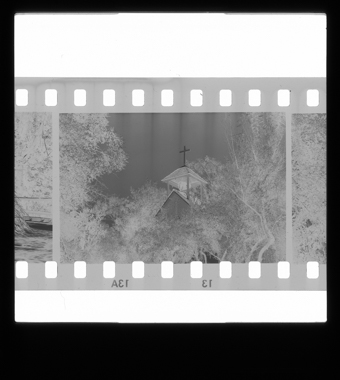

I've written to the manufacturer of R3 hoping for some help from them. Their directions for the R3 monobath call for NO AGITATION. In the meantime, I may split a roll and develop half with no inversions and no agitation and the other half with my usual inversions of 4 every minute following 15 - 30 seconds of inversions at the start

Certainly not surge marks, as they aren't opposite the sprocket holes.

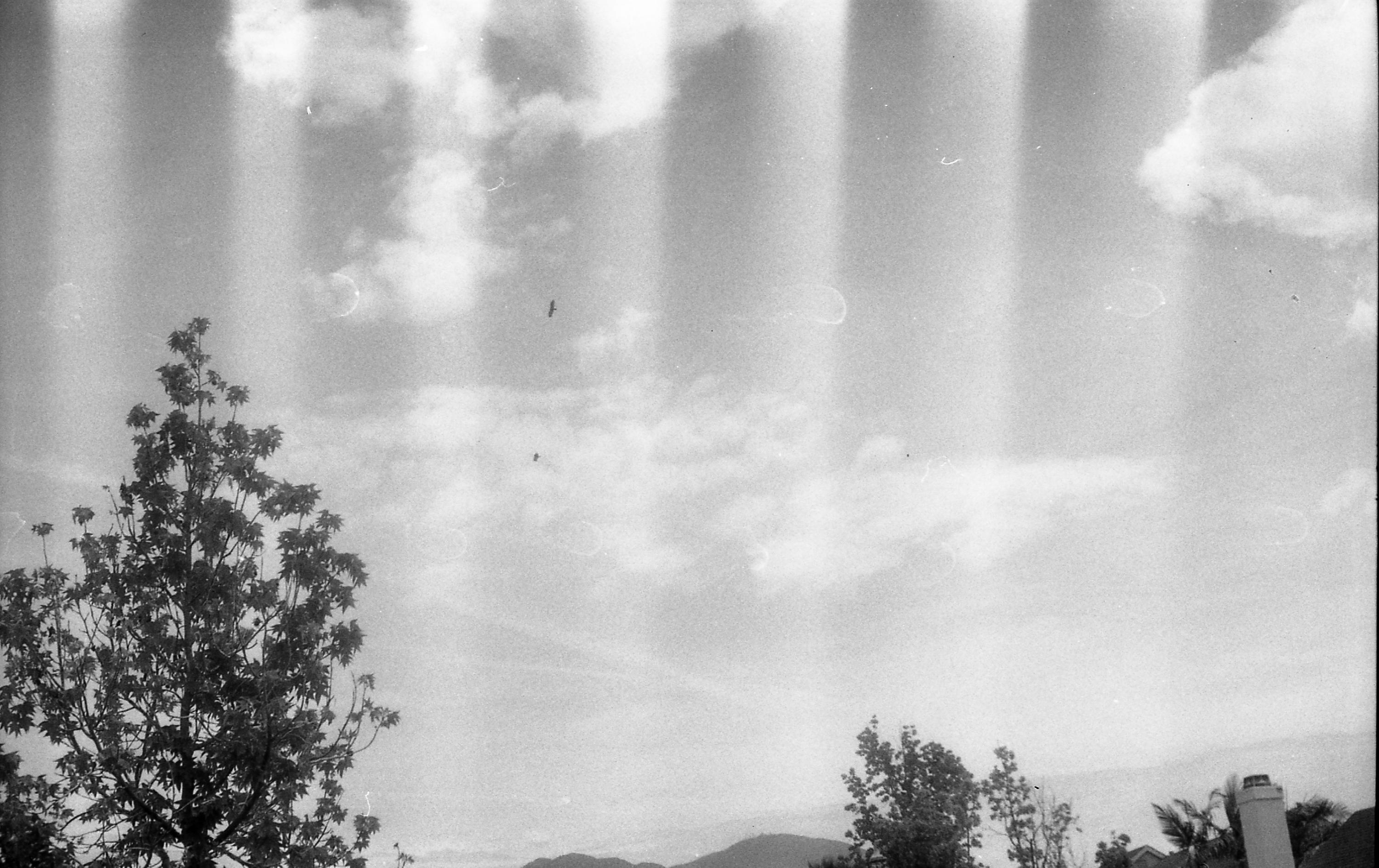

History repeats itself! New55 don't ship outside the US, so I made my own monobath according to Donald Qualls' formula - which should be exactly the same. I got the same surge marks from sprocket holes - on both sides of the film if I inverted, but just on the lower edge if I poured it in and did no agitation as New55 recommended. I adjusted the pH, ensured my ammonia was exactly 5% with a hydrometer, but couldn't avoid the surge marks on 400ISO films. 100ISO films were tolerable. The eventual solution for me was to use my old Rondinax tanks, where the film reel is on its edge, and so any drag marks will run lengthways along the film and stay within the unused border. It works so well that I have stayed with the technique for several weeks now. I have also used a Rondix tank with no film reel with perfect results. Today I discovered the limit of a litre of monobath - the ninth film was underdeveloped. I'll stop at #8 in future.

Chris,
I can still see some marks in some of your shots particularly in the sky on the lake photo.
But can you elaborate on your process with the rondinax? Timings? Agitation?

I wrote to the manufacture this afternoon and already received a reply.
"Try filling the EMPTY tank with warm solution, then insert the loaded reel rapidly but smoothly into the full tank.
No movement at all."

UPDATE on Agitation:
It's been demonstrated with 35mm in a Paterson tank that a gentle, swirling agitation in the first minute can eliminate the streaking. We are testing this out with rollfilms presently.
Careful temperature management is also encouraged. Uneven development can result from temperature differentials in the tank from pouring warm into cold.

Sorry, it's been a while since I was here. I use six minutes at 75-80º with continuous rotation of the Rondinax. I have also used a motorised version of the Rondinax, and a reel-less Rondix tank with success. With conventional tanks I have had stripes across the film with no agitation, and with lots of agitation. It is far more noticeable with a fast film than a slow one. Frankly, it is very frustrating, but when the monobath works it gives a lovely soft image with much less grain than is seen with conventional development. That has kept me at it so far, but I'm beginning to lose enthusiasm as it doesn't seem to be a reliable and reproducible process and I have lost a few films lately to it's vagaries. I'm sure it could be a dependable process, but it isn't quite ready for prime time yet. (It does amuse me when people tell me I'm being lazy by using it, and all I have to do to get good results is to buy some Rodinal.....if only they knew how much time and effort has gone into it so far!)
