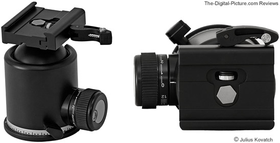

Those look good. Bear in mind that the Arca-Swiss plates, oddly, are sometimes a little looser in the lever-type clamps than some of the other plates. I’m not sure why that should be, but try them out if you can, or be sure you can return them
I have found this to be the case too. The issue is not that the bevel profile is different, but that the width between the two bevels on the QR plates varies ever so slightly between manufacturers (don't ask me why). If you have an Arca-Swiss lever clamp head though this is easily remedied by adjusting the thumbwheel which alters the distance between the two sides of the clamp. Other AS-compatible heads may also have such an adjustment, but I'm not sure.
edit: the below image shows the wheel I mean
