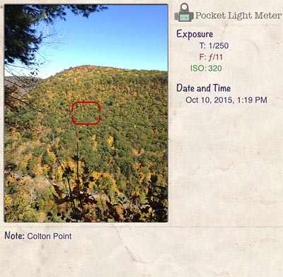

And for the obsessive sorts (come on now, we're photographers after all ...) some lightmeter apps can save a thumbnail and the readings -- you can even type in a note -- heck, you can even email it!!!
attachment.php
:munch: :w00t:

I will second the Pocket Light Meter app. It has worked quite well for me on many occasions.
R/
Dave

Yes, I've heard that. I have an iPhone 5c which is a fairly recent beast. According to Verizon, it was "free." (No, I will not show you our wireless bill!!!! :blink: )
I think the point is that most -- well "many" -- of us own/carry one anyway, photographing or not.
And agreed, I have the original Digisix which is pretty much my goto unless I'm getting into something serious enough to want the Sekonic L-508. I've actually not done a serious "scientific" test of the meter apps I have, but for scenes like my example it appears to work OK.
