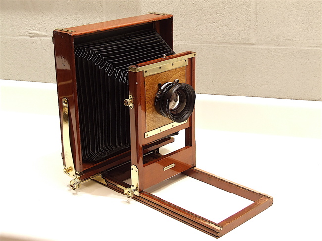

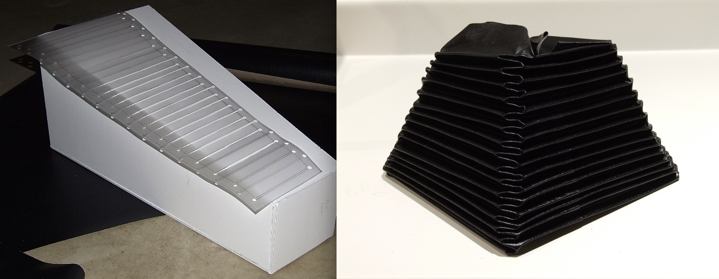

I found a Century 8x10 at the flea market for $5. I made a cheap and dirty bellows by creating all the ribs from a single piece of polycarbonate. I glued the 'rib assembly' to the inside of the fabric then cut the ends of the ribs apart. To make the cuts easier, once it was all glued down, I used a punch to mark the end of each rib. This got them all aligned in one step.
I made the mannequin using foamcore board and a glue gun.
