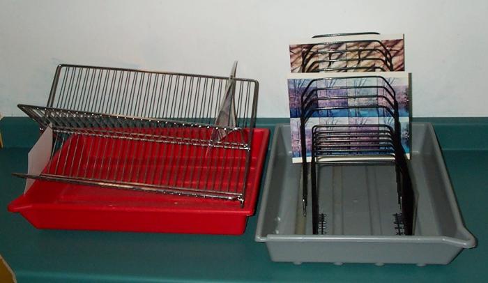

No. In fact, the only time I ever attempt to speed the drying of paper is when I need to evaluate it for color (for color prints) or exposure/contrast. Typically, I use the "high-tech" drying apparatus pictured in the attachment. IIRC, each of the racks was about $5-$10, not counting the trays underneath (which I clean up and use on the occasions when I want to make big prints).
FWIW, every source I've read (books, on the Internet, etc.) says that when air drying, fiber paper should be dried face down on plastic screens or something similar. I've recently discovered that I get better results using the same vertical drying position I use for RC paper.
