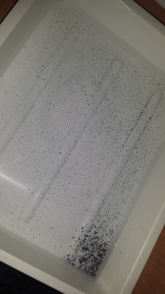

OK ... that'a my Fixer bath after fixing about 15 papers. Although I tried to filter it as best as I could you can see how it is !!!
Should I leave it that way or make a new one for the next time ? I am already printing right now but I am a bit concerned. I keep the mixed chemicals in plastic water bottles. The Fixing solution though gets so messy ...

As you've only fixed 15 papers and provided that the "bits " wash off the paper which they should in the wash then I wouldn't worry too much
I use a Nova Quad and because the trays are upright the bits fall into the bottom so are never seen until I do the occasional clean-up when the same black bits show up and in greater amounts that you show in the photo.
It might help if you use the recommended replenishment rate so instead of 1L and 70-80 sheets you pour out old fixer per whatever the rate is and top up with fresh. This might remove the bits but as I said I don't think that per se these need be of concern. Just don't try and over-use fixer.
Incidentally if you are using RC paper then I don't think that HCA is required but maybe others will chime in here. I certainly haven't bothered with HCA for RC paper. It helps remove fixer that otherwise can get into FB paper but RC paper doesn't neeed it. A 2-3 minute wash in running water is fine.
pentaxuser
What is your fixing time? Looks like you left the prints in long enough to remove silver, or you left the fixer in the tray for a few days. I use a neutral fixer and never have that issue.
I use illford fixer and I surely didn't use that mix for more than 15 papers. I fix for 1 min when I make the final print that will keep and about 30 sec if I make a test print.

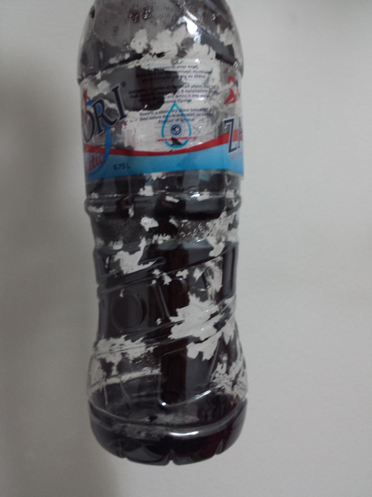

These print were made in two separate sessions and the mix was kept in a plastic bottle. I also attached a pic of the bottle so that you can see how it looks like !! Basically, all that silver that is on the bottle's wall fall in the tray when I empty it.
I keep all my mixed solutions in bottles like that, not in an open tray.
The "bits" do wash off but still ....
This is the second mix I make since I started printing. The bottle looked like that from the first one, just the second day it was in the bottle !!
