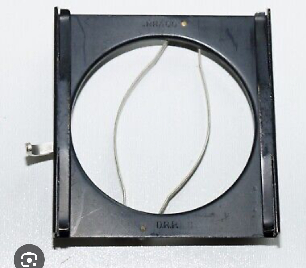

It should not matter that there are no threads, many rear filter holders clip on or are attached to the rear of the lensboard
