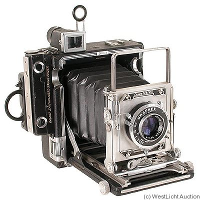

How about a graflex camera with 4x5 sheet film?
Closed, it just looks like a box. Open it and it's steam punk magic.

Press-type cameras also had a different spread throughout the world.
With more modern smaller cameras being used much earlier in some parts.
