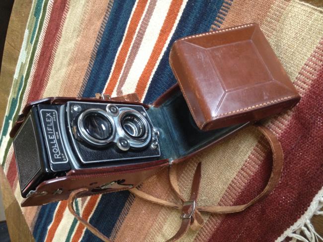

A much older camera may also be a (120) roll film camera with no canister, just film moving from the supply roll completely to the take up roll within the camera. Paper backing makes it light tight.
