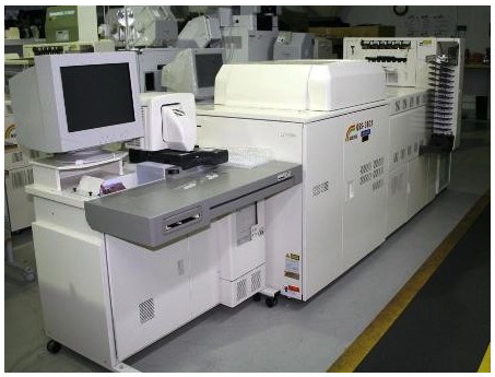

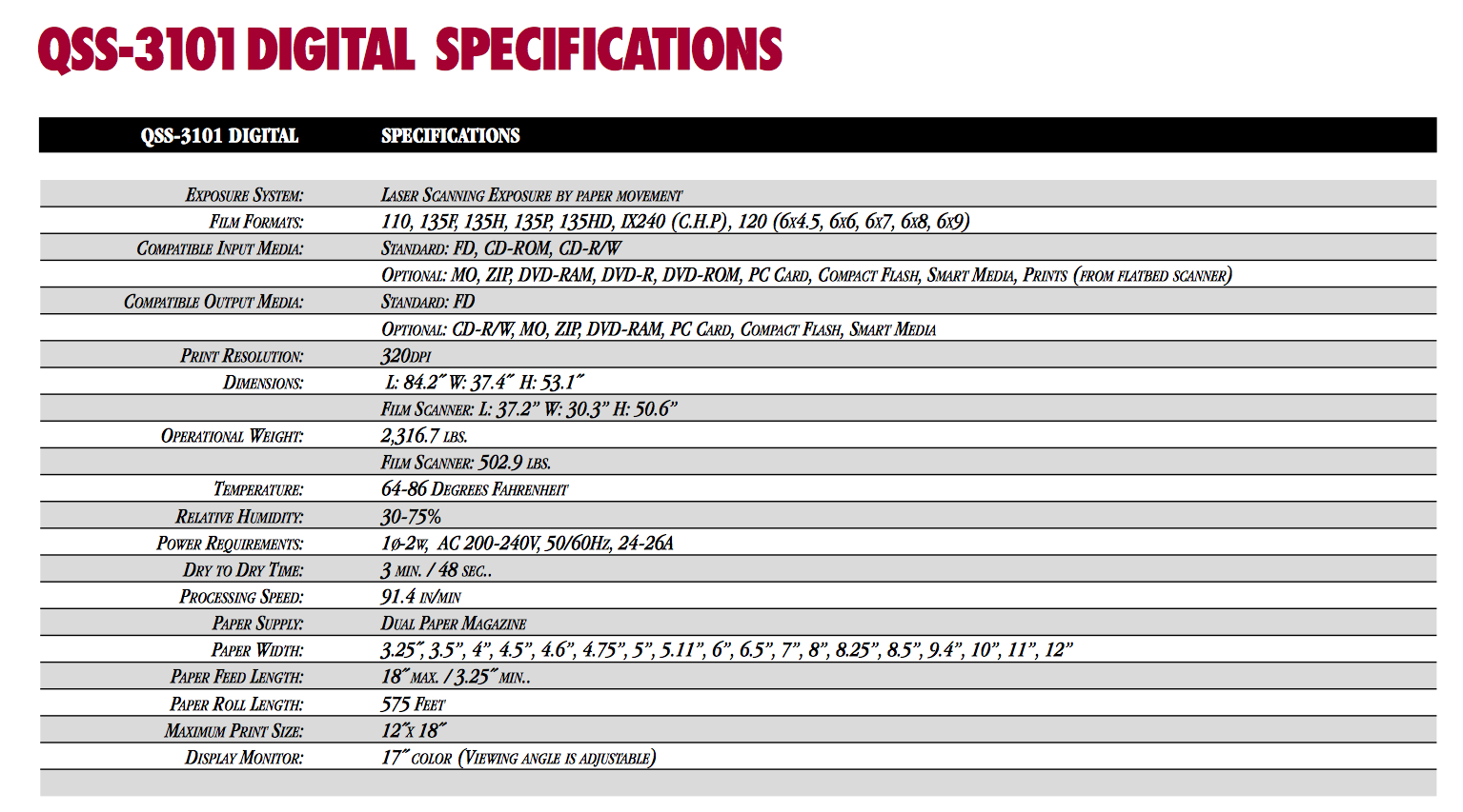

The Noritsu 3101 will do 110. It has a digital pathway, but prints to analog RA4 paper, like a Durst Lambda printer. That is, there is no optical enlarger in the unit.
