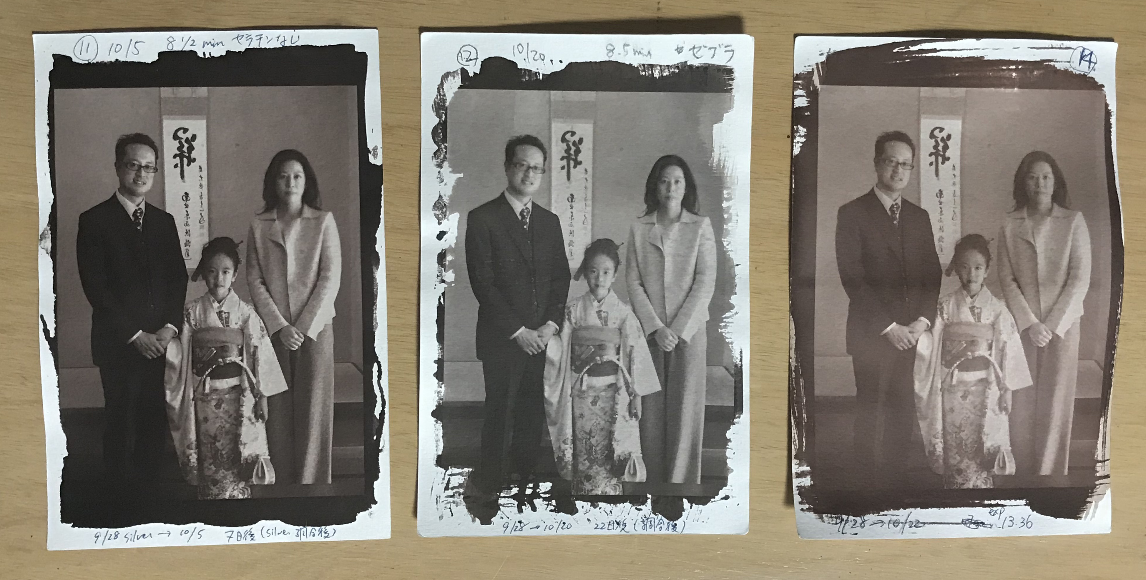

I have some questions regarding the chemicals and sensitivity in salt prints.
Please refer to the attached photo.
All three prints were made using silver nitrate solution and sensitizer (ammonium chloride) that were both prepared on September 28. (The washing and fixing times were the same, and no sizing or toning was done.)
The silver nitrate solution is stored in an amber bottle, and the sensitizer in a clear glass bottle, and I applied the chemicals to the paper just before printing.
Left: Printed on October 5, exposure time was 8.5 minutes
Middle: Printed on October 20, exposure time was 8.5 minutes
Right: Printed on October 22, exposure time was 13.6 minutes
When looking at the prints in person, the one on the left seems the most properly exposed.
Questions:
  1. Which chemical, silver nitrate or the sensitizer (or both), loses sensitivity over time?
    Although the left and middle prints were exposed for the same amount of time (8.5 minutes), the middle print is clearly lighter.
  2. Which chemical, silver nitrate or the sensitizer (or both), results in lower contrast as it ages?
    I gave the right print a longer exposure time to match the density of the left print. The midtones (like the walls) appear about the same, but the right print clearly has less contrast. The blacks are not as deep, the highlights don't stand out as much, and overall, the print looks muddier.
If anyone experienced in salt prints could provide some insight, I would greatly appreciate it.
Thank you!
They're both stable.
How are you exposing your prints; i.e. what kind of light source? Have you verified that your light source is consistent? Note that e.g. LED light sources tend to become less efficient as they heat up (example here), while fluorescent tubes can show the exact opposite effect.
Moreover, differences in humidity of the paper during exposure as well as differences that arise during coating (esp. resulting in a changed ratio of chloride to silver) can explain what you're seeing.
Mind you, I'm hesitant when it comes to using ammonium chloride because of inherent problems with fogging. Sodium chloride is in my view a better choice for salt prints.
Thanks for the comments!
Hmm. Is my understanding correct that a silver nitrate solution or sensitizer that is somewhat old (only a month) will not affect the contrast? Also I store the silver nitrate solution in an amber glass bottle, but it’s not completely lightproof. Is that a problem?
I'm using the same type of LED as shown on your website (only 1 unit of 150W, 30cm above the paper). However, in the previous photos, the left and middle prints were exposed for the same amount of time (8.5 minutes), but the middle one is clearly lighter. For both, the sensitizer was applied with a brush, and the silver nitrate with a glass rod. Could the lighter result be due to using too little silver nitrate, if I was being a bit stingy with it?
Is it okay to use regular sea salt, or should I buy sodium chloride from the pharmacy?
That's correct.
Silver nitrate by itself does not degrade. It's still best to store it dark and cool. My working stock is in a clear glass bottle and I keep it in a simple closet; nothing special. It lasts indefinitely this way.
Yes. Variations in the exact amount and ratio of chloride to silver are likely to occur when hand-coating. It's best to work in a very consistent way and carefully measure out the amounts of both the chloride and the silver solutions.
The ratio between silver and chloride has a strong influence on printing speed, contrast and image tone.
I use sodium chloride from the supermarket; it's best to use the non-iodized kind. The cheapest tends to be the best, at least around here.
People have made very pretty prints with salt literally taken from the sea. In fact, seawater diluted approx. 1+1 with tap water should make a decent salting solution as my own salting solution is 1.6% NaCl and seawater is around 3.5%; my silver nitrate solution is 11% by the way.

That's correct.
Yes, that was what I thought as I store my silver solution for a wet plate in a clear glass bottle.
This is something that I never thought of. I wasn't really consistent in terms of the amounts of both solutions.
I found a package of salt at home. This is a common salt sold at a regular supermarket. I don't think it is iodized, so it should work fine. Let's see how it goes.
Thanks!!
Then this is most likely the main factor you're running into.
Refer to page 26 of Ellie Young's thesis: https://core.ac.uk/download/pdf/15614798.pdf
Note how low silver:salt ratios result in weak prints.
Give it a try; it'll likely work OK. There's a tiny bit of calcium sulfate in there apparently, but I don't expect it'll be enough to pose much of a problem.
Note that when doing salt prints, I always add a drop of 10% citric acid to every ml of silver nitrate. This eliminates fog.
If you haven't done so yet, I'd recommend doing a fogging test that determines whether the whites in your print clear OK. Sensitize a piece of paper and then exposure part of it to an image, while masking another part with an opaque material. Preferably mask an edge so you can see the transition of the sensitized part into unsensitized paper. After processing, the masked area should have cleared to pure paper white with no difference visible between the unsensitized edge of the paper and the masked, sensitized area. If you do see a difference, you have some fog, which ideally should be eliminated.
Many people who make salt prints don't do this fogging test and as a result run into problems with longevity of their prints (due to insufficient rinsing, fixing and washing) or are limited in the tonal scale since their whites are never really white; the prints will always remain a little bland.

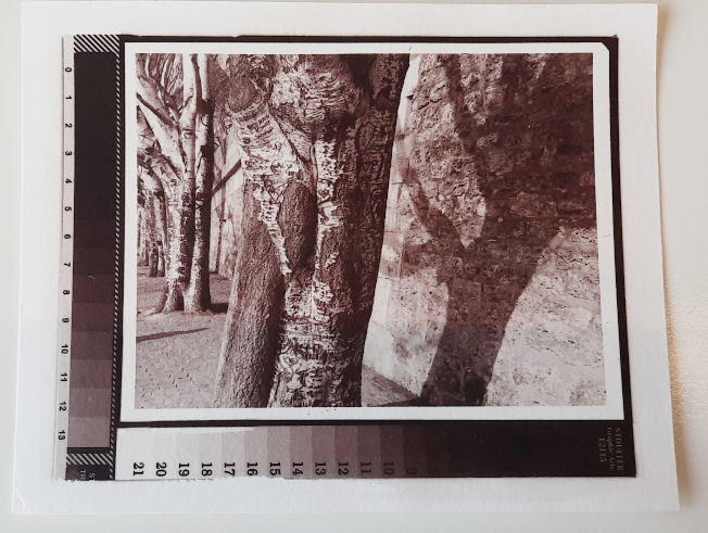

Here's a small test print I made a few days ago:
Note that there's a tiny bit of fog along the lower edge on the right half of the print (below the darkest steps of the Stouffer); in this case it's due to exposure through the rubylith masking material I used (given enough exposure, you can actually print through it!), but the white edge around the image itself is a pure paper white with no stain. (The image is a 35mm negative I enlarged to 4x5" xray film and reversal processed; the image border is extremely dense as a result.)
This print was partially gold toned; dmax is around 1.35logD (darkest patch top left). By comparison, untoned Adox MCC112 matte silver gelatin developed in ID62 maxes out at around 1.45logD.
I've said it before, but especially when just starting out, establish a process that enables you to reliably hit the full tonal scale from the deepest feasible black all the way to paper white. Only once you've figured that out, start linearizing your negatives. Optimizing your digital negatives before you've figured out the printing process itself is a waste of time.
This is super helpful information, thank you as always.
My silver nitrate solution is 11%, and the Ammonium Chloride solution is 2.3%, so there doesn’t seem to be an issue with the chemicals themselves. However, I hadn’t considered applying the same amount of each solution to the paper, which might have caused the variations in tone and contrast in the prints, as you suggested.
The weak contrast in the final print might have been due to the amount of salt solution applied being significantly less than the silver nitrate, which relatively weakened the concentration of the salt.
Initially, I was applying the silver nitrate with a rod (I do it on a flat surface), but it wasn’t spreading evenly, so I switched to a brush. I’ll try to match the amount of silver nitrate and salt more closely this time.
The gradation is excellent. Is this paper cotton paper? The surface looks relatively smoother than the type of paper that I use. I need to get some new paper as Hahnemühle Platinum Rag is not currently available. I've ordered it though.
I am going to receive the Stouffer step wedge soon. When printing just the step wedge, you can’t capture all the tones from black to paper white, can you? What you’re saying is that I should first find the time for the darkest black, and then look for a state where I can see separation from the darkest black to the next gray, correct?
I suspect that for a 1:1 ratio that's a little high on chloride. It's something you should test to see where the optimum is.
It's a 50% rag, 50% wood-free paper. It's pretty cheap stuff really, but works surprisingly well. I don't think it's sold in Japan, but as always with paper, try a couple of papers and then settle on something you like and that works well. Every paper responds differently to processes like these.
No, in my experience the tonal scale is around 2.25 or so, which is about 15 visible steps.
Yes, correct. That would be your base exposure. You should test this with an empty sheet of inkjet transparency/OHP film because you'll always print through that film, too. The film absorbs a little UV; it's usually something like half a stop or so, so it's significant.
