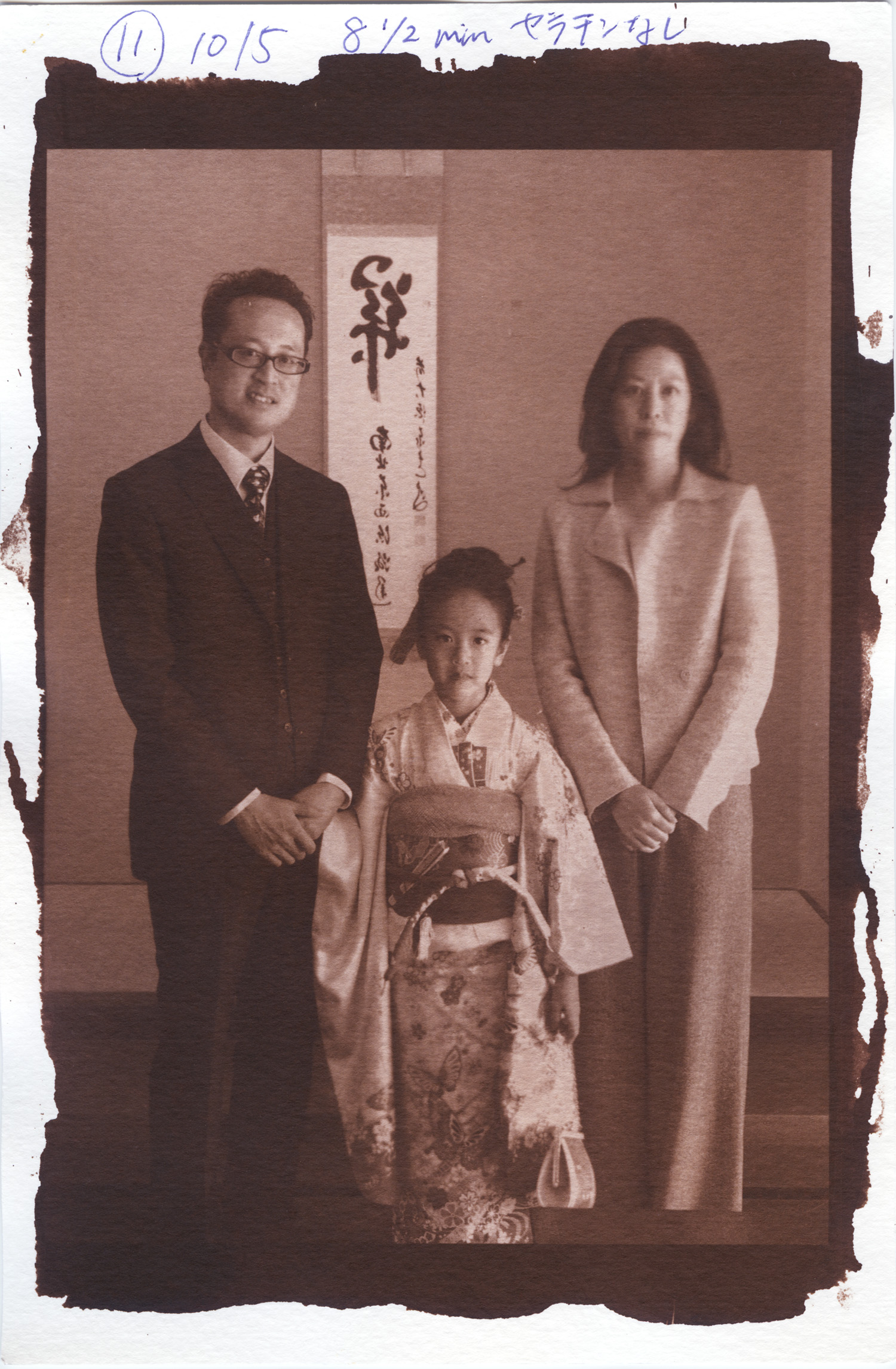

Recently, I started making salt prints by contact printing from digital negatives. The attached images are the results. For the sensitizer, I am only using ammonium chloride and distilled water. I plan first to understand salt printing with digital negatives and then challenge myself with printing from wet plate negatives.
About the blurriness (A.jpg)
In the digital negative used, all three people are in focus, but in the print, the face and upper body of the adult woman on the right are blurry. However, her hands do not appear to be out of focus. I applied silver nitrate using a rod, but since it didn't cover the paper completely in one pass, I went over some areas multiple times with the rod. Could this method of application be the cause of the blurriness?

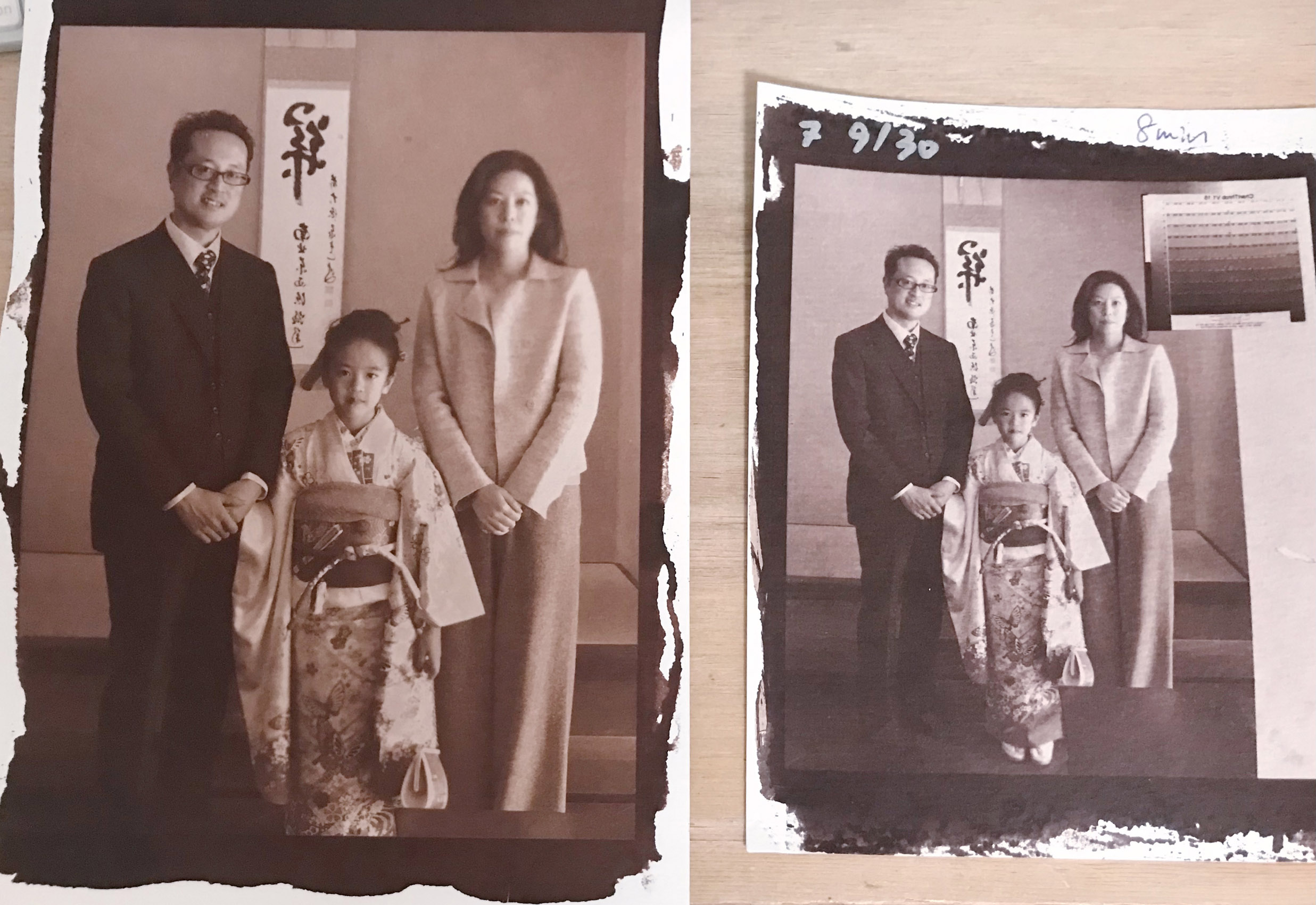

Fixer deterioration (B.jpg)
In the image I attached, the print on the right was fixed on September 30, and the other on the left was fixed on October 5 (today). I haven't used gold toning yet, but there is a noticeable color difference. The fixer (hypo) was made on September 30 and has been used continuously. I’ve processed 11 salt prints, 4x5 inches and 5x7 inches, using 200ml of fixer. Could the color difference be caused by the fixer weakening over time?
No. The problem is poor contact between the negative and the printing paper, combined with a non-collimated light source. Step one is to review your contact printing frame and ensure it works well. A plain picture frame with some clamps generally doesn't cut it.
Yes, but to me, the print on the left looks like it was likely better processed than the one on the right. The one on the right shows substantial highlight staining, likely due to inadequate washing before fixing, inadequate fixing and/or inadequate washing after fixing. Salt prints take time and care to process properly!
Start by fixing the contact frame issue.
Then ensure to make some prints in which you mask part of the sensitized area on the paper along the edges. This allows you to see how much staining you get. A properly processed salt print leaves absolutely no stain on the paper - there should be no difference at all between the sensitized, unexposed paper and the unsensitized paper.
A final note on contrast and maximum density: salt prints are kind of slow. You get the best result if you expose for the amount of time it takes to get a good, solid black (or very dark brown) after the print is fully processed and dried (ignore how it looks during processing; it goes off in all directions). Once you've established that exposure time, you'll have to adjust the contrast of your negative so that you can print the full tonal scale from black to paper white.
Do not be tempted to start with the negative and then adjust the exposure so you just get paper white. The result is virtually always weak prints with poor contrast and low maximum density. Going by your examples, I think you can expose for about half a stop more, maybe a full stop. But you'll have to then work on getting a suitable negative to match the process.
I'd also suggest to work on getting the printing process right first, only then start worrying about linearization of the digital negatives. In my experience it works best if you start by printing a known standard step tablet like a Stouffer; I personally like the T2115 because it's small enough to easily include on the coated area somewhere, and it's fairly cheap. I don't know what's available easily in Japan; I'm sure there are local equivalents.

In my original post, the print on the left, I washed it for about 5 minutes before fixing, after developing it. About the print on the right, the washing time was shorter than for the left one. That might have also contributed to the color difference.
Yes, that's what I expected. While the shorter wash time might give an initially appealing print, in the long run the highlights can become even muddier.
