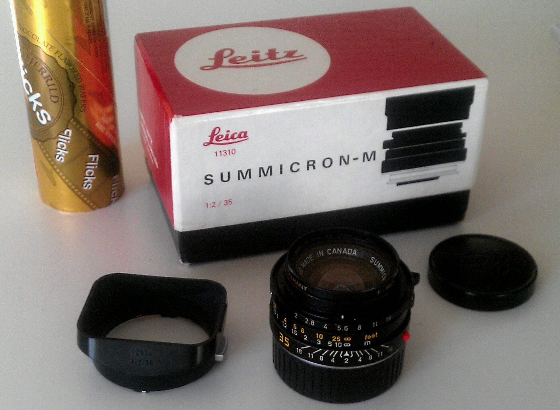

Not long ago I bought this 35/2 for my M6. It's said to be the 7-element "version IV', made from 1979-1996:
I should mention that the advantage of this lens is that it is the most compact of the 35mm Summicron lenses - it does not intrude into the viewfinder.

Amazing, I’ve been hearing that some lens block the viewfinder too so I want to make sure I make the right choice finding the right one. How much did those lens run you??

That lens was $1600. It is quick and smooth to focus; a perfect lens for street photos.
