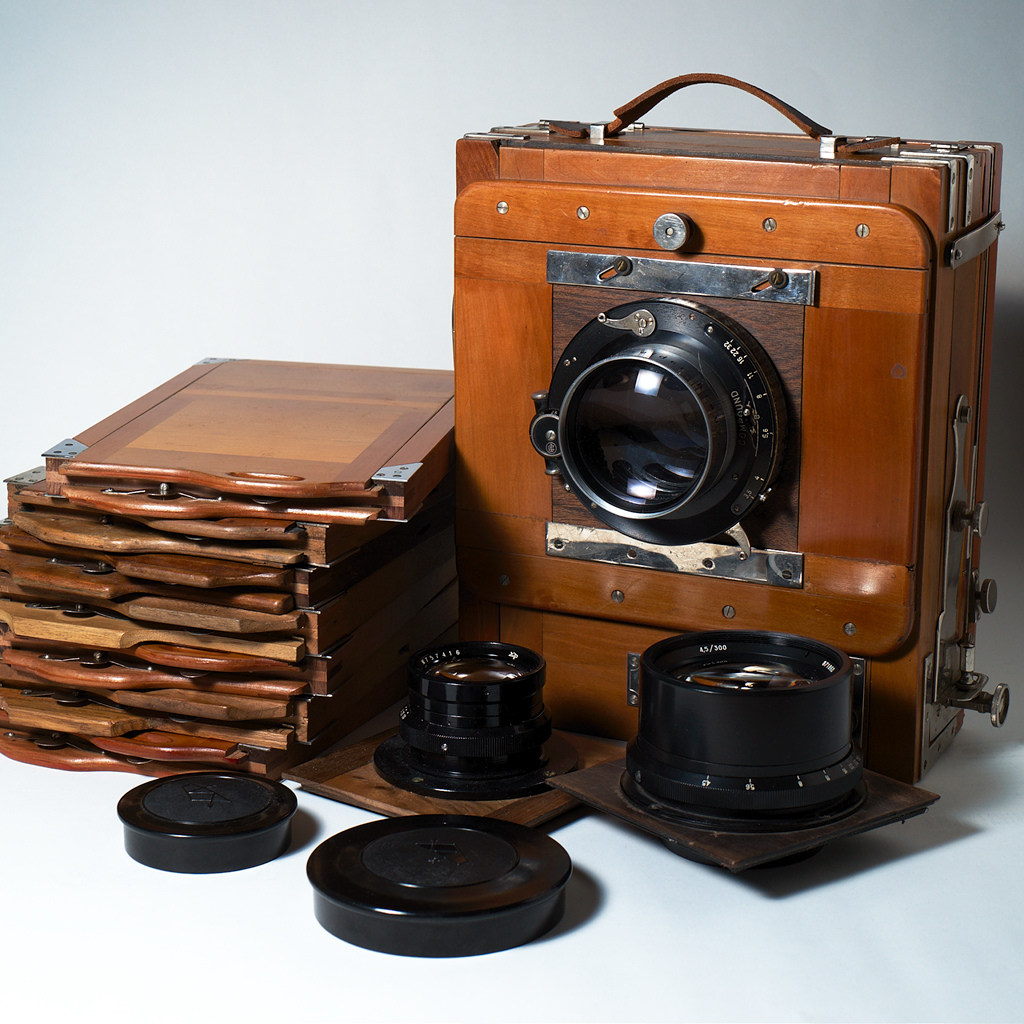

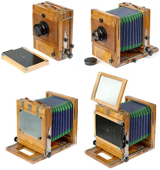

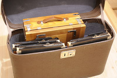

I also ordered MACO GENIUS film 17,8x24,0 (= cm, not inches) 120 sheets for $100 and Rollei Infrared 400S sheet film (4x5") 50 sheets for $60. I also ordered Maco Ecoprint, Ecostop and Ecofix to develop the Maco film. I never used these films but would like to experiment with it. I still have an old Russian FKD 18x24 cm camera (almost 7x10 inch) with wooden sheet film holders and my hat as a shutter.
camera-FKD-13x18-met-alles.jpg camera-FKD-13x18-group.jpg camera-FKD-koffer.jpg
If the Maco film works out fine, I'm gonna use these negatives for Bromoil printing, Salt printing and Gum printing.
