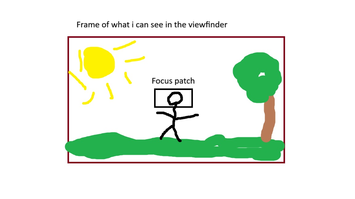

Hi Everyone,
So this is prob a newbie question but i cant find any details in all my searching. Just got into this hobby and i currently have a Kodak retina ii, i believe is the 014 version, however, as i am new to all of this, looking online through various post, reviews, original manuals etc, im a bit confused.
My question is when looking through the viewfinder, what section of what i see will be captured onto film? Is it the entire viable area when looking through the viewfinder, or just the frame of the focusing patch? There are no grids or lines in my viewfinder, just the small focusing box, and looking online, i get different info, possibly because of the multiple models.
Sorry for the dumb question but just not sure based on my research. Any insight will be much appreciated!
It would help if you could show us some photos of your camera - there are a few people here with lots of Retina knowledge, who can help you confirm the version.
If your camera does not present with bright lines in the viewfinder, it usually means that the entire area visible in the finder corresponds substantially with the image that will be recorded on film.

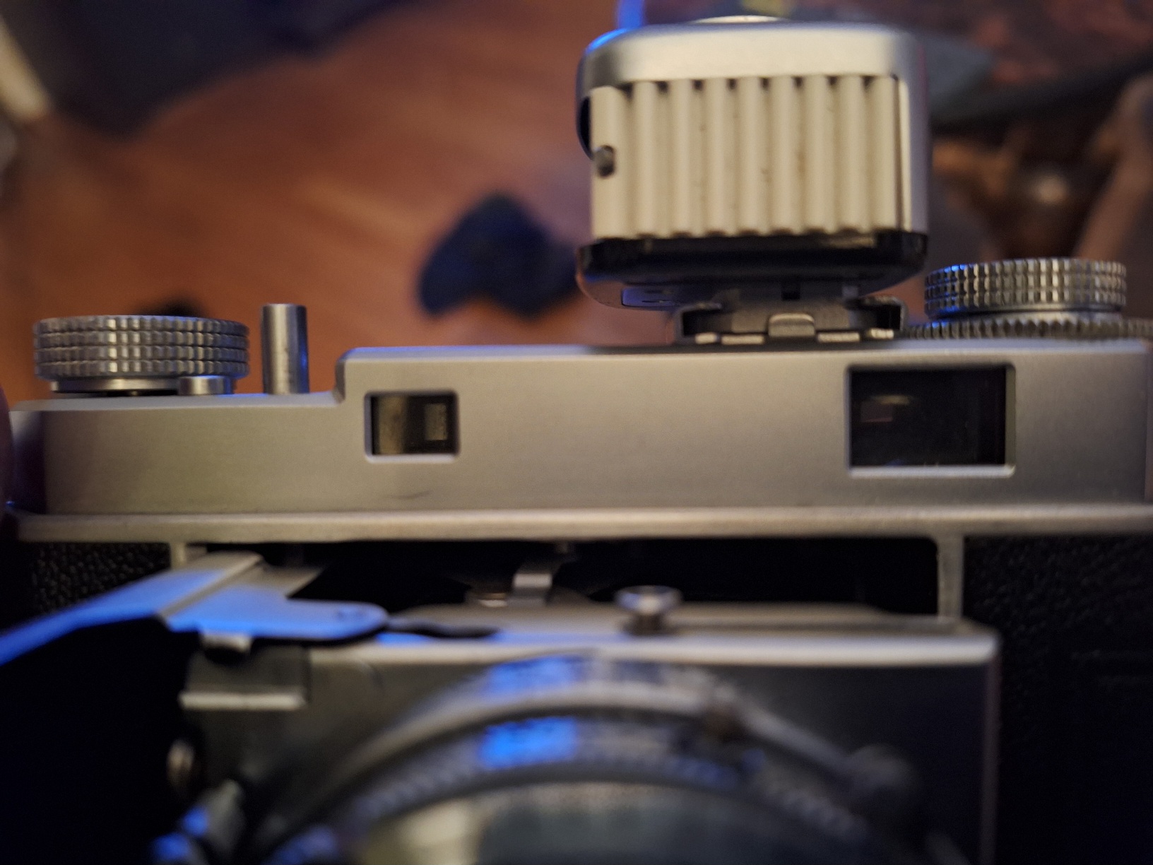

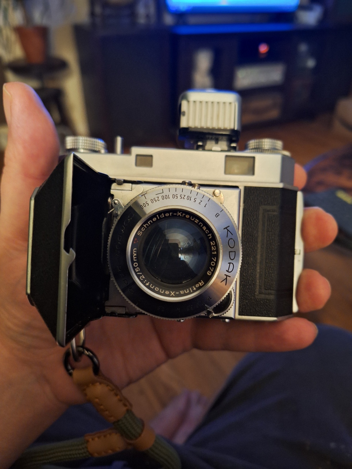

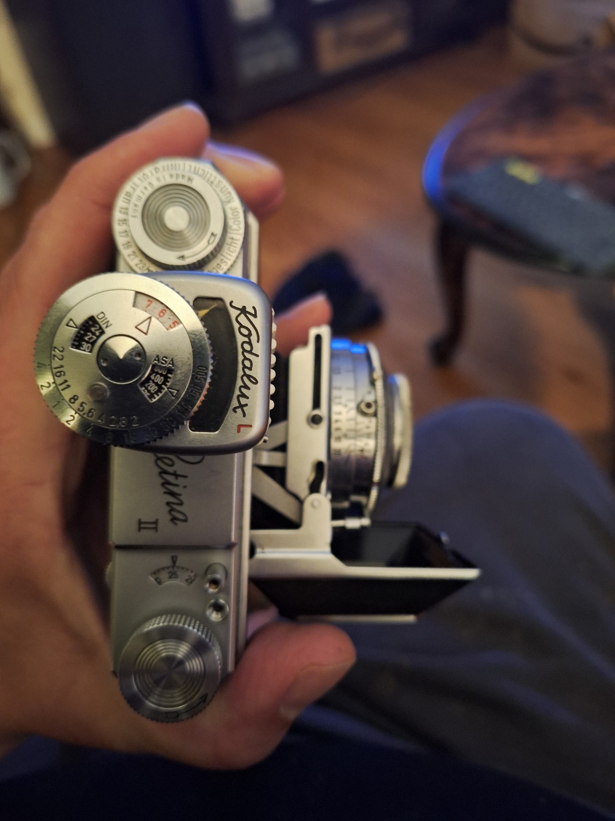

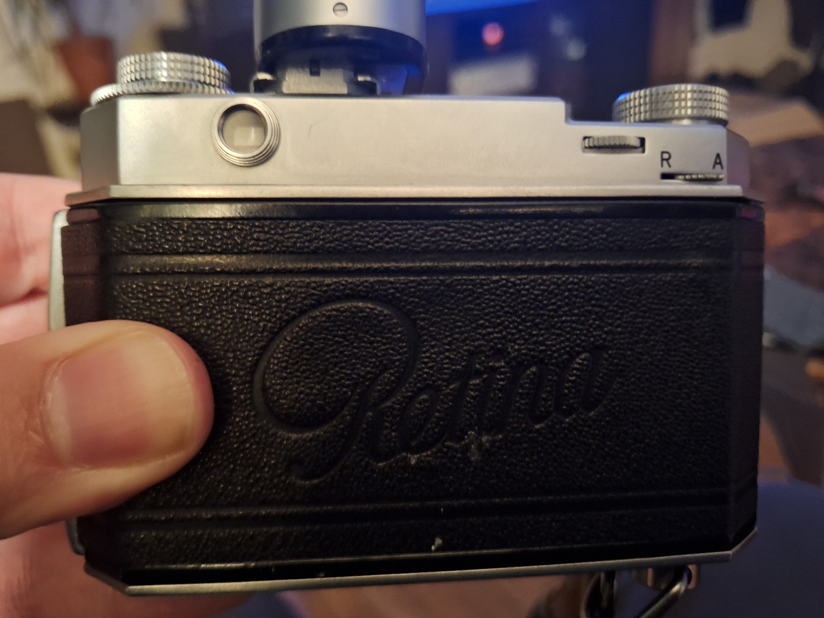

Hi Matt, thanks for the insight, here are some pics. From my understanding, the fact it has a "film type" wheel makes it a 014. Also is a pic through the viewfinder, not sure if this helps or not.

It is probably the 014 version - that looks like a PC flash socket - but even if it is the 011, the viewfinder would perform similarly.
With any of these cameras, it will serve you well to take some photos, because viewfinder cameras always present at least a small difference between what appears in the finder and what shows up on the film. At least some of those differences would not have presented a lot of problem for the large number of photographers who used these cameras to make mounted slides - the mounts always blocked a small portion of the image.

Yours is indeed a Retina II, type 014.
