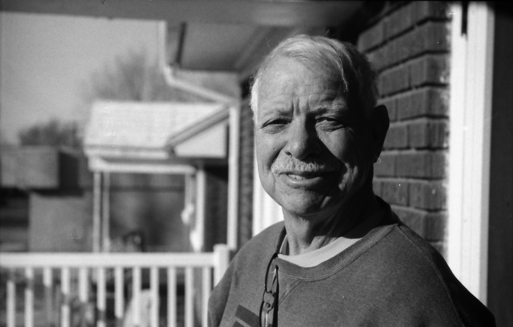

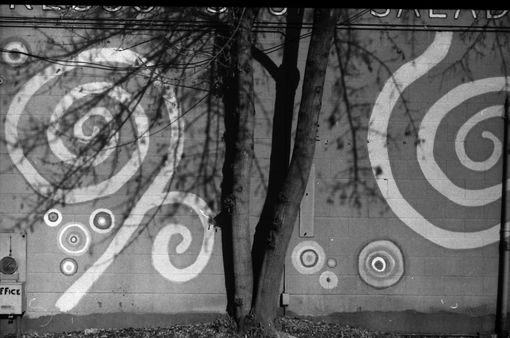

If you're shooting film that old, then it's best to throw development charts out the window, no matter film it was to start with and how well it's been stored (fridge, freezer, room temp).
I recommend shooting old film at half box xpeed and developing in Caffenol-C-L, the most common other recommendation is HC-100 dil B.
I have some plus-x here of indeterminate age, no clue how it was stored, but at least 20 years, maybe more, and it came out fine with standard development in d-71 1:1. Why just hc 110?
