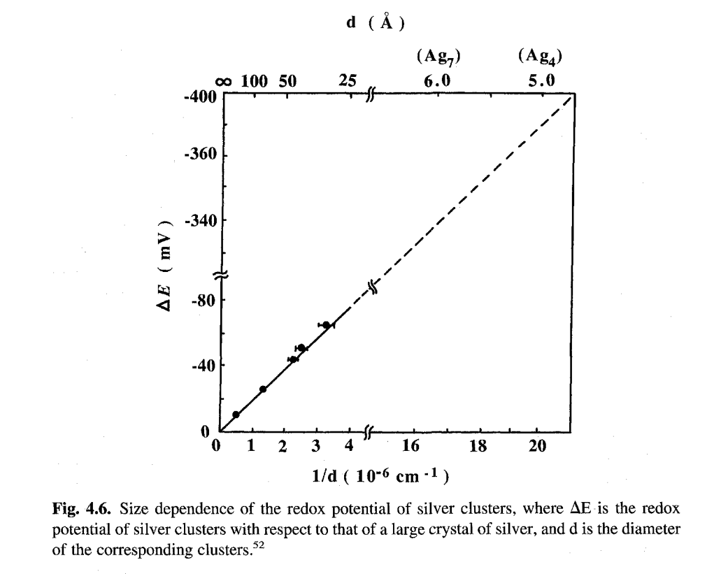

In his book "Photographic Sensitivity Theory and Mechanisms", Tadaaki Tani published a graph of required reduction potential dependent of latent image cluster size:
The label 1/d means inverse diameter of latent image center in µm, and a number estimate for silver atoms is printed on the top rim of the frame. Ag7 denotes a cluster comprising 7 silver atoms.
Nope, it's not. A single metallic silver atom is neither stable nor developable, but as soon as you put more than two silver atoms together (and they have a habit of coming together if they are created at roughly the same time and location), you get very different enthalpies for development of further silver
