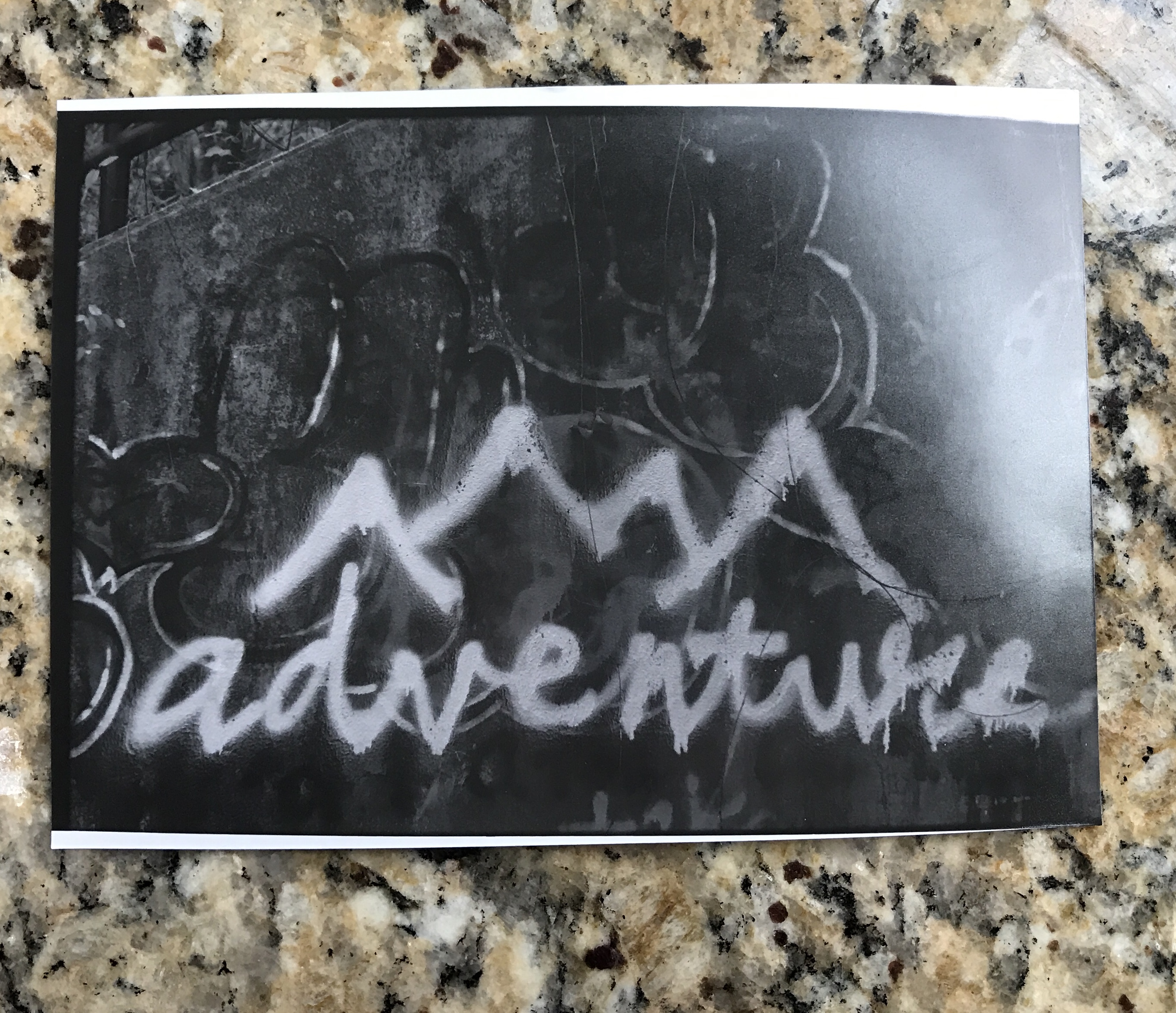

How do you figure out the exposure time when using an enlarger? Is there a baseline where you start and just do 5 or 10 second increment test strips? What is a "usual" exposure? Or is it just start out somewhere and then adjust? I'm asking because I printed my first picture today (Yeah!!!!!!). It's an added bonus for my general education-alternative-process/chemistry behind photography class for the students to cycle into the chemistry darkroom (it's brand a new course, we put the finishing touches on on the room yesterday).
I used a filter (ilford #2) and ended up with a 25 sec. exposure and developed Ilford Multigrade developer (25 sec).
thanks!

Here's the print. It was a wall graffiti on campus somewhere.

Your print looks like a good first effort, so well done! :smile:
Some good advice already given, but I'm wondering about your development of 25 seconds. Where did you get that time from??? Usually it's in minutes, usually one or two etc depending upon developer dilution. So I'd recheck the bottle and stick with that to ensure good future prints.
All I can think is that you thought the print looked about right in the tray and took it out and into the stop and then fix? This may have worked for you this time, but if your procedure is what I've described, future prints could loose a lot of detail and contrast. As I've said, read the instructions on the developer bottle again and stick to that time. If prints then come out a little dark or light, check and change the exposure / test print until you get what you want.

I wondered about the time in the developer. I started out at 1min - I took that from the Ilford website for the developer. The print came out nearly black. I didn't mix the developer myself (a student lab worker did) and I asked the lab coordinator about the concentration - and it was confirmed that it was 1:9. I also went and checked on the container, and it's written 1:9 (and it's hand written on it as well by the lab coordinator). I had the student dilute it further (making it 10:1) - but it didn't change anything dramatically. When the print was in the developer, went from nothing to an image within a second (like "whoooosh there it is" which I thought was odd). I wonder if I need to expose it for less time - and develop it longer? I will also make a new batch and see if it was the wrong concentration.
