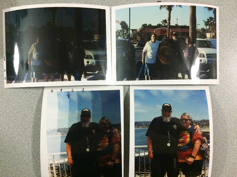

So, using the expodisc I got to a great looking grey within 5 tries. The resulting prints look great...the colors are spot on as long as I do Mick's method; shoot a reference expodisc in the same light as the succeeding frames. I also found that as long as the light is very similar, you don't have to shoot one as often. In other words...daylight sun today is about the same as daylight a week from now and it's possible to use the same reference frame.
The expodisc is by far better than what other technique I've tried. I tried averaging with the Colorstar, and doing spot readings of known colors, but the expodisc is as close to "automatic" as I can imagine.
It makes shooting color a pleasure. I just did these two prints this morning and all I had to do was do a test strip for density...the colors were perfect. Test prints on the left.
