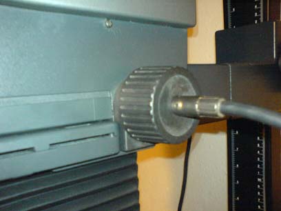

Hmm, that's interesting as I can't find mention of the focussing extension anywhere either. It certainly looks like it's a Kaiser part, but doesn't have any identifying marks. It's basically a flexible 'rod' with a knob on the end that fixes on in place of the centre fine drive focussing knob (my head, being a 6x9, is fitted with the 6:1 ratio fine focussing knob). Hopefully someone else reading this can elaborate on this ?

I have seen the fine focusing wands available for the Saunders/Omega LPL 4x5's, but that doesn't mean they will fit. Perhaps Durst have one that will fit. Kaiser seems to be "inspired" by Durst design. How does yours attach?
I have access to some pretty clever people in a metal fabrication shop who could probably help me out. But a description would help as a place to start.

I attached a couple of quick shots of the focus extension, sorry about the quality. There's a spindle coming out of the enlarger focussing knob that I assume the smaller fine focussing knob would have fitted on (the fine focussing knob is standard on the 6x9 and available as an add-on for the smaller enlargers. It simply slips over the spindle and is held by a tiny grub screw. I don't have the little hex key to hand otherise I'd measure the diameter of the spindle but I guess at this stage it's not relevant. So I guess it wouldn't be difficult to fabricate something similar. Maybe start another thread to see if you can get advice on whether another extension would fit. or where to get one from ?
