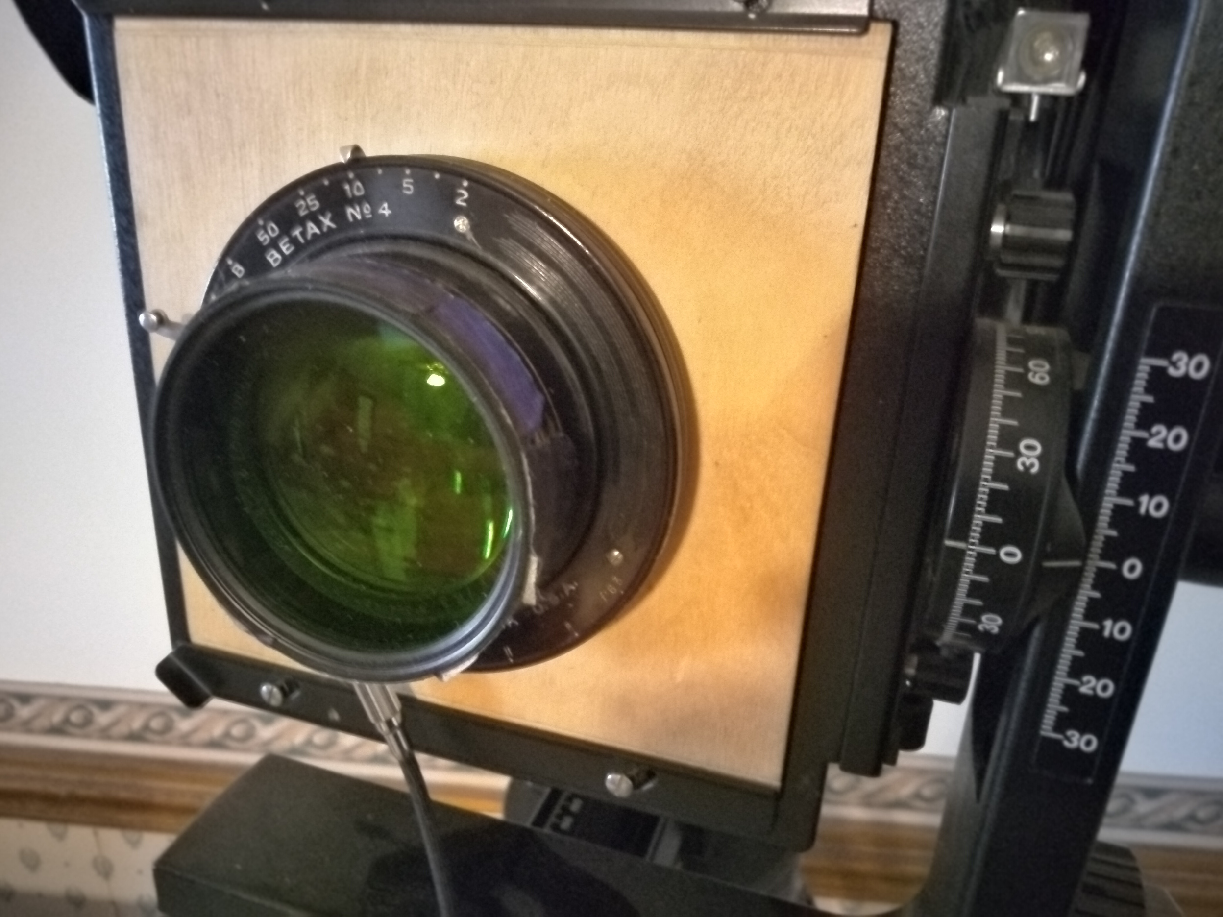

Thank you for these answers, although the droopy bellows don't sound hopeful. This is my Horseman, which allows me 1 1/2 inches of front rise or fall (3in. total). The lens I would be using for the Intrepid would be this old Bausch & Lomb 12 inch Tessar, which is all the lens I ever intend to buy.
My most oft-used lens on the Intrepid is my Turner-Reich Gundlach 8x10 lens (about 300mm) in the Betax shutter. It's neither the lightest lens I've used on this camera, nor is it the heaviest. (I just weight it: it's 1050 grams/2.5 pounds. The 240mm Symmar-S is only slightly heavier - not as heavy as I thought) I expect your Tessar in the Betax weighs about the same.
With the focus fully extended, you'll find that much weight is stressing the camera, but I'm not inclined to use the camera in this way.
