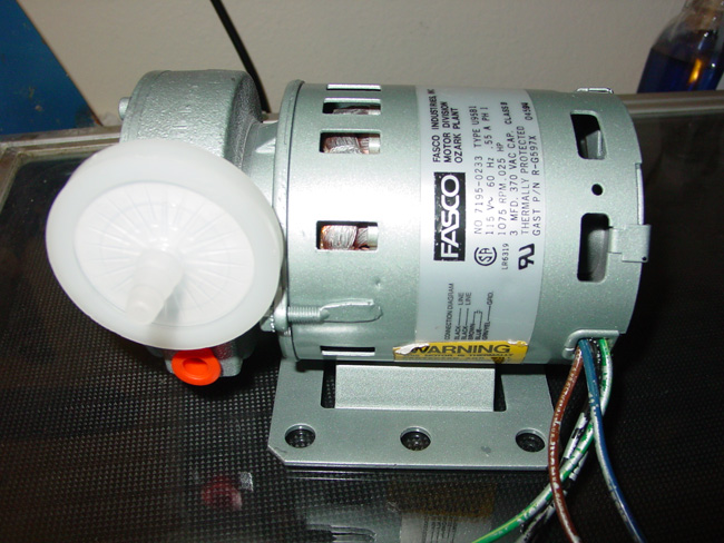

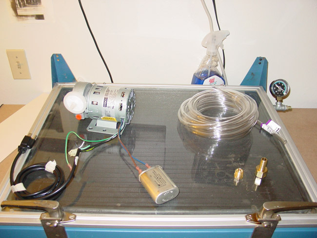

Yesterday I acquired a vacuum frame and pump from Jeremy Moore.
I believe I have everything thats needed. Went to Home Depot early this morning and got all the various items Id need to finish it up and getting it running. The home depot employee in the elec dept was convinced I was going to blow my hand off from the convertor or whatever is connected to the pump with the red and blue wires (see image below).

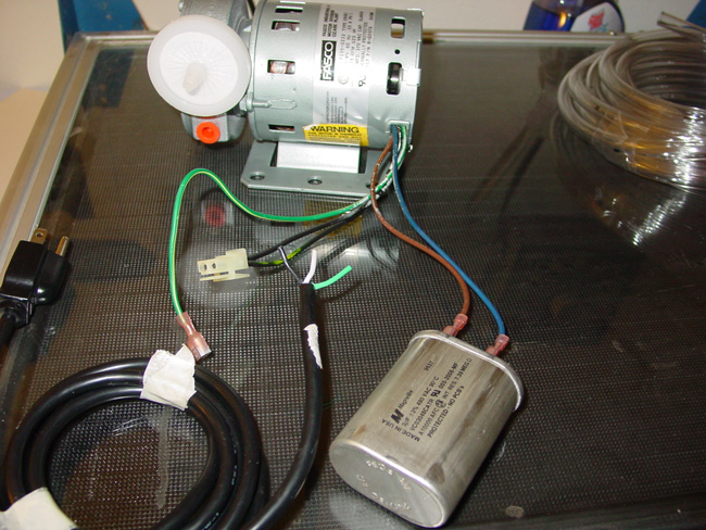

Does anyone have experience with this? He mentioned I should blanket it in rubber and also box it out so that it will be protected. Ill splice together the power cord and the white/black and green ground wires soon.

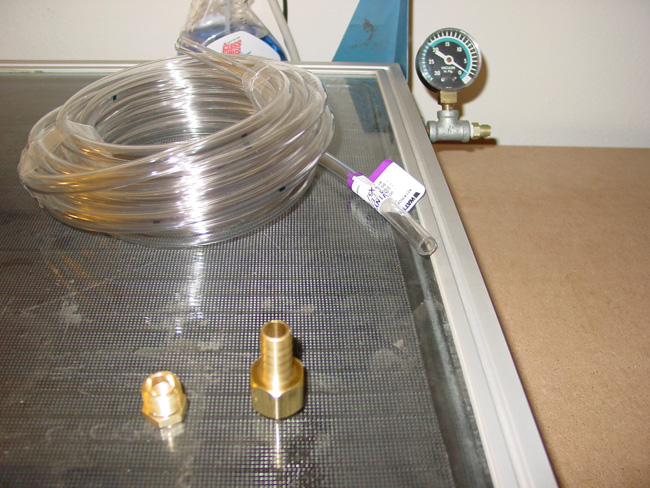

Also, is the tubing adequate or do I need the metal braided tubing because of the vacuum pressure?
Don Bryant sent over some images to Jeremy that he forwarded to me where the convertor is just lodged into the wood next to the pump. but given what the home depot electrical gent told me Im wondering if Im setting myself up to get my fillings shocked out.
Thanks in advance, Ive posted a bunch of digishots of the setup I have at present.

You'll get all kinds of answers here from duct tape to environmentally sealed and locked chambers. I'd land somewhere in the middle. I'd like to see every electrical connection properly made inside a secondary metal containment that is system grounded. The 110v cord should go in through a strain relief device and the rest should be inside metal. That way if your 4 year old curious cousin happens on to it, there's nothing he can touch and get hurt. Also if there was a failure the secondary unit offers some protection against flaming motors and blown apart capacitors. The yellow paint on one of the black conductors is very likely an identifier. I'd hook the neutral to that. Important! Plug your 110v cord into a GFCI receptacle. All should be well.

You have the capacitor wired correctly. Now just connected the AC power cord. Green goes to green, white will go to the black wire with the paint marker and black goes to the unmarked black.
You should be able to do a web search to on the pump manufacturer and get detailed info. All in all it is really simple to wire.
Since you don't have a matched connector for the one on the pump just cut that off and use some inline connectors. I would also tin the bare wires before using connectors. Wrap the connections with electrical tape and you are good to go.
Jim's comment about a strain releif is a good one, just bolt it to the wood you are mounting the pump on.

The metal can is a run capacitor. You can enclose it in a metal enclosure if you want...however a lot of commercial equipment that I have seen over the years does not have it isolated to ground per NEC standards. Run capacitors have lower MFD ratings then start capacitors. Either one would not cause any human health risk problems if it did fail. The only risk is touching an uninsulated conductor.
The electrical motor driving the vacuum pump is isolated to ground if you have the ground conductor connected intact through to the service panel. It will be isolated from the vacuum frame unless you have a metal to metal connection at some point.
The vacuum hose will probably not collapse with the vacuum that the pump will pull...If it does then you can get black vacuum hose for automobile use and it should work fine...but I doubt that you will need it.

You already got good advice about the electrical connections, so I just want to say that I don't think the plastic tubing you got will work with the vacuum pump; I think it will collapse. You of course could try it as you already have it. If it doesn't work, I recommend fuel injection hose that is available at any auto supply company. It is what I use and it works great. It's available in at least a couple diameters and you can get any length you need.

The clear tubing should be fine, just test it before removing the label. If the tubing should collapse use reinforced poly like the kind shown in my pix.
I also removed the frame brackets on the rear of the frame so it would have a lower profile to allow it to fit in my pizza oven UV printer. I also put a few layers of duct tape on the edges of the lower metal frame to make handling easier and safer.
I also would recommend that you place a stiff piece of material over the bed to prevent the bed from imprinting a pattern into the printing paper. I used a translucent piece of plastic sold at quilting stores. This also helps keep the bed free from lint. You will need to cut a hole in the plastic to allow the vacuum to evacuate air properly or you can just clip the corner.

First, The rubber tubing will be fine. I have used a piece of rubber for several years and I have no problem with it.
Second: It looks like the thing with the red and blue wires is a big honking capacitor. These are used to jump start the pump motor. THEY ARE VERY DANGEROUS. Capacitors are very common on these types of motors. A cap will hold a change long after the energy source is turned off. You should never touch a cap without first de-energizing it. It could kill you. When I set my vacumn frame up, I built a small plywood box to house cap and protect it from accidently coming in contact with anything else.
