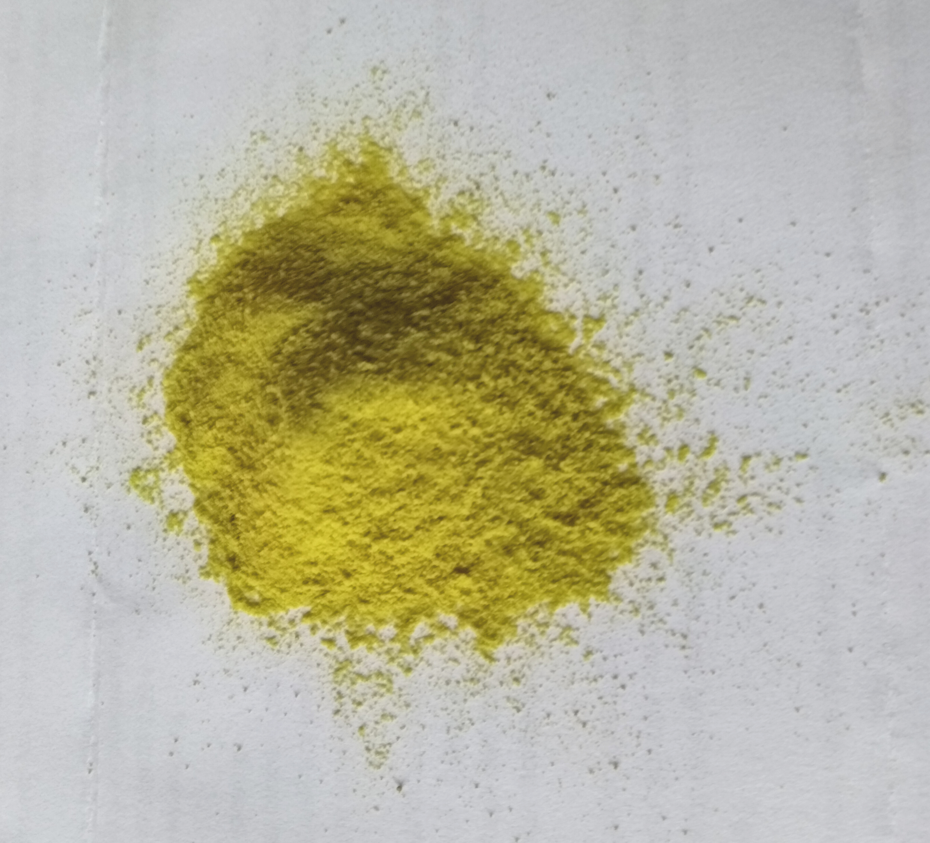

When you get back to this, please post a photo of the ferric ammonium citrate (FAC) powder you're using.
Did you weigh everything out correctly? Your FAC solution looks too concentrated to me. The color seems plausible for a very concentrated solution; more so than what you'd typically use for cyanotype. I prefer to store solutions in clear glass bottles and then store those in the dark. It helps seeing the colors better; it's easier to notice if anything's off.

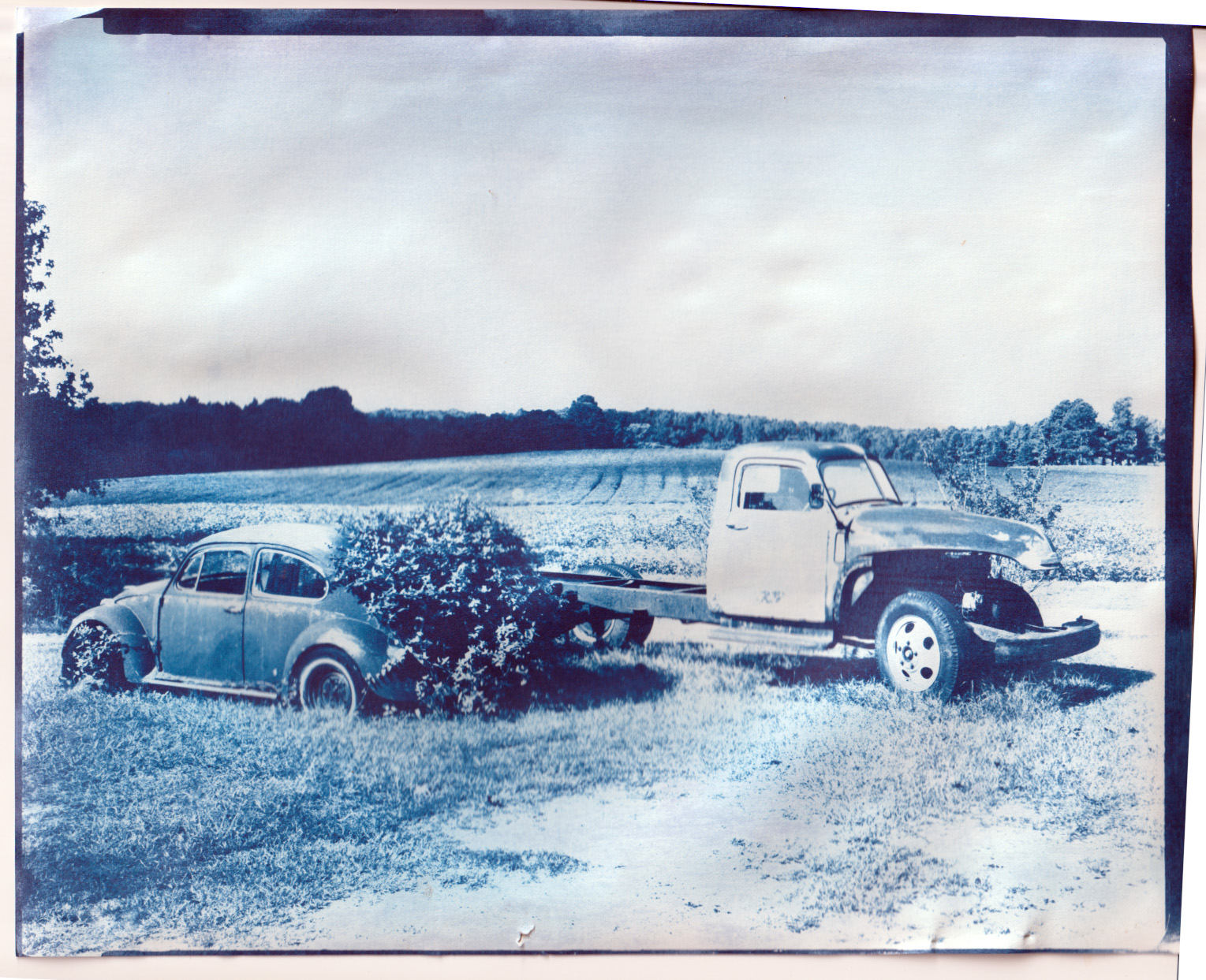

Alright!. Thanks. A lot has been explained. First, a photo of my FAC powder. I think it;s good. Today's work gave much better successes. The second photo is off an internet site where his paints on the paper with a dingy olive color like mine. I've worried too much about what color it is going on the paper, but my final results today say to ignore it. Now that I've read you guys are only going 10g to make 100ml, that would explain the lemon color I've been seeing on the videos. I've been doing 25g to make 100ml, and 10g on the ferricyanide. Here are today's prints. First my house on 4x5 xray film developed Rodinal 1:100. The negative looks like a textbook candidate for #2 Kodabromide. My print is on ordinary 67lb vellum bristol, like you could get at Walmart of Office Max. Kind of rough, and not very stable wet, but actually did pretty well. The second one of the junk cars was done on Fuji Green Xray film, 8x10, developed in Willi Beutler's.That negative was a bit on the dense and contrasty side. The print was done on the backside of some outdated 1961 Kodabromide single weight. I also made another print on 110lb Index (office max). That one did pretty well also. Yesterdays work using the backside of very old Portriga Rapid was a flop. The solution painted on going gray almost immediatlly. I guess it was contaminating my solution. Conclusions on todays work: Low contrast negs a hair on the thin side do best. I might note that yesterday was a cloudless, deep blue sky f/16 day. The paper only needed 5 minutes in the sun. Today was an overcast f/8 day. The house picture took 20 minutes, and the junk cars took 45 minutes. (still not enough) Looks like I might be getting somewhere. Although I don't like brushing on the thin runny solution. I can see the lack of uniformity in my prints. I wonder if there is a way to thicken-up the solution and apply with a roller. Thanks for all the tips. And the patience and understanding. I'm one who sticks with things and doesn't give up.

I can’t really see what kind of brush you are using but considered trying a cheap hardware store throwaway foam brush.
Congrats on figuring this out and making progress.

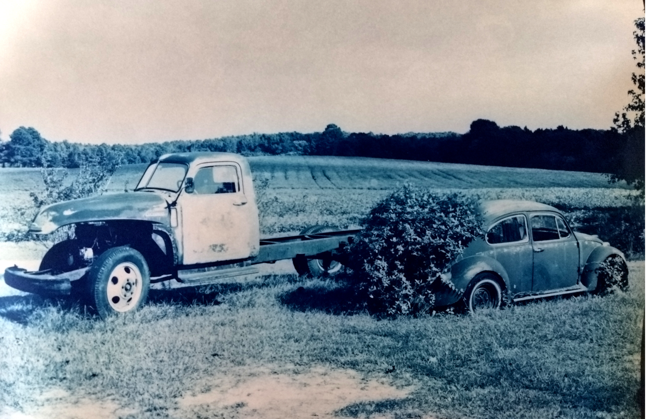

Thought I'd give a report on the 2 types of paper stock i had on hand to try. I made a single 4x5 on ordinary 67llb vellum bristol and it was actually pretty good, considering what a cheap somewhat flimsy paper it is. Surface is kind of rough and the paper doesn't do very well wet. But handled carefully you can get by. 67lb vellum is the paper used on junk mail postage return cards. The I tried 110lb index, thinking it was smoother and a bit heavier and would do a better job. Surprisingly it was TERRIBLE. Didn't even hold up in water as well as the lowly vellum. And as it dried, the image just fades away. After 3 tests, I just threw away the other sheets of that which I had coated. I'm going to coat another 8 1/2 x 11 sheet of the 67lb and make an 8x10 print. So far the backside of old Kodabromide single weight gave the nicest print. Biut it curls up instantly the second you start applying the emulsion with a curl that petrifies curled when dry. I wonder how 80lb cover stock would do. But I don't have any of that.

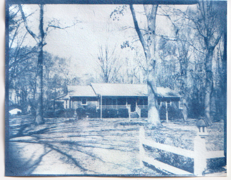

I's been a couple weeks, but it looks like I've about got this cyanotype bit pinned down. Reading your negative and then reading the sunshine for printing by the seat of your pants throws some guesswork and hope into the equation, but looks like I've go it pinned down pretty well. Haven't driven to town to the Hobby Lobby for some watercolor paper, but the backside of all this old Kodabromide seems to work pretty well. Here's a cellphone shot of a print I made today. I don't think I'll ever get used to this blue color. But from what I've studied, you can bleach it and redevelop it to be black (more or less).I haven't seen any process to turn the blue into an actual sepia or brown tone without staining the paper also. Still, not too half bad, for what it is. Although you could probably do the same thing with ordinary silver paper and Edwal blue toner.

That looks good!
There's some posts here on Photrio about toning cyanotypes with a minimum of paper staining. See e.g. here: https://www.photrio.com/forum/threads/on-the-toning-of-cyanotypes.175185/
More or less. It'll look quite similar in any case.
If you don't like the blues, try something like Van Dyke brown. That's an equally easy and quite affordable alt. printing process.
